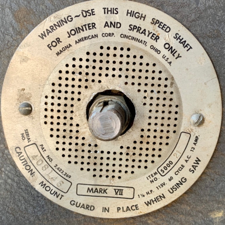

shipwright
Posts: 1165
Re: Working on a Mark VII, with help from this community!
Post by shipwright »
I just found this thread because I’m trying to guess the age of the Mark VII I just picked up. It is remarkably intact but is curiously missing the ID vent plate. I’m guessing that it is a later model because it has all the mods above.
Tie bar on feet… check
Hand wheel table lift …. check
Cam lock table lock …. check
The paint was pebbly
Anybody want to guess the year?
