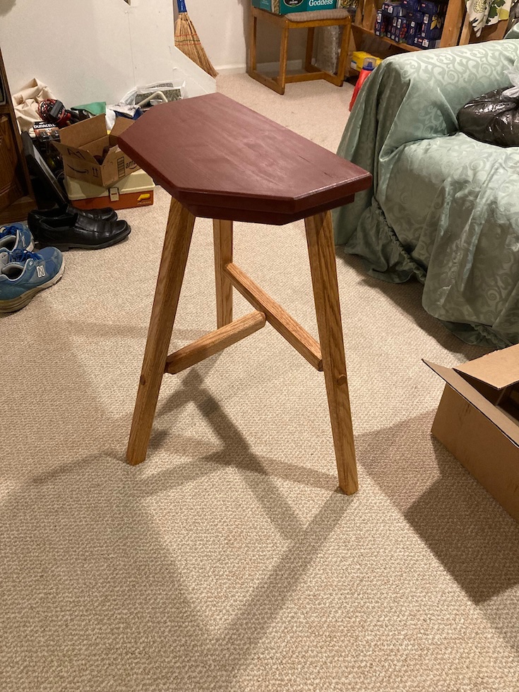

In progress!

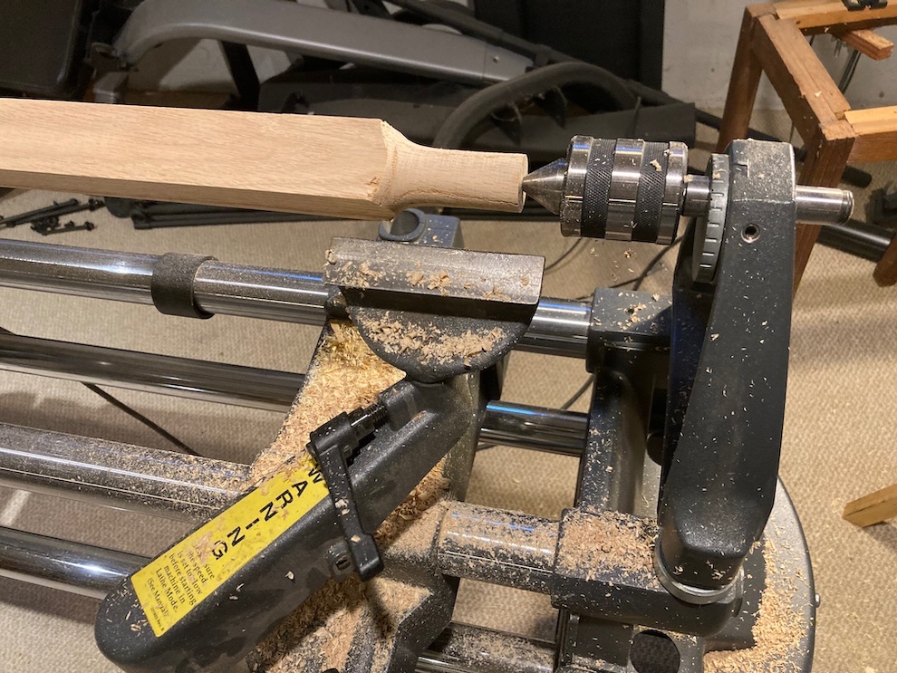

Generally I'm following a plan from Christopher Schwarz's "Anarchist's Design Book", but altering things a bit.

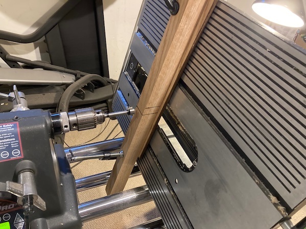

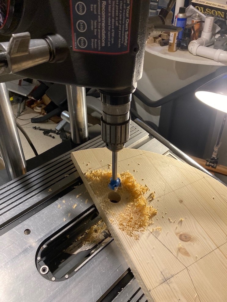

For joinery holes in the legs and rungs, he uses a super-long bit and a steady hand-held electric drill. I, of course, prefer using the Shopsmith's inherent jigging capabilities.
More to follow...

I guess a wixey type thingie came in handy?
nuhobby
Posts: 2359
Location: Indianapolis
Re: Three-leg high chair / stool
Post by nuhobby »
Actually, I used the world's best friction-pivot bevel gauge. That is, the vintage 2007 MITE-R-GAGE that I bought from Shopsmith back in the day :) :)
Posts: 35457
Close enough! :)

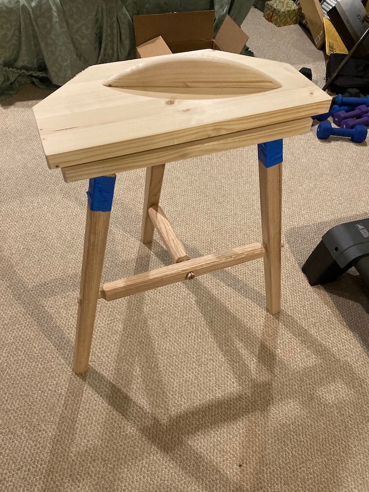

And we're pretty much done, letting the oils and waxes air out a bit.

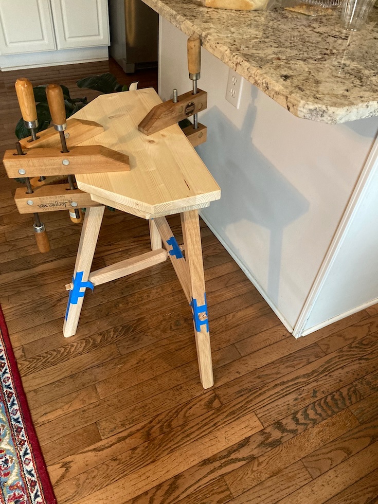

Here was the top-layer getting glued on, and the whole thing being checked for height. The clamps weighed more than the stool!

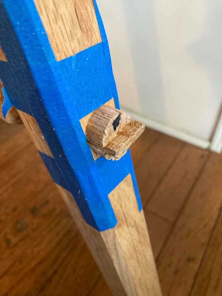

Here's a closeup of a rung-tenon all wedged and glued. Most satisfyingly, when these were later sawed closer to flush, the wedge glue job was 100% intact. The babies were tight!
Here's a bit of paint and oil and wax adding flavor:
Happy Woodworking!
Chris

Turn it around and you have a tv tray with knee space. :D
Seriously good job!

Very nice.

I love the understructure — that’s a nice design and some fine craftsmanship.
Making one of these has been on my bucket list for a while, and my workshop is currently stool-less. But my scrawny butt craves a carved seat bottom. The closer to a tractor seat, the better. Perhaps Roy Underhill would loan me his vintage scorp. :rolleyes:
Or failing that, there’s a clever radial arm saw trick. It’s kind of like milling a cove molding by running a board diagonally over a table saw blade, going progressively deeper with each pass. Except that for the RAS chair-seat trick, you machine the scallops in the seat by unlocking the yoke with the machine powered up, and rotating the whole motor/blade assembly about the vertical axis while the saw blade mills sideways through the wood in an arc. This is a potentially lethal technique, however, as Stumpy Nubs would likely die of a heart attack if he ever witnessed it!

We'll see how it works out for comfort :)
One thing not so easy to see in the pictures, is that the seat does tilt back a tad (per the design). I think that does add a bit of comfort.
If not, then "Mark 2" could come to enhance things :cool:

Really like the design and the execution! Nice job!
