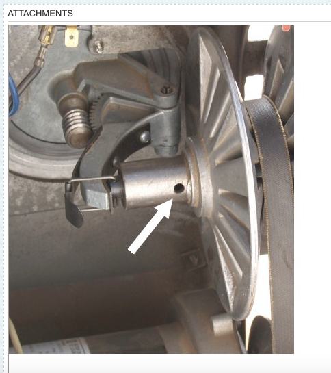

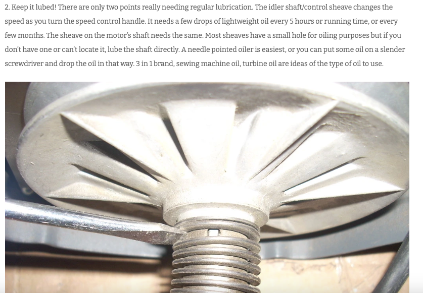

From Jacob Andersons web site:
https://jacobvb.wordpress.com/maintenance-tips/
- Screenshot 2024-02-19 at 7.49.16 PM.png (591.93 KiB) Viewed 3796 times

I believe the phot showing the second lubrication point was taken by dusty
Here is a video showing how to lubricate the Shopsmith
https://www.youtube.com/watch?v=WPOfNdYM8j0
- Screenshot 2024-02-19 at 7.55.40 PM.png (351.45 KiB) Viewed 3795 times

Nope. I do not believe that image was mine. Good shot though. Thanks for posting it again.benmcn wrote: Mon Feb 19, 2024 9:57 pm I believe the phot showing the second lubrication point was taken by dusty

Good information from the posts already made on how to lubricate a Shopsmith Mark 5/V. This may not apply to Shopsmith Clones. As David said the Sheaves on both the Motor Shaft and Idler Shaft can be lubricated without having the holes to put the oil directly into. Not the most desirable way to do it.

Referring to your pictures the first labeled 3.pdf you have circled a hole in the Idler Shaft Eccentric which on a Shopsmith is for a screw to retain the Idler Shaft Bearing and is not an oil hole. In your second picture the oil hole would be on the shaft that the left arrow is pointing to. If fully rotated and no hole is found you can try oiling it as suggested by David or remove the Idler Assembly to oil it and add a oil hole for future maintenance. For the third picture spring.pdf refer to the picture benmcn posted of a Mark 5/V Motor Shaft oil hole location.
If you do decide to add oil holes to the Sheaves of the Motor and Idler Shafts make sure to remove any burrs from drilling on the inside bore of the Sheaves so they will slide smoothly on their shafts. When removing the Sheave from the Motor Shaft care must be taken when removing the spring.
