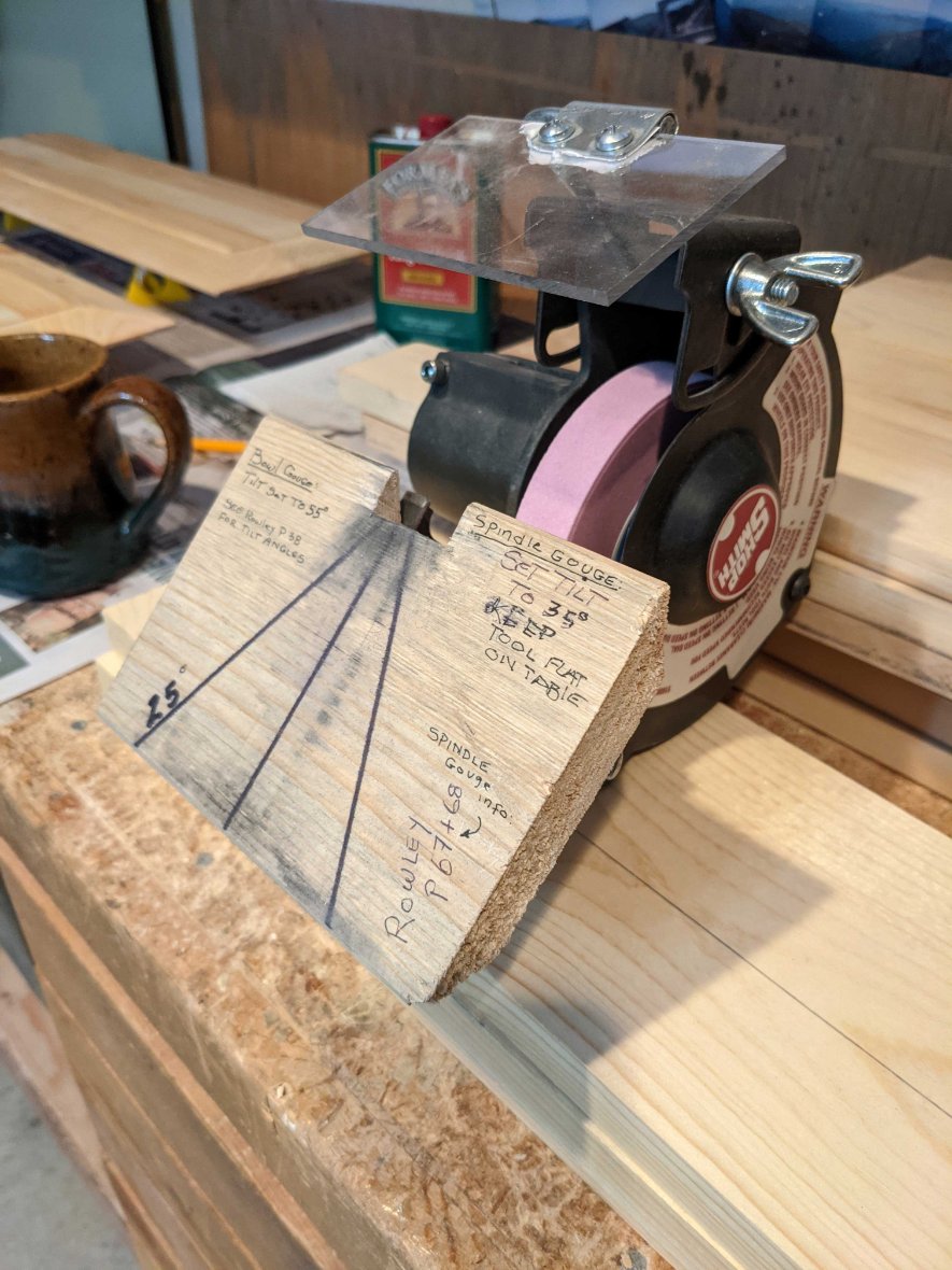

Got to thinking about this old thread this weekend while doing some spindle turning and realizing I need to touch up my spindle gouges. Since I have the Fine Woodworking digital collection, I thought I would do a search to see if anyone had anything to say about free-hand fingernail grinding. Sure enough, on Pages 100 and 102 of Issue 187, there is an article by Mike Mahoney that describes his process. A short article, but well worth finding. No jigs involved, just a grinder. The method is essentially the same as the one Keith Rowley uses, only the angles for the table tilt and the "swing" are both 40 degrees. Hope to get a chance to try it sometime in the next few days.

Sounds like the Stuart Batty 40/40 grind. Very popular grind but hard to do with a jig.

Thanks for pointing me to the 40/40 grind. In the article I mentioned, Mike Mahoney does refer to Stuart Batty. After seeing your post, I looked up Batty and I see he has a lot to offer. I appreciate the link.
