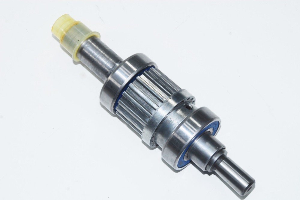

As has already been said the plastic cap on the end of the Drive Sleeve shown below is not necessary for the Mark 5 Gilmer Drive system to function. The first mark 5 Greenies made did not have the plastic cap.
_ .
If you desire to keep your Mark 5 Greenie original, great. Some owners have chosen to upgrade their early Mark 5 (all Greenies and early Goldies) from the Gilmer Drive to the Poly V Drive. That is where all those costs come in. You have to replace the Idler Shaft Sheeve, Drive Sleeve Assembly and the Quill Assembly plus a belt.
_ .

As JPG said, "Think Dust Cap", which is a good description and was added later in the production of the Mark 5 in the 1950's. It's actual function, if I recall correctly, was to reduce noise. As said previously it is not needed for the Mark 5 to function correctly. It can help keep dust out of the splines inside the Drive Sleeve Assembly.
