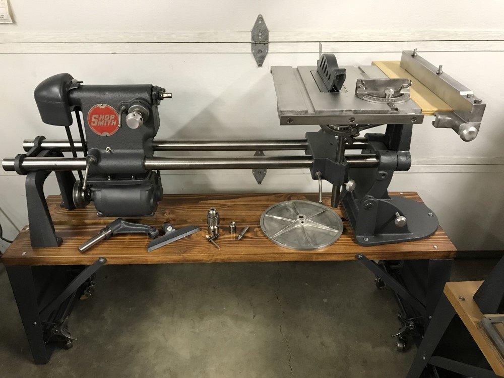

As John said serial number E-3099 would be from 1948 and is a Model 10E made in the Eastern Plant. It should look very similar to the 1947 Model 10E shown in the picture below.
_
1077 Reassemblied.jpg (120.8 KiB) Viewed 5024 times
This one has all the accessories shown that originally came with a Model 10E except a 5/8" Arbor plus it is on a bench (not included with the tool at purchase) that has the Metal Bench Ends and Retractable Casters that came out later. Pictures of your Shopsmith and accessories will help us better identify what you have.
Shopsmith Model 10's, even considering their age, are still very good woodworking tools. To date I have restored 9 Model 10E tools (including the one above) and 15 Model 10ER tools as a hobby and have resold 21 of them. I have kept the other 3. These are very well-built tools that with care seem to last forever. As John has already said
Value is going to be based on what original and add-on accessories the machine has, and of course condition!
