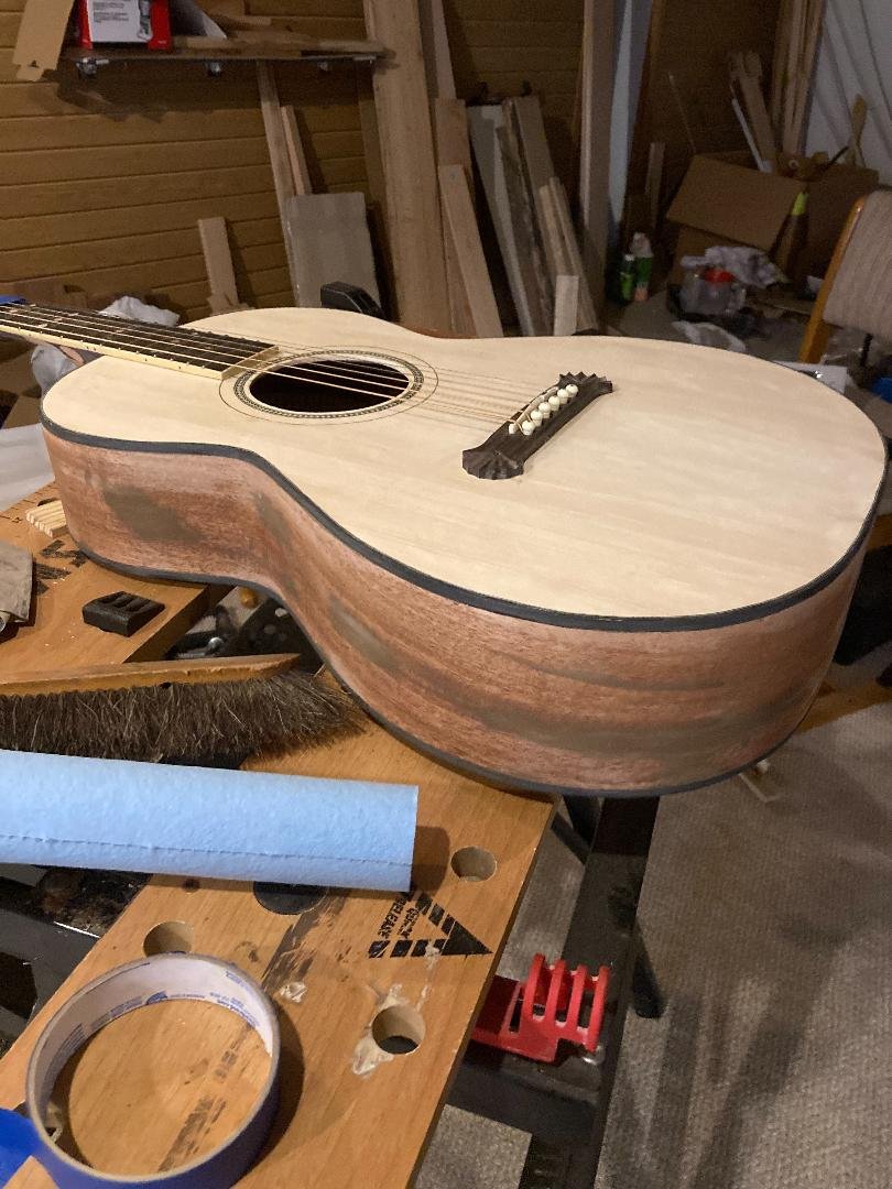

Well, I'm finishing up my Covid isolation, and ready to quit thinking about this guitar for a while, too...

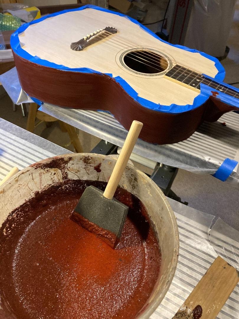

The mahogany sides I had bought were a bunch of trouble, splitting and driving me up the wall.
I decided to "mud 'em", to even up the surfaces:
Sides Mud.jpg (141.4 KiB) Viewed 10952 times
Then I made up some dark red milk paint from powders I had on hand:
Sides Milk Paint.jpg (186.99 KiB) Viewed 10952 times

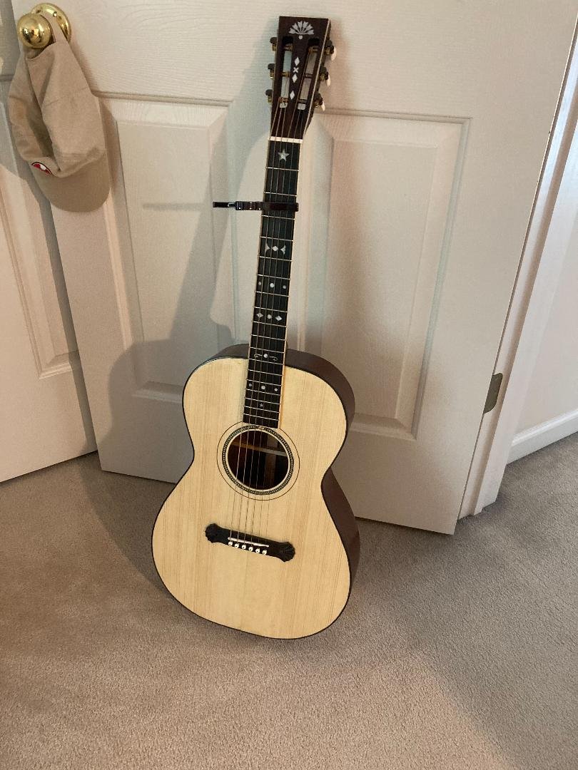

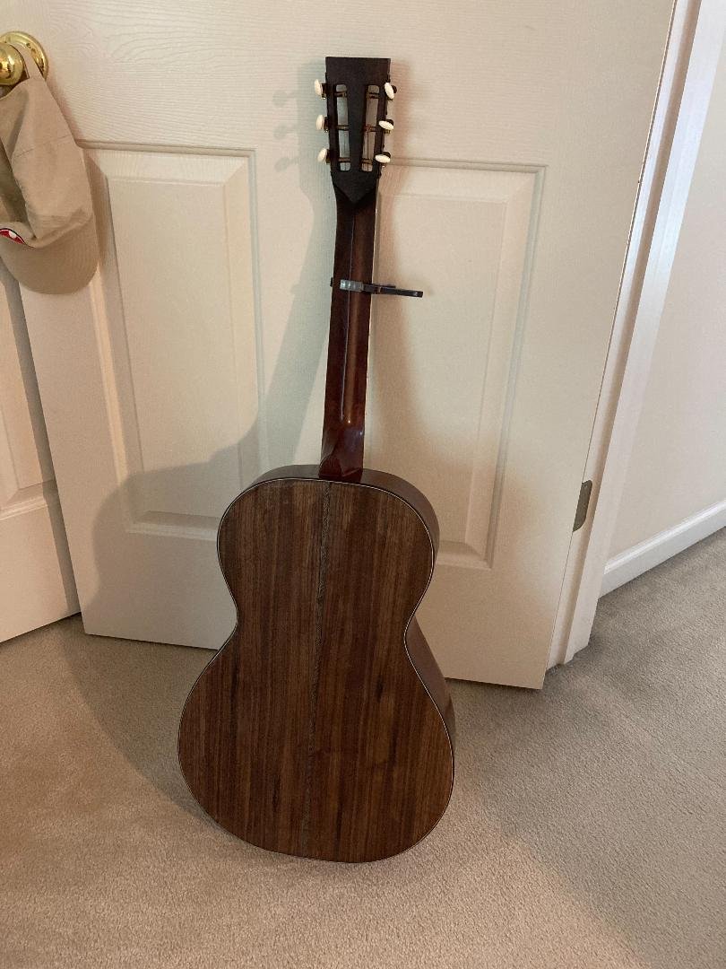

Later I had oiled all over the thing, and it's to the point I don't want to see it for a while, but at least it works (if not being a stage gloss piece):
Assembled Guitar.jpg (142.41 KiB) Viewed 10952 times
Back Assembled Guitar.jpg (124.63 KiB) Viewed 10952 times

Ouch -- sorry to hear about your troubles with the mahogony sides, Chris. Overall though, it's some really impressive craftsmanship.
This may be a dumb question, as I know nothing about lutherie, but are the sides generally steam-bent? In the first post, you said that you bought curved side pieces from a kit maker. So I assume that they were already formed roughly to the shape you needed?
nuhobby
Posts: 2359
Location: Indianapolis
Re: Guitar Resto-Mod underway
Post by nuhobby »
Hi Dennis,
You're right, kits will usually have the sides pre-bent. I think premium kits like Stew-Mac's must have great components. I actually spent less than half that amount from an auction seller. So the mahogany sides I got were pre-bent, but they'd already started "rebounding" (curves springing back to larger radii) when I received them. I'm not sure how much of that was the cheapness of the mahogany versus the rigor of the bender/ seller. Anyway, as it turned out I messed with some heat and water -- and a hand-saw -- and I got my "OOO" sides down to more of a "OO" size that I lashed to the end blocks. It was a learning experience. :)

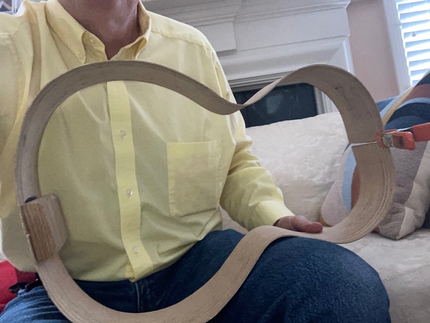

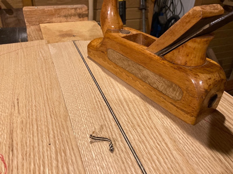

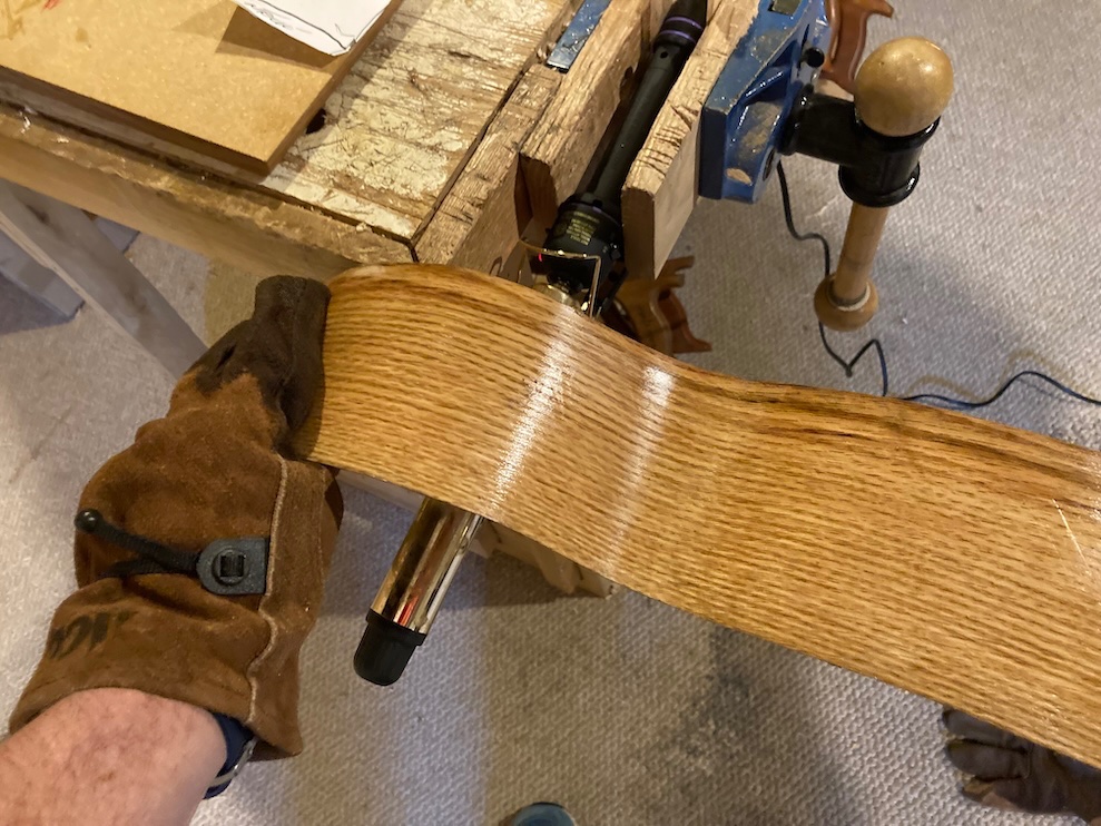

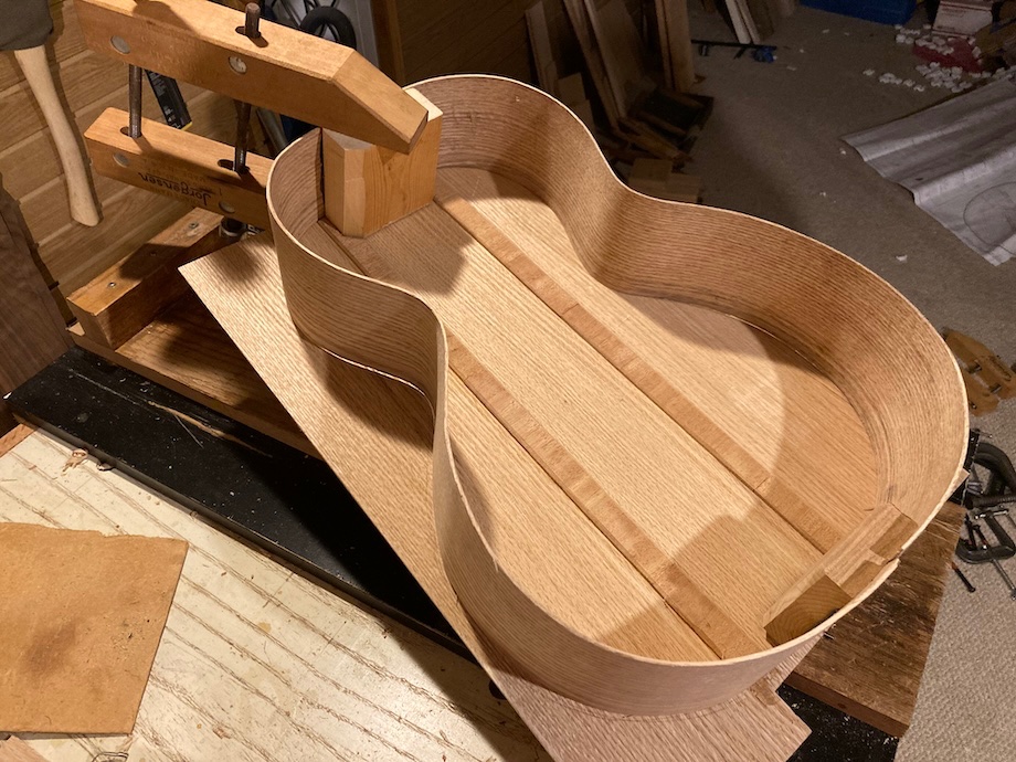

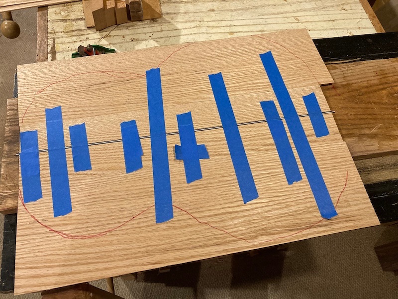

Well, 2 years later -- I've liked that resto-mod, but I got the itch to make a guitar from scratch.
Some random points of progress (red oak rift sawn wood for the sides and back)....
Posts: 3802
The photo with the plane is absolutely gorgeous. Did you make the plane?
