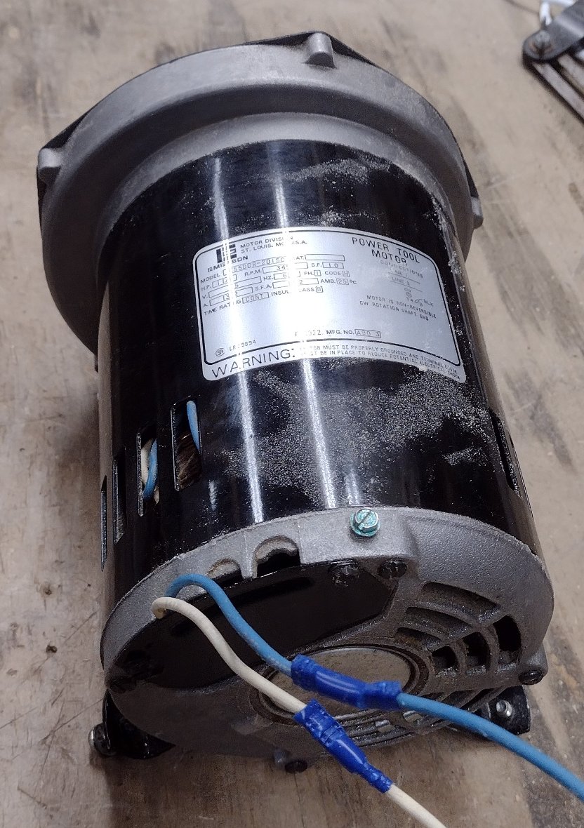

I just bought a replacement 1-1/8 HP Emerson motor from eBay to replace my existing one. I noted that there was no capacitor mounted to outside of my motor like my original motor. The eBay vendor couldn't tell me 1) if there's a start-up capacitor built inside the motor's casing or 2) whether these motors even require a start-up capacitor or not. He said he's never seen one with it.
Do you know if a capacitor is required to successfully start this motor? I've not hooked it up yet with fears of damaging something at startup.
My new Emerson motor model # is either C550DR15C or C55DDR15C (it is hard to distinguish the 4th character on name plate). See attached photo.
I attach photos of:
  • my original motor (showing external capacitor hump)
  • my new Emerson motor (w no external capacitor hump)
  • nameplate from new motor

The start capacitor for the Emerson is internal to the case. IIRC you can see it through the vents in the non-shaft end cap. From your post I could not tell if you were planning to use the bored out sheaves on this, I don't that is ideal.

I am NOT reusing my bored-out sheaves. The new motor came with a pair of sheaves already pre-mounted on the shaft.
I will check out the "peep holes" to find capacitor tomorrow.
Usually these motor capacitors are pretty big (see photo of outside of my old motor.) I don't know how they pack such a large component into that casing.

I DO see the capacitor inside the motor's casing. Tx.

I've been told that it was a start capacitor, but it doesn't really matter since David clarified (and I confirmed visually) that new Emerson motors have the needed capacitor built-inside the motor's casing.
