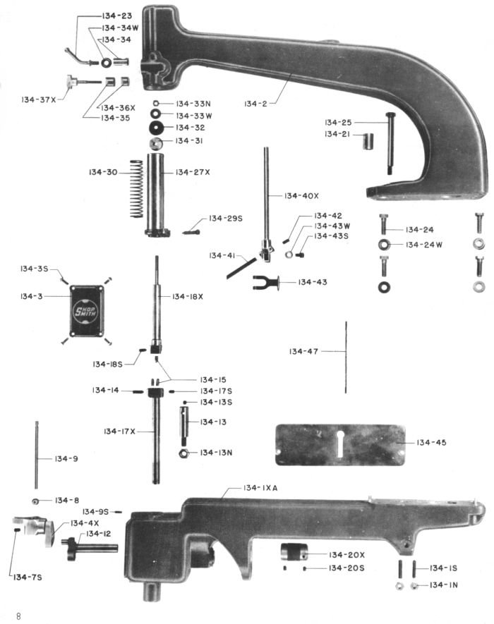

Hey guys, another new SS owner here. I have the A-34 jigsaw and I’m in search of a very specific part before I try to make it. I need the hold down screw and nut piece for the blade guide. I don’t know if anyone has one or knows where to find one. It looks like I might be able to make it out of aluminum round stock but I can’t seem to find any of that laying around either. Part numbers are what look like 134-34 and 134-23. Any help is appreciated.
Skip @ MKC Tools can make one for you, he is out of stock last time I spoke with him and he was going to make some up but that was last summer.... Sooo maybe I need to reach out again
Skip is a great guy https://www.mkctools.com/
Those parts, 134-34 and 134-23, are very specific to the very old Jig Saw made for the Model 10E and 10ER. The Washer P/N 134-34W is pretty common hardware. Unless you or someone can make them for you, you would have to find them on the used market. Parts for these old Model A-34 Jig Saws do come up for sale occasionally. I have restored 10 of the Model A-34 Jig Saws and finding parts for them required some patience. In a couple cases I had to be creative, like making a replacement Leather Pump Seal. Another was missing the Sabre Saw Support (134-13) which I was able to make a decent replacement but later found an actual one for sale.
All SPT's & 2 Power Stations
Thanks Russ. I was afraid of them being hard to come by. I have a few ideas and I have the ability to make it myself given the material. I just need to find the right stuff in the mess that is my garage. I was just hoping someone had one so I wouldn’t have to put the work in.
