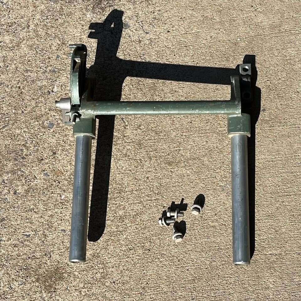

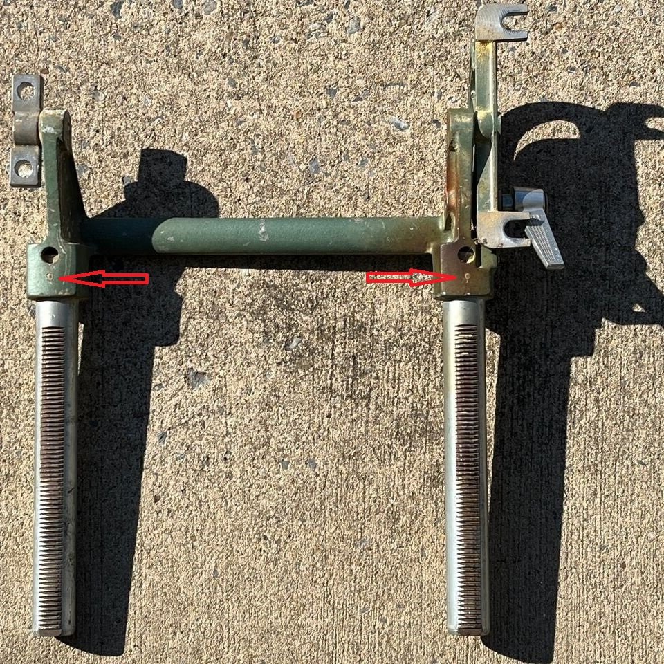

As you can see JPG was referring to changing just the Bench Tubes from the original 1-7/8" diameter to the 1-3/4" diameter tubes but still using the original Bench Ends (Base/Arm and Headrest ends). Since you are changing to the Double Tilt Bench Ends, which cannot use the old 1-7/8" Bench Tubes and the reason for changing Bench Tubes your biggest challenge with be the Table posts.
With so many changes to the Mark 5/V over the years it is easy to get one thing stuck in your head when trying to help. I know I have done it too.
JPG wrote: Mon Apr 22, 2024 10:15 pm
The shims are placed against the SIDES of the tubes. The tube clamp exerts outward pressure to the tubes. The final position is determined by a small boss extending out from the outer interior surface of the end casting. The shims essentially make that boss longer. The shims are necessary since his greenie end castings have a boss 1/16" shorter than current production. The end result is the same c-c spacing. Key word there is CENTER.
OK got it. I was thinking length not side shims. He is going to double tilt(new end castings) so no shims just new bench tubes.
c-c was the clue
