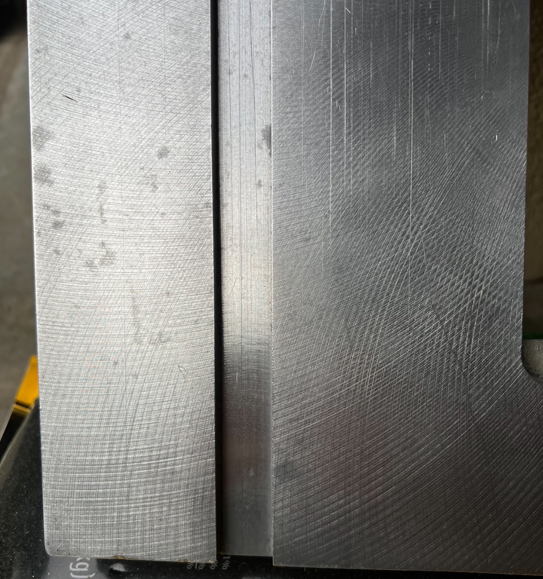

I restore a lot of the oldest Shopsmith machines, and even after extensive buffing and polishing, sometimes I just have to live with those stains. This is from an early Shopsmith Model 10E - still shows a vivid pattern of the original surfacing machining, but I could never get those stains out!
