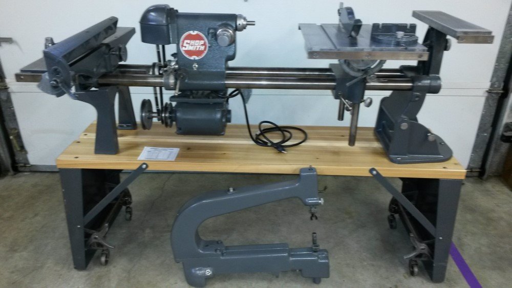

I keep a laminated copy of that chart for reference on the bench of my Model 10ER as shown below.
_
R64000 with Jointer and Jigsaw.jpg (88.57 KiB) Viewed 712 times
For anyone wondering, that extra 5" pulley on the end of the motor shaft is for the Jointer.
