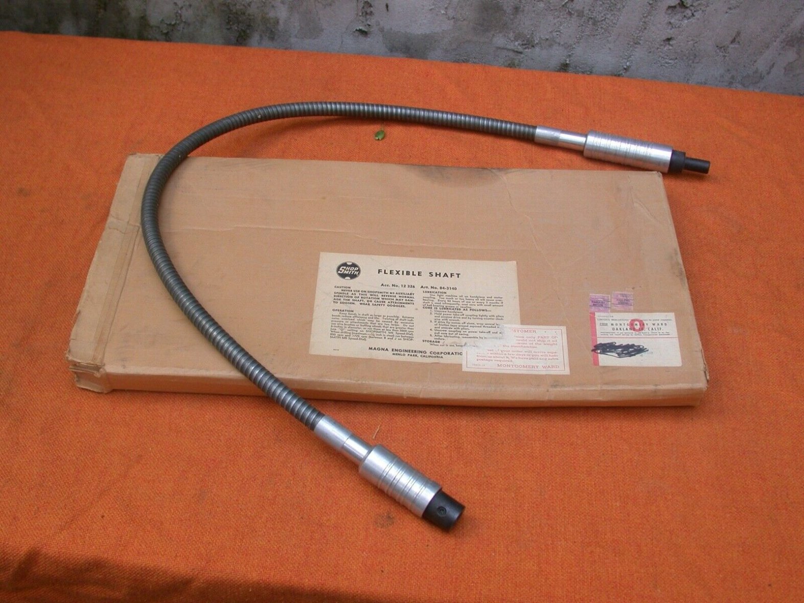

I purchased a flexible shaft off ebay, seems to work just fine. Lets not get into 'safety' issues - the flexible shaft is as safe as any other woodworking tool, and isn't designed for high speed applications (I will use it mostly for sanding with the drum sander attachment)… my question is maintenance. Does anybody have the instruction manual? I see there is a spot oiler point (I think, there is a ball detent), and I'm wondering if I should strip it down for maintenance and inspection and would love more information from anyone who might have done this. You just don't know what the condition is of a tool purchased off ebay….

My question is also on lubrication. Too bad this six-year-old question was never answered in this thread. I have my grandfather's 1950's vintage flexible shaft (still has the Montgomery Ward price tag attached - $10.50!). I also have his 1955 Montgomery Ward tool catalog that includes the Shopsmith.
What I don't have are any instructions on maintenance/lubrication of the shaft. It started to bind up just now after about an hour of use (cumulative). First time I ever used it, so I suspect it needs lubrication.
I'll keep looking, but if anyone sees this thread and has an answer, please help. Thanks!

Look for a 'bump' with a spherical raised center(top third of a ball bearing) See if the raised center can be depressed. If so put some oil in it. #10 oughta do.

Below are the only instructions I have for the Shopsmith Flexible Shaft. They came attached to the box.
_
12 326 84-3140 Flexable Shaft Instructions.jpeg (371.89 KiB) Viewed 10699 times
Below is a picture of the Shopsmith Flexable Shaft on that box for reference.
_
12 326 Flexible Shaft w- box.jpg (308.3 KiB) Viewed 10699 times
Do take note of the additional core lubrication not mentioned by JPG. Also check that your Flexible Shaft is the Shopsmith one as pictured above. There were other Flexible Shafts made by other companies that differ from the Shopsmith one having a threaded shaft end to attach items to while the Shopsmith Flexible Shaft has the same end as the spindle. These Flexible Shafts made by other companies generally had a 1/2" bore and required the Shopsmith Flexible Shaft Adapter show in the picture on the 1st page of this topic.
