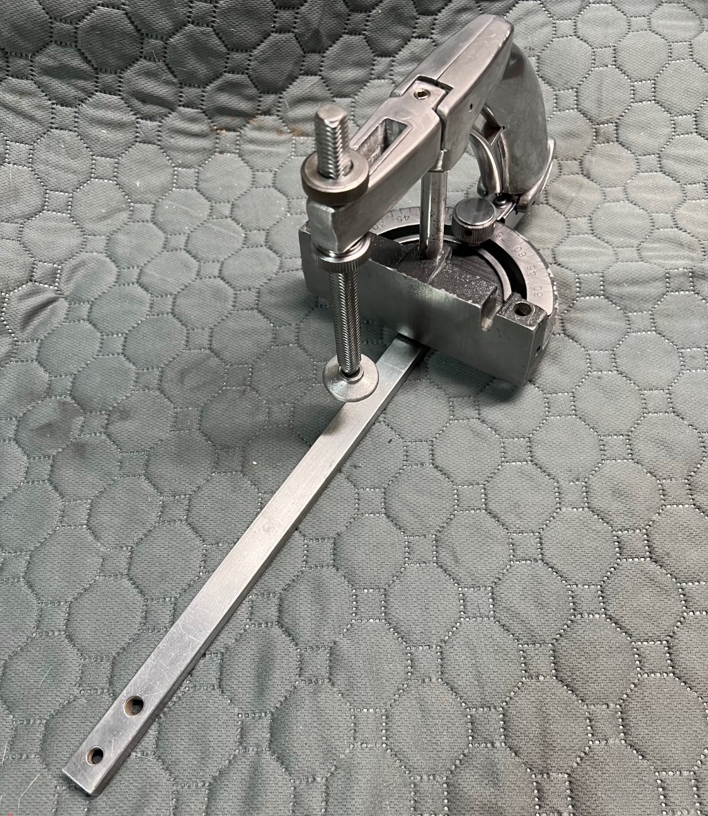

Cleaned up this Miter Gauge I recently acquired. It was understandably a bit grimy when I got it, paint is a bit rough, and the miter grip accessory needed a few parts (which I had) - but it cleaned up well. And besides the unusual miter bar (
anyone spy the missing feature??), it looks like a normal Mark 5 miter gauge.

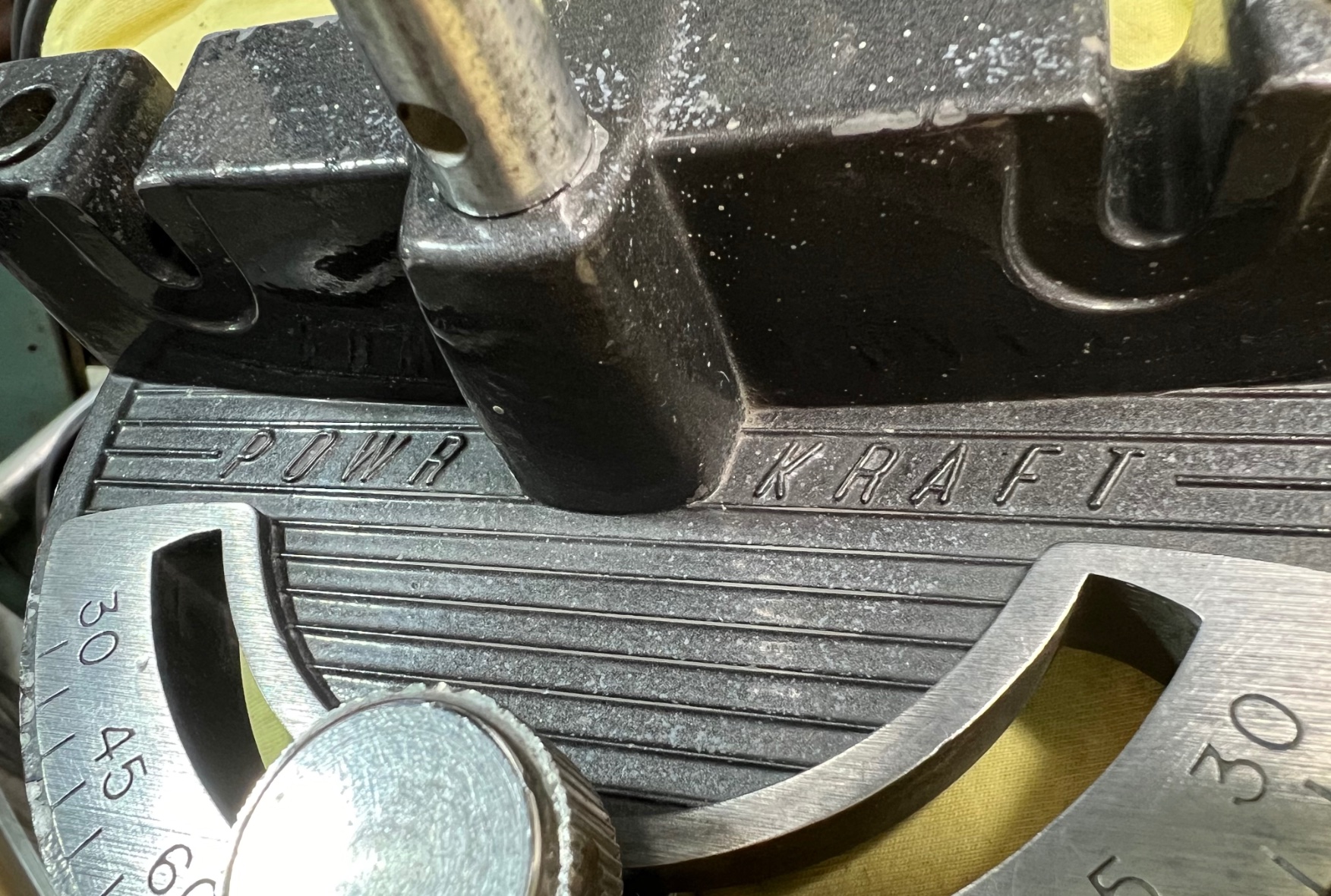

If these things actually existed, I wanted to see one! And it didn’t take long for one to pop up on eBay, and now it’s in the collection…
- IMG_4272.jpeg (734.42 KiB) Viewed 23546 times
Yup, it’s a legit miter gauge for a Powr-Kraft table saw, manufactured by Magna! It has the same beefier miter bar dimensions of a similar miter gauge on my Magna-Line table saw, and is similarly missing the spreader slot of the Mark 5 miter (see first picture).

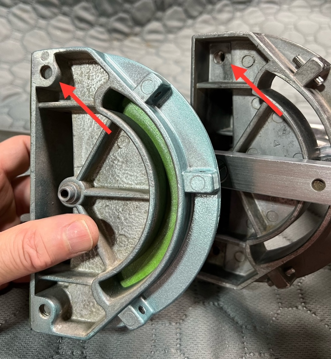

As a final note, I always find it interesting to see what sort of things might have changed when modifications of this sort were created to familiar Shopsmith accessories. This one is a bit of a head-scratcher…
- IMG_4279.jpeg (480.52 KiB) Viewed 23546 times
They actually removed some material from the casting that would have accommodated the nylon standoffs that prevent scratching the table surface. That’s some serious penny-pinching!
