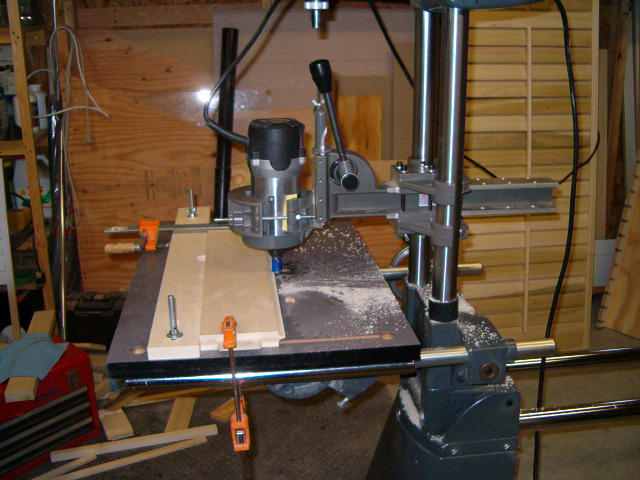

Hi, W.D! When searching for the post where I had answered this question earlier for another member. I found this - http://www.shopsmith.net/forums/showpos ... ostcount=4 Just about the same question and this is the answer I gave then.
However, now Ive had a change of mind. (and I'm still too frugal to buy a 'Lift Assist') I find with the headstock moved all the way over to the left, against the tie bar, it is too awkward and also heavy to lift, without a grunt or two. Now here is the setup I use every time, with the headstock 7 or 8 inches to the right of the tie bar. This position gives me room to get a hand hold on the way tubes making for an easy grip. Also the weight of the headstock is closer to the fulcrum, making the lift lighter.http://www.shopsmith.net/forums/showpos ... ostcount=1
Here is a repeat of that photo showing this setup, with a little more explanation. You can see the headstock spindle at the top of the pix.
(don't be alarmed that the workpiece is clamped to the table and the wood fence is on the back side of the workpiece. I was about to move the entire table toward the way tubes to mill a cross dado. This photo was taken prior to making a sliding table)
Another note - don't drill holes, like I did on the way tube side of the table. I've filled these from the bottom, but the holes are wrong!!!!:o

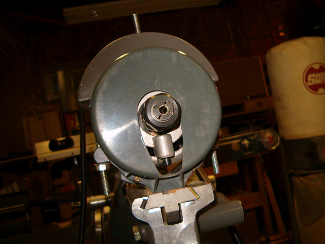

There will be no shortage of suggestions, when you ask what brand and size of router to buy. I'll tell you what I have, and I have been very satisfied with it. It is a Porter Cable 890 series.wdelliott wrote:Thanks Chuck on placement.
What router are you using in the OPR? I'm trying to decide whether to obtain another router for this purpose. I'm thinking of obtaining one with sufficient power for a 1/2 inch collett. Any suggestions?
It works, is not too noisy. is not underpowered for my work, on/off switch just takes a slap to turn off (or if the router is free, just set it on its top and it will shut down) and will has two collets for both 1/2" and 1/4" bits, easy to find parts and accessories and best of all, it has a one wrench change and a spindle lock that turns locks off the power when in use. (see black button in photo)
In order to fit it to the OPR so I could use the spindle lock, I had to do a modification to the dust guard. (photo attached) I mount the router so the power cord is coming out toward the front and the spindle lock is toward the rear.
We might think that the power cord coming out toward the operator would be a problem, but it is not. The router has a very long cord and it easily fits up over the headstock or way tube tie bar and there's still room to reach an outlet.
P.S. My L.O.M.L. bought me the 893 so now it is the only router in my shop. The fixed base is mounted to my router table and the plunge base is for free use (which has not been used).
