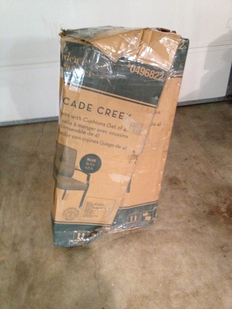

I don't think you are going overboard but it may not need all of your considerations for packing. My first Bandsaw was one I bought on ebay. Because it was damaged during shipment and thankfully it was insured, I got my money back and even got to keep the damaged Bandsaw. So here is what happened to it. It was packaged as shown below still completely assembled. That included the Mounting Posts still in place.
_
Not a very good packing job.

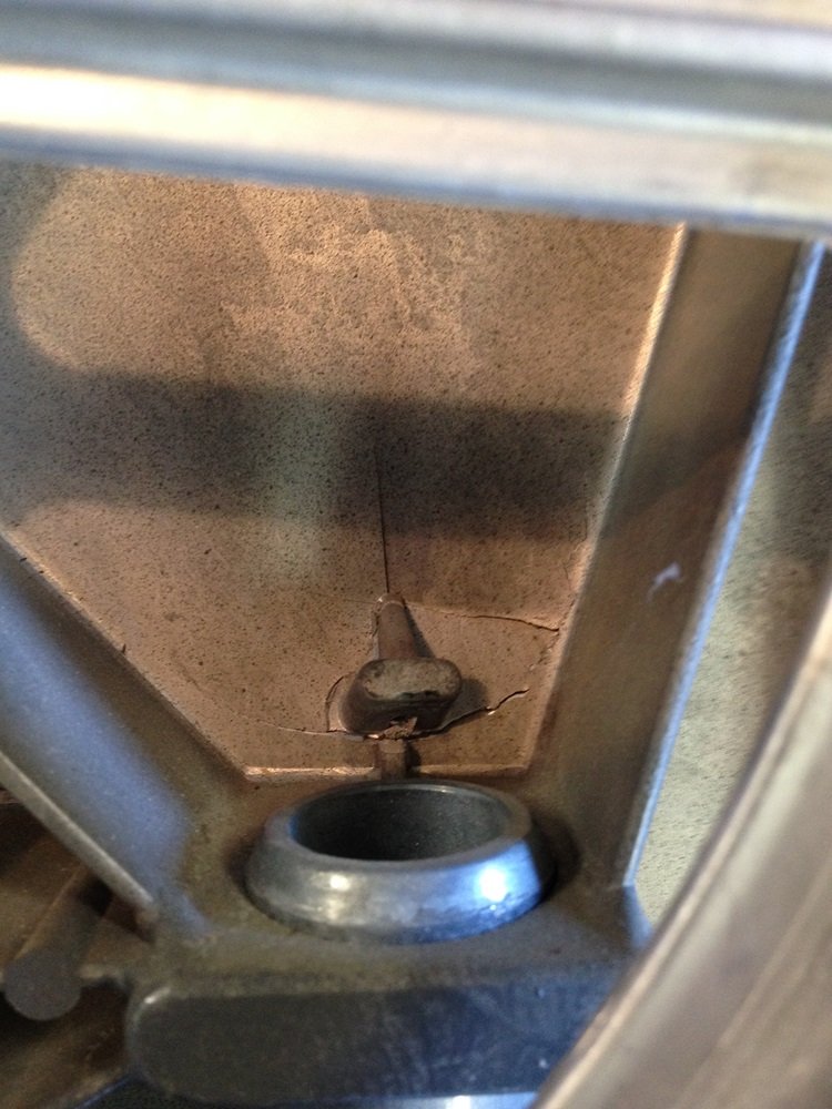

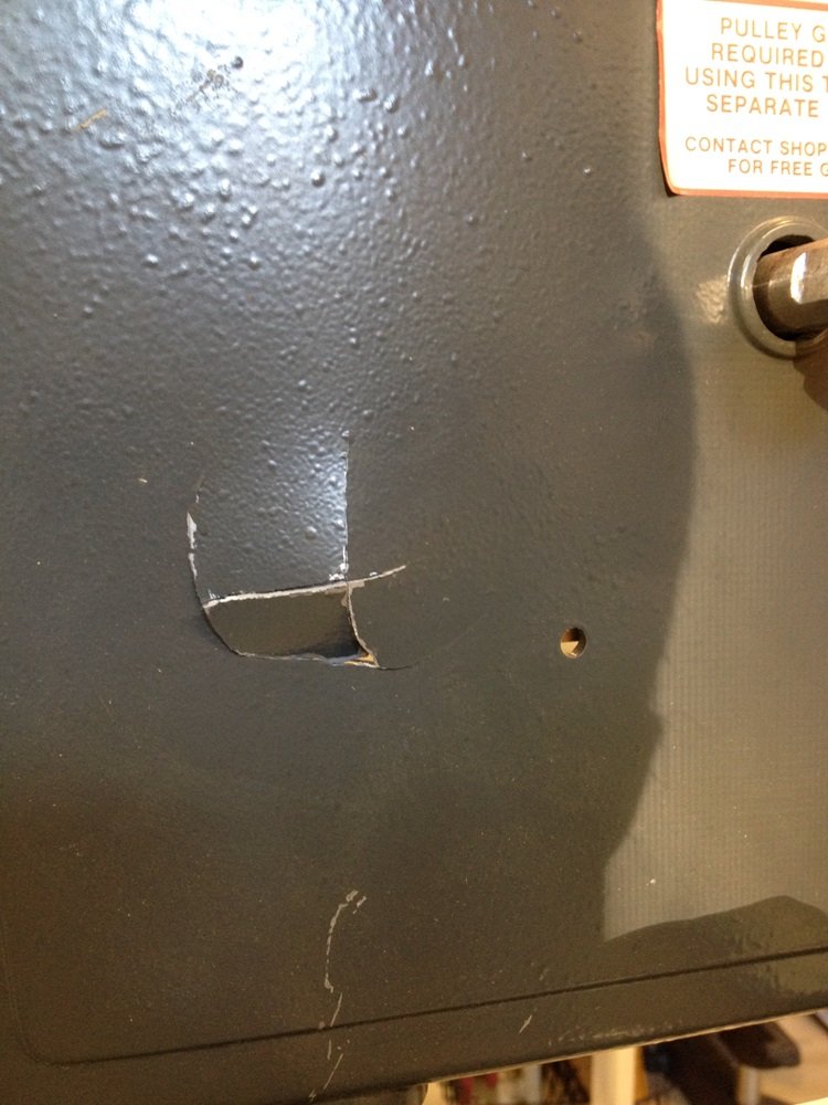

At some point it was dropped during shipment driving one Mounting Post up into the stop. This caused the damage to the Main Frame as shown below.
_
damage inside.jpg (120.02 KiB) Viewed 8721 times
_
damage outside.jpg (109.32 KiB) Viewed 8721 times
I replaced the Main Frame and now have a nice Bandsaw which has been my primary one since it's repair. The other two Bandsaws I have purchased that were shipped to me arrived well packaged with no damage.
