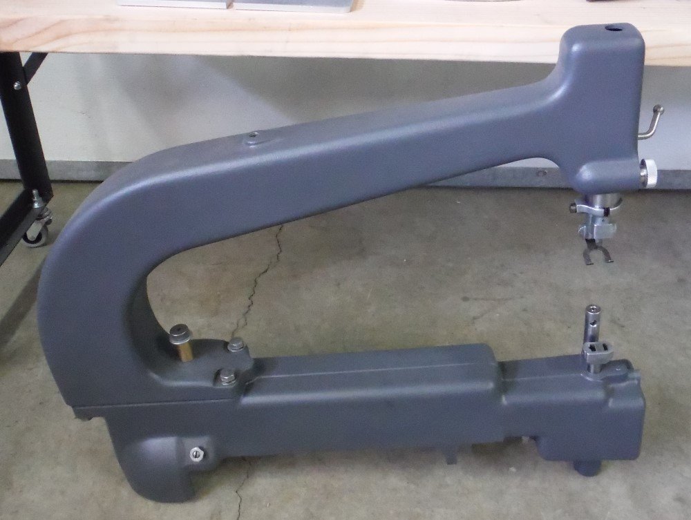

A little more clarification may be needed here. First which Shopsmith Jig Saw are we talking about? The first was made for the Shopsmith Model 10E and 10ER. It is different from the one made beginning in 1954. Below is a Model A-34 Jig Saw made for the Model 10's.
_
Jig Saw V2.jpg (99.66 KiB) Viewed 980 times
The one pictured above is the later version and differs from the first version in the Lower Frame casting.

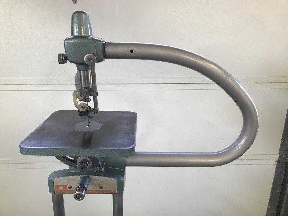

The Jig Saw pictured below is the Model 610 and later changed the model's name to 505644.

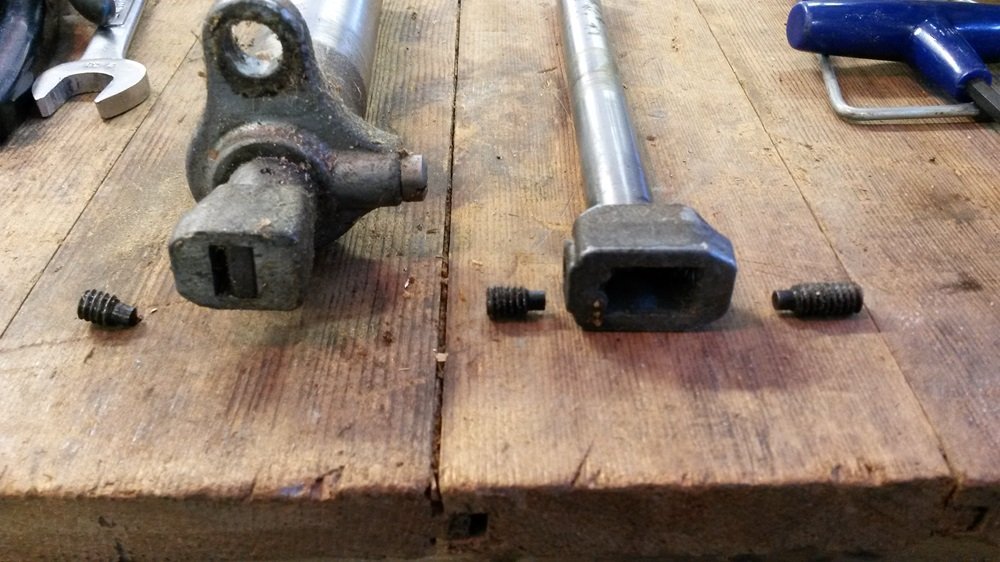

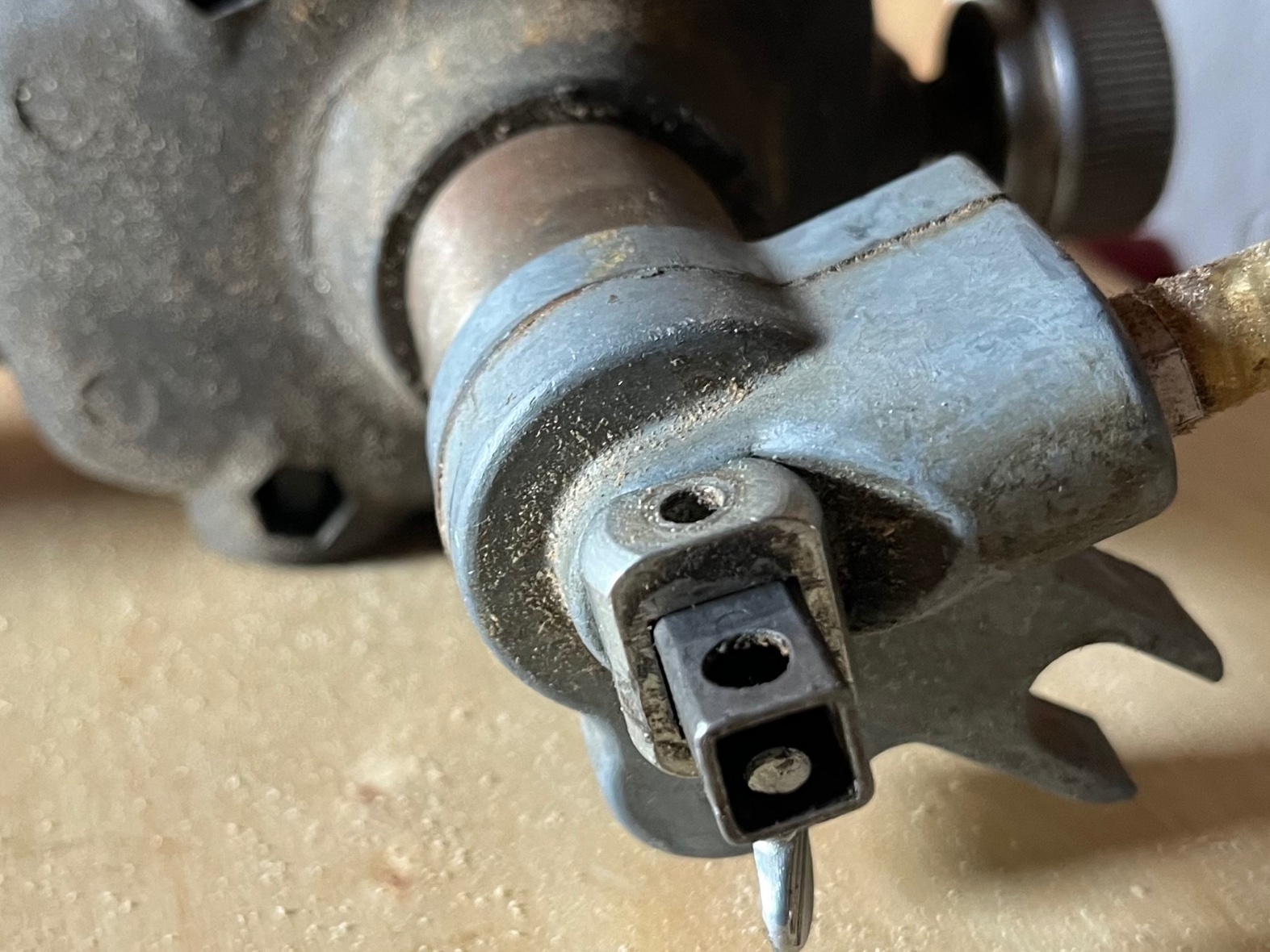

I have the newer one. But my upper chuck thingy doesn’t look like those.

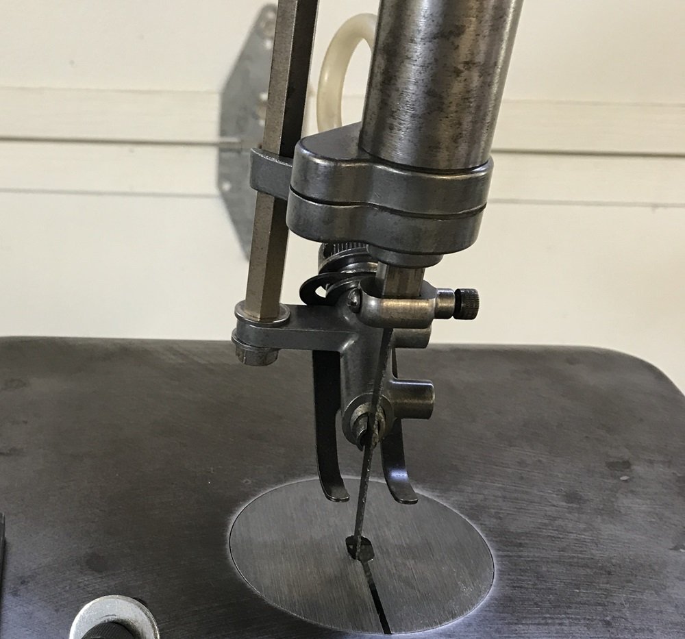

Below is a picture of the Upper Chuck from a Model 620 Greenie Jig Saw.

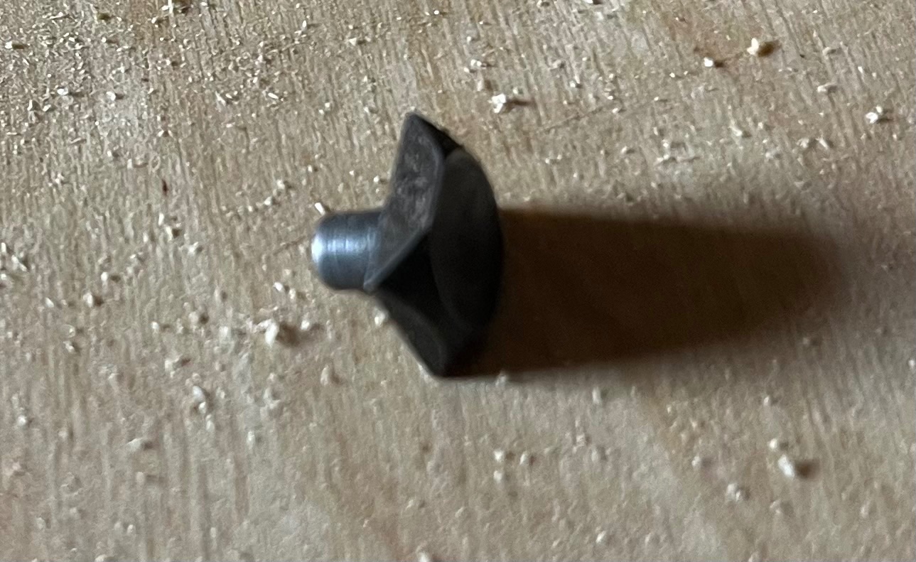

The Upper Chuck collar on yours is missing the screws and goes over the holes in the end of the square tube. I believe the other picture you posted shows one of the two jaws that go inside the end of the square tube, but I don't have a size reference to compare it to. The jaws are held in place in the inside end of the square tube and the screws on either side of the Upper Chuck collar hold it in place plus lock the jaws against the blade.
The slotted head screw is a 6-40 x 5/16" Round Head Screw. The other screw is a 10-32 x 3/8" Socket Cap Screw. The screw information is from an early Shopsmith Inc. diagram and parts list from the 1970's. I would have to check if those screw sizes changed later but I doubt it.
Only the Socket Cap Screw is used to lock the blade in the Upper Chuck. The Slotted Round Head Screw should always be kept tight.
None of those Upper Chuck parts are available from Shopsmith any longer so parts will have to be found used.
