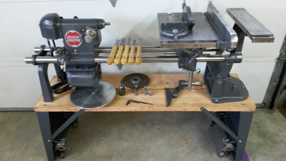

In the other thread you saw a picture of a restored Model 10E which would be like yours but with the original wood Extension Table. Below is a picture of a restored Model 10ER which would be like yours. It includes the Speed Changer, Lathe Chisels and a wobble Dado Saw Blade not included as they came from the factory.
