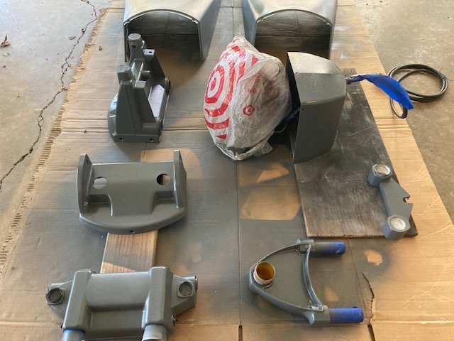

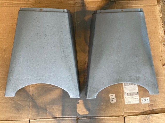

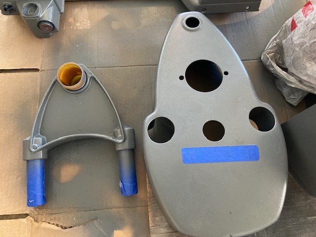

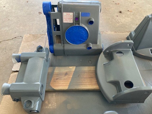

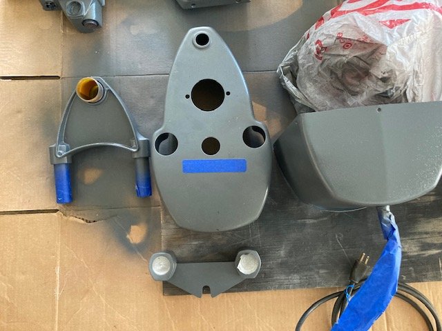

A quick progress update:
Weather cleared this afternoon and gave me an opportunity to paint some of the parts. The SS touch-up paint does appear a little glossier, like others on the forum have already pointed out but I think the color is spot on. I may just let it ride like that or I could but a clear matte coat to dull it down some when all is said and done.
- Leg painted in SS Touch-up paint on the right. Leg on the left is painted in Rustoleum primer
- Paint 1.jpg (54.69 KiB) Viewed 1957 times
- overview of painted parts
- Paint 2.jpg (67.8 KiB) Viewed 1956 times
- belt cover in original paint next to parts in SS touch-up paint
- Paint 3.jpg (63.59 KiB) Viewed 1956 times
- Headstock in original paint next to parts in SS touch-up paint
- Paint 4.jpg (60.58 KiB) Viewed 1956 times
- Close-up of original paint on belt cover beside parts painted in SS touch-up paint
- Paint 5.jpg (57.25 KiB) Viewed 1956 times

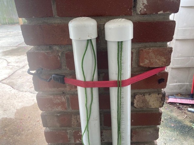

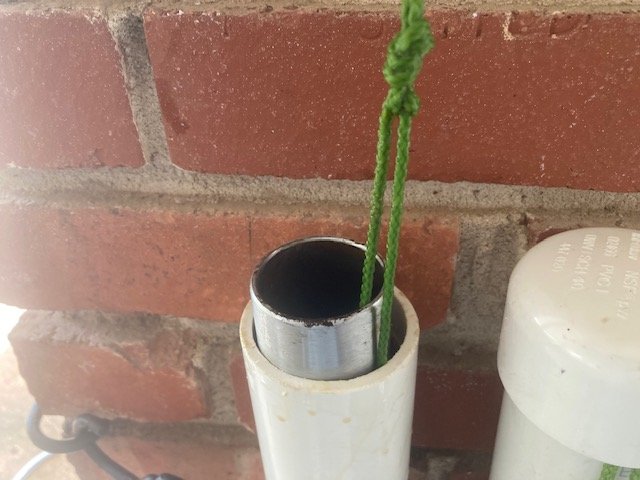

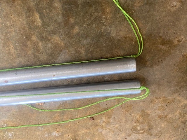

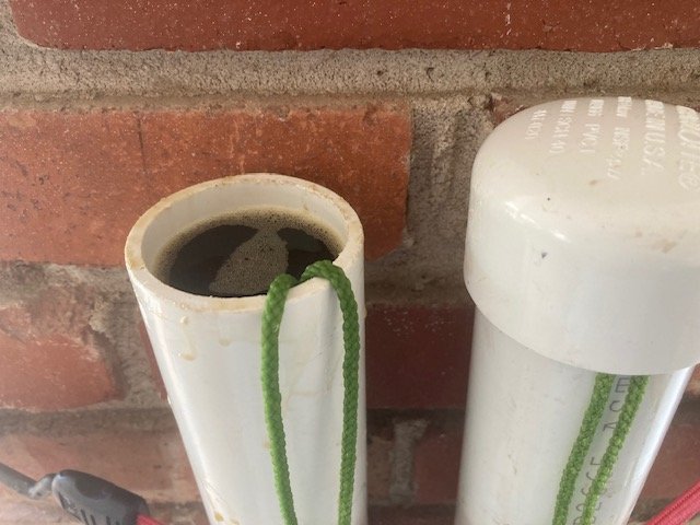

I also made up two 2" PVC pipes to hold some Evapo-rust solution to soak way and support tubes. This was mainly to address rust inside the tubes as the outside surface of the tubes were in pretty good condition. There is some degree of pitting on the outside surface of the support and way tubes but I'm not expecting the Evapo-rust to have any effect there
The green string you see in the pictures is just a way to retrieve the tubes out of the pipes without spilling the Evapo-rust in the process.
- PVC Pipe 2.jpg (58.18 KiB) Viewed 1953 times
- PVC Pipe 3.jpg (56.25 KiB) Viewed 1953 times
- PVC Pipe.jpg (63.62 KiB) Viewed 1953 times
- PVC Pipe 5.jpg (72.27 KiB) Viewed 1946 times

GetterDone
- Posts: 405
- Joined: Sat Jul 20, 2024 3:45 pm
- Location: TN
Re: Dad's 1982 Shopsmith Mark V Repair/Restoration Project
Great idea about the string.
I love that Evapo-Rust .
Dwayne
