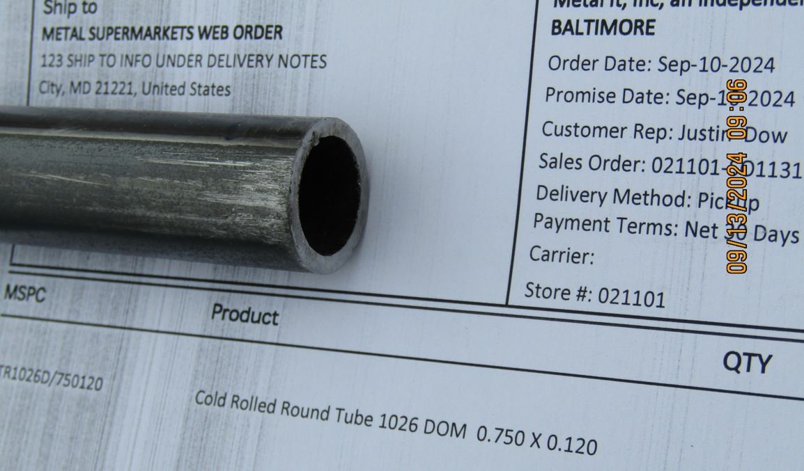

By popular demand, we have replaced the wood dowel column-legs with steel tube legs.
First looked at using Schedule 40 steel plumbing pipe but chose tube because I wanted the .750 OD of the original dowel - to avoid having to re-drill the platform.
Bought the steel tubing from Metals Supermarkets. Be carful in ordering - they have numerous combinations of alloy and wall thickness; some combinations are cheap and readily available, and others are "special order" and/or expensive - inquire before purchase. For my application, any mild steel would be OK. So I ordered the cheapest "cold rolled round tube, 1026 DOM," size .750" OD X .120" wall.
Should have called them first. What I got was not .750" OD but rather .850" OD. I thought that if a tubing product was "DOM" then the OD would be accurate, but apparently I was mistaken. Maybe another ($$) grade is more accurate. Anyway, had to re-drill the platform to 7/8" DIA to accommodate. I should not have assumed.
Made a few additional beef-ups on the platform and now it is really rigid. Also increased the length of the wooden-post feet, which shortens the effective length of the tube-columns. The vise-grips hold the steel tube well.
Sooner or later the bare tubes will rust but if I paint them, the vise-grips would just tear up the paint. Would like to find a non-paint finish - something easier than gun-bluing or phosphate.

I am a big Fan of your Project and Even more I Really like DOM Tube.SteveMaryland wrote: ↑Mon Sep 16, 2024 2:09 pm By popular demand, we have replaced the wood dowel column-legs with steel tube legs.

My metal supplier(Metals Depot) specifies OD x WALL x ID x LENGTH
They be about 1/2 the local metals market prices.
