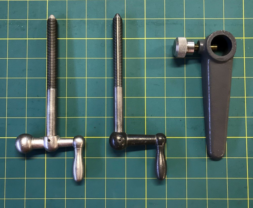

The picture below shows the common Table Raising parts. There were two crank versions and the Arm JPG mentioned is shown too. The arm goes on the front Main Table Post. It is shown in place on page 6 of the Owner's Guide.
_
- Table Raising Assembly 142-1X.jpg (148 KiB) Viewed 9058 times
