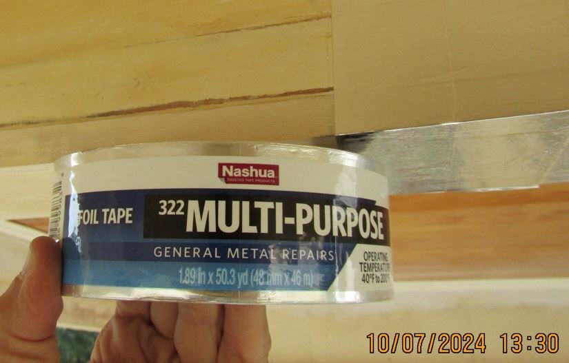

For a long time, I have used aluminum foil tape on exterior and interior wood and plaster repair projects.
The tape is Nashua brand #322. This is the "original duct tape" as used in HVAC work. I think it is about 0.005" thick. Nashua makes other grades which are thinner. This tape has a paper backing which when removed exposes a really strong rubber cement - like the kind used in laminate countertop work. Once stuck in place, the foil really stays put. There is some visible "print through" when tape layers overlap, but is not too visually objectionable.
NASHUA # 322 FOIL TAPE.JPG (54.83 KiB) Viewed 12279 times

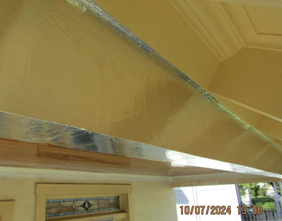

FOIL APPLIED TO OLD WOOD PORCH EAVES.JPG (64.42 KiB) Viewed 12279 times
My main use for this tape is to preserve old weathered exterior wood, such as window frames and sills, from further deterioration. I expect that a metal foil will permanently seal the wood from further weathering and sun/rain/condensation damage, and the tape also "smooths out" seams, putty work, knots, nail holes and many other surface defects. Aluminum foil takes paint very well. When painted, the foil "disappears" and the surface looks much improved.
I am currently using this tape on both old and new wood work - to blend them together and make the seams disappear. Careful application minimizes wrinkles. Burnishing the foil with a wood block will smooth out small wrinkles.
I think surface taping is a useful innovation for wood project finishing. I really cannot think of a downside to using tape on woodwork in this way, but I have not seen anyone else doing this. We will not be able to "sand" foiled wood, but we should not ever again NEED to sand if the tape preserves the wood as we expect. So far, tape I applied 10 years ago is still OK.
I have not used foiling on anything like outdoor wood furniture, trellises, etc, but I do not see why foiling would not enable ANY outdoor wood projects to last "forever". i suppose that after decades the adhesive could fail, but as I mentioned, the adhesive is really strong and not water soluble, and is protected under the foil itself plus paint layers, so it sees no sun or rain, and nor does the wood.
