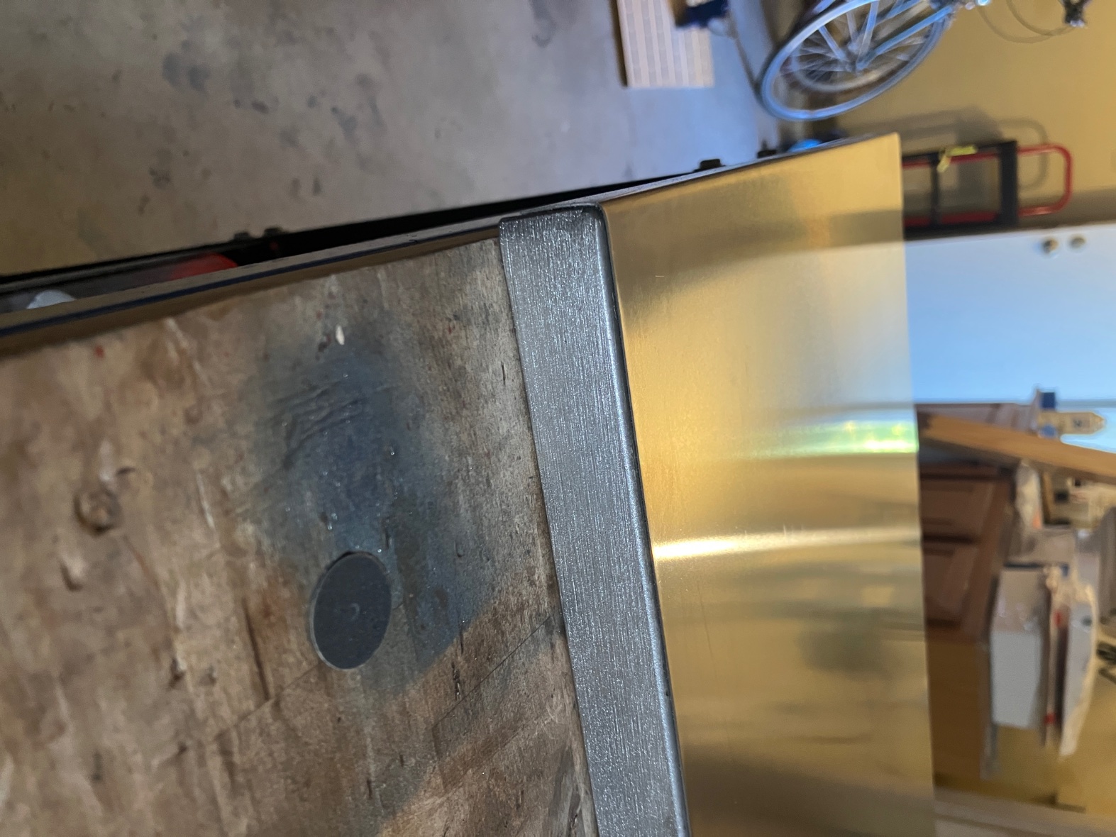

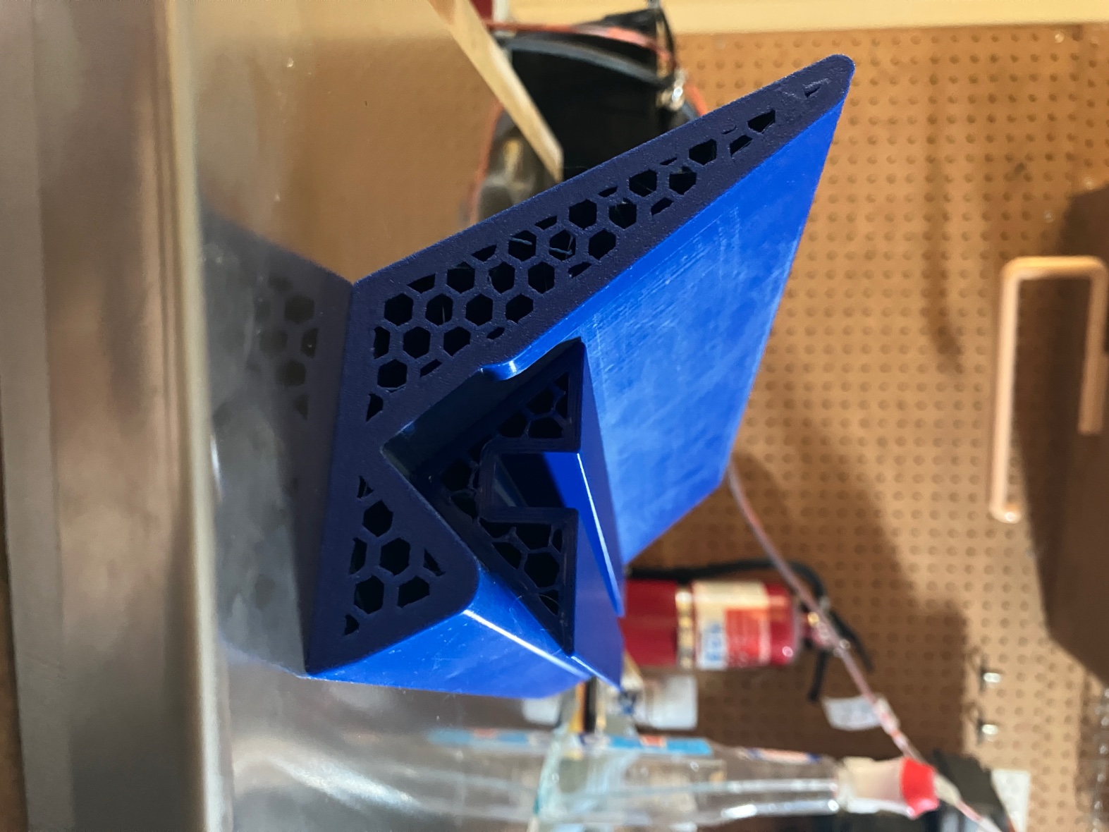

I finally finished this task. I used the 77 glue. Tacky enough and still easy to position. I did 3d print a press due to bend the aluminum sheet. It looks okay. But I have the feeling the aluminum table itself is not 100% even. But it’s minimal and I don’t think it will hinder me to create plane enough boards.

Looks nice, but wondering why it would be necessary to do this. Not possible to clean, polish, and wax the aluminum table to achieve a low friction surface?

Matanuska wrote: Tue Oct 22, 2024 6:13 pm Looks nice, but wondering why it would be necessary to do this. Not possible to clean, polish, and wax the aluminum table to achieve a low friction surface?
Because that is the way the OEM aluminum table on the MK mount planer was constructed. The non MK mount Pro Planer has a cast iron table. To save weight the MK mount planer has an aluminum table and is skinned with stainless steel for durability.
