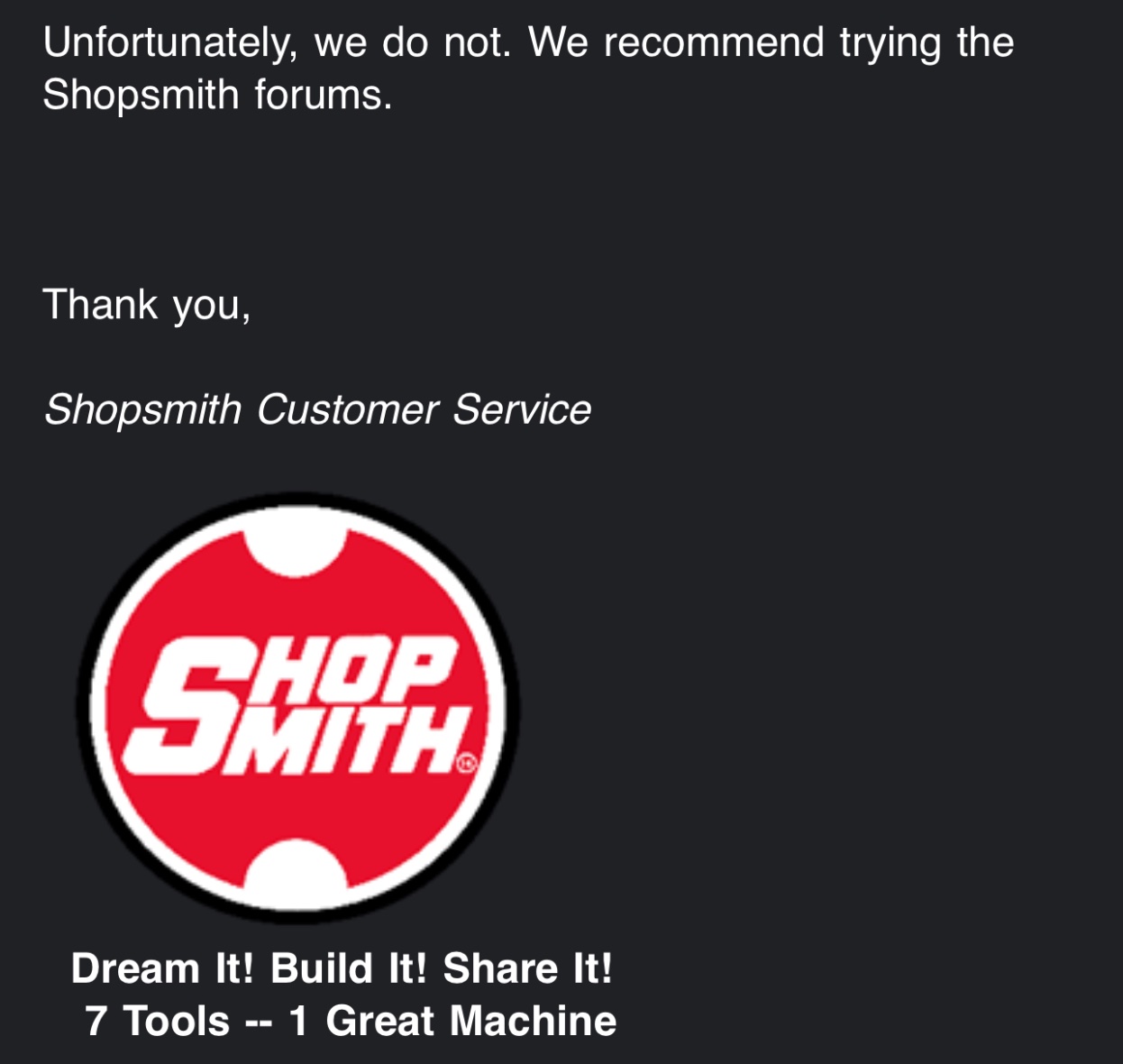

No real surprises. I didn’t expect they hang on to stuff that had a short run in the 60’sCS response will be 'interesting".

At least they are recommending the Forum for answers they don't have.

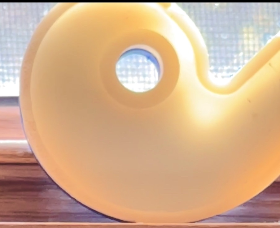

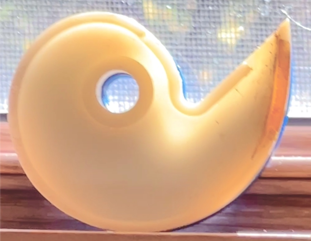

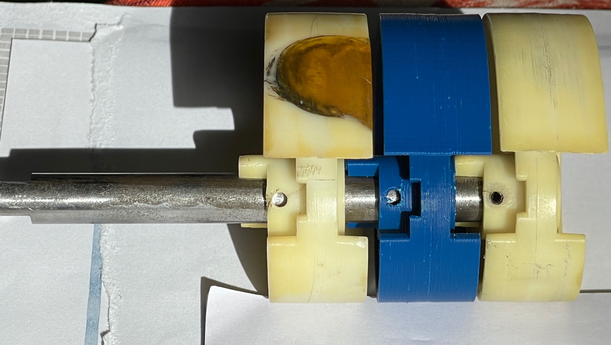

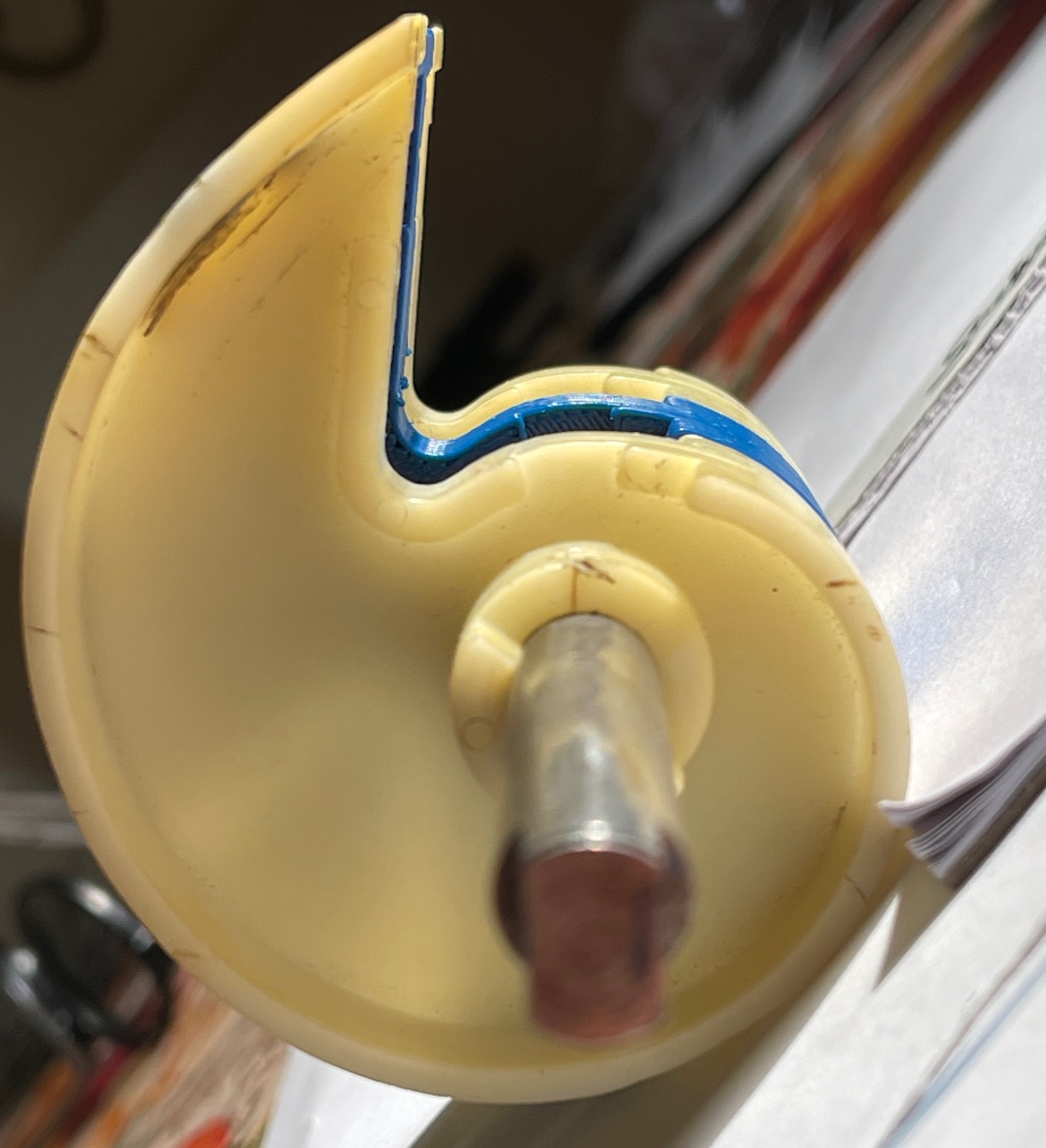

Just got a 3D printed CAM back. Looks good enough as compared to two different factory made original injected molded parts.
How do I upload the STL file for anyone interested?
Photos poorly show side-by-side comparison. The blue one is a 3D printed STL.
The one with discoloration is from my dads Mark VII which was repaired with epoxy.

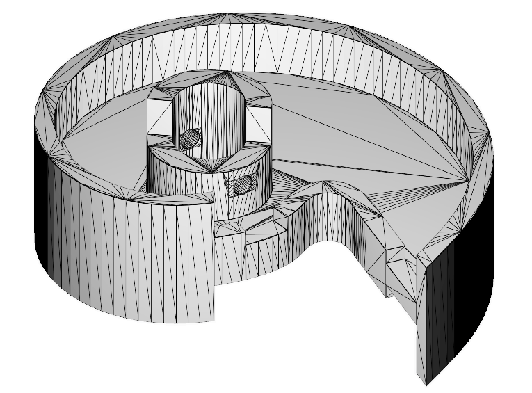

How do I upload the STL file ?
- CAM_Control_PN_501337_STL_screenshot.png (188.82 KiB) Viewed 2900 times
Re: 501337 CAM - Control, Shop Smith Mark VII
Please try again. I have added stl to the list of document types, which is what I believe will cause the system to allow it
Shopsmith I.T.
Here is the STL file used to fabricate the blue "CAM Control" PN 501337 pictured in this thread.
(although the icon shows it as a pdf attachment... it's not a pdf.)
There is a free 3D viewer online at https://3dviewer.net/
501337 CAM - Control, Shop Smith Mark VII, 3D Print File.stl- (510.53 KiB) Downloaded 195 times
That is a spitting image of the cnc created aluminum cam I have (hopefully with straighter control shaft hole).
