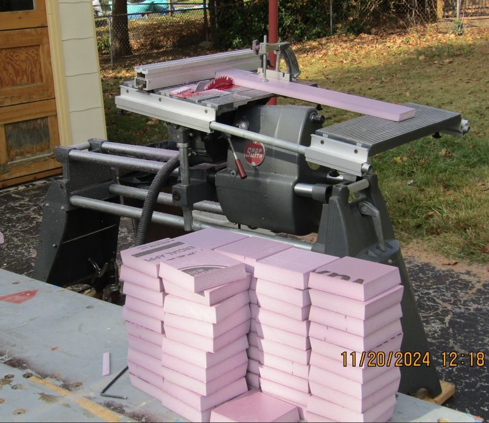

I currently have a home project which requires fabbing a large number of identical rigid tiles. Any rigid material, including wood, could have been used, but "pink" foamboard was chosen for economy and ease of use. Super easy to get very clean and repeatable cuts of pink foamboard on the table saw - and at the lowest Shopsmith speed. Pink foamboard can be sawn, drilled, planed identically to wood in most cases, but at low speed and without the weight and cutting resistance of wood.
I thought back to my Shopsmith learning curve from 3 decades ago. Early on I had my share of kickbacks and near-misses, but have been very lucky to this day. I think my learning curve on the Shopsmith would have been less difficult had I started cutting on rigid foam before wood.
Today, if I were introducing a beginning student to power tool use, I might start with foam - just to get the student acquainted with tool setup, tool noise, hand-eye coordination while feeding, and kickback hazard - while cutting a far less resistant, heavy and more hazardous material.

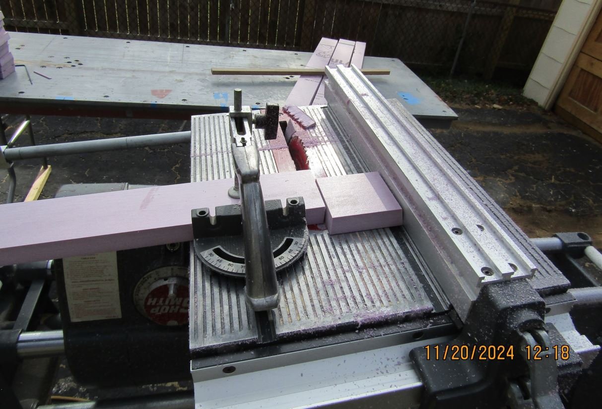

Can you explain what operation you are doing in that first pic you posted? I ask, because in woodworking, you are are NOT supposed to use the miter gauge together with the rip fence in this manner shown here. As you proceed with the crosscut, it is easy for the workpiece to bind between the sawblade and the rip fence. Some use a stop block attached to the rip fence well before the front edge of the sawblade in order to do repetitive crosscuts with the miter gauge. In such a way, the position of the cut piece is set precisely for repetitive cuts, while keep a sufficient gap between the right end of the workpiece and the rip fence once the workpiece contacts the sawblade. In contrast what you are showing in your picture, invites a kickback event.
For rip only cuts, I assume you know that many woodworkers purposely set a few thousandths greater gap at the back of the sawblade to rip fence alignment. In such a way, it greatly minimizes any pinching that can occur between the sawblade and the rip fence as the workpiece is advanced into the sawblade.

Yes, should have used a fence spacer. Thanks RF.
Note that the workpiece has a 7 degree draft angle. So the workpiece comes in contact with the fence along a line rather than surface-to-surface, as illustrated:
Still should have used a spacer if for no other reason than to avoid the 1/16" gap under the fence.
Cut over 100 of these foam tiles and got no kickbacks.
