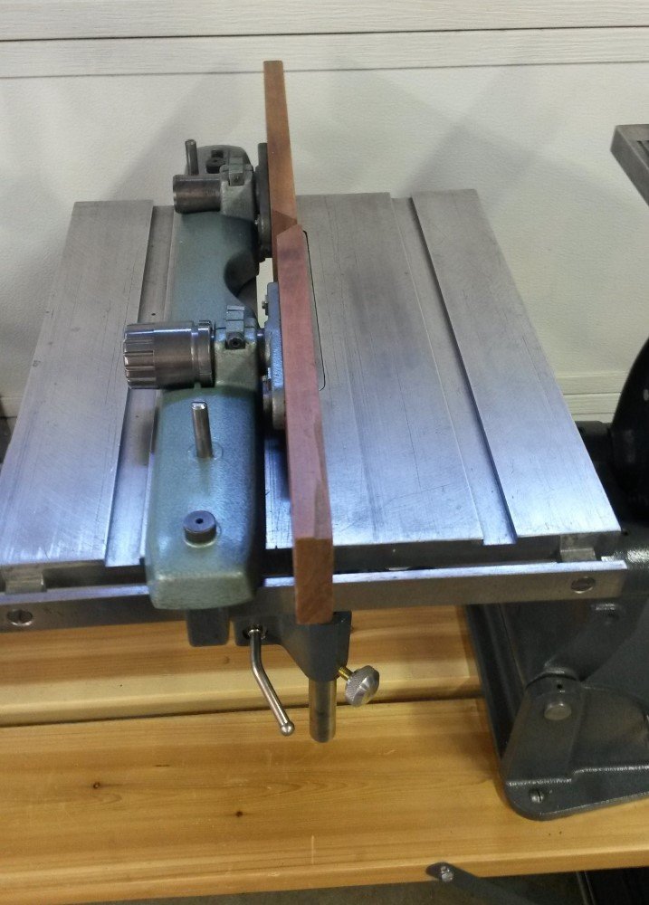

JSwift.
Mark V serial number 192838 was made in November 1984. In September 1984 the Two Bearing Quill replaced single bearing quill in headstocks for Serial number 190000 & above. The Mark V-B appears on those with the Two Bearing Quill. The Vent/Serial Number Plates I have seen follow that change.
You can use the Router/Shaper Fence made for the Mark 5/V with the original Table system AKA 500 on any Mark 5/V/V 500 like yours. The Router/Shaper Fence for that Mark 5/V came out in 1954 with the introduction of the Mark 5. That Fence even fits the Model 10E and 10ER made prior to the Mark 5. See that fence on my Model 10ER below. The Mark VII from the 1960's uses a Router/Shaper Fence specific to it. The Mark V 510/505, 520, 520S, Mark 4 and current Mark 7 all use a different Router/Shaper Fence than the Mark 5/V with the original Table System. Now having said all of that you can do over the table routing and shaping with your Mark V-B. Do know that the maximum speed of the Mark V is much slower than actual Router and Shaper systems. I have done it successfully. Care must be used including a very slow feed rate into the cutters. If you wanted to do under table Routing or Shaping, you would need either the Speed Increaser which will bring the maximum speed up to 10,000 RPMs or change table systems and add the Double Tilt upgrade.
_ ,
All the SPT's like the Bandsaw or Jointer for example can be used on your Mark V-B. Upgrades made to the Mark 5/V over the years can be added to older Mark 5/V's. If you wanted to upgrade your Table System or add the Power Pro Headstock, for example, no problem.
You may be wondering why I use Mark 5/V throughout my text. It is how the Shopsmith tool has been labeled over the years. With its introduction in 1954 it was the Mark 5. In the beginning of 1980, the Vent/Serial Number Plate was changed to Mark V, It is simply how the tool was labeled just like yours saying Mark V-B. Shopsmith is the name of the tool, but it has not always been the name of the company making it. Mark V-B, in your case, is the model of the tool.
I hope you had an enjoyable Thanksgiving.
_ ,
