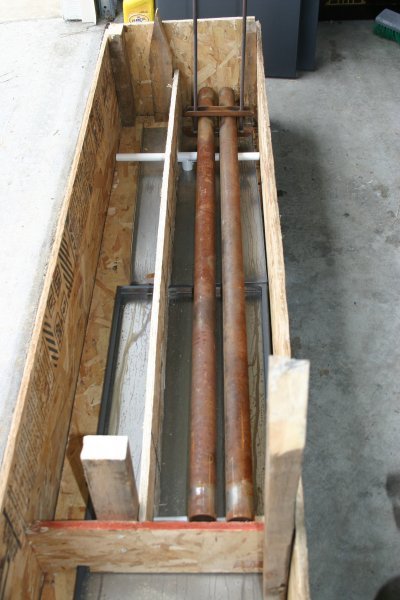

Completed the electrolysis on my bench tubes. Came out pretty good with no effort. Still have to polish them.
Update 6-14-09 Try to set up the tank so that it is off the ground like in this postso that you can siphon the liquid out. I had to use a pitcher here since the tank was on the basement floor.
In the container
[ATTACH]3404[/ATTACH]
Filled with "the broth"
[ATTACH]3405[/ATTACH]

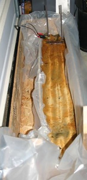

After one hour. Notice the foam.
[ATTACH]3408[/ATTACH]

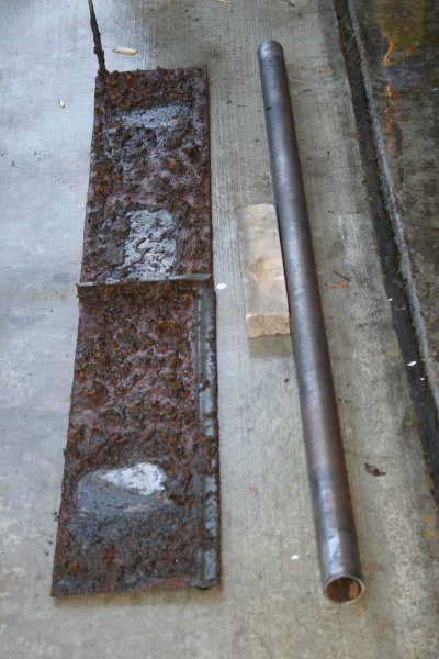

Out of the bath and rinsed off. Check out all the junk that is on the sacrificial sheet metal that pulls the rust off. Update 3-29-09 The cleaned up version can be seen later in this post.
Gotta run. Wife beckons. Going out to eat.
[ATTACH]3407[/ATTACH]

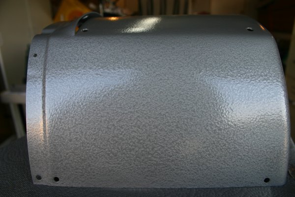

Almost forgot......got the motor cover painted also. Hammered Silver. Pleased with the result. Learned a lot about getting the texture to come out right. I'll go into details later.

mickyd wrote:Almost forgot......got the motor cover painted also. Hammered Silver. Pleased with the result. Learned a lot about getting the texture to come out right. I'll go into details later.
[ATTACH]3409[/ATTACH]
Nice looking finish!!!

Looks good so far. How do you drain the liquid out of your box?
Tim
mickyd
Posts: 2999
Location: San Diego, CA
Post by mickyd »
a1gutterman wrote:Looks good so far. How do you drain the liquid out of your box?
All I did to take the liquid out of the box was use a pitcher and transfered it into my 15 gallon plastic storage buckets. As it got low, I tilted the box and used a cup.
The liquid is good forever. As the water evaporates, you just top it off with more water. You never have to add any more of the sodium carbonate (washing soda). I also use the solution to restore old cast iron pans that have all the carbon crud on them. It takes that stuff off too. Some people just put them in a fire to burn it off but that can warp or crack them. Electolysis just eats it up.

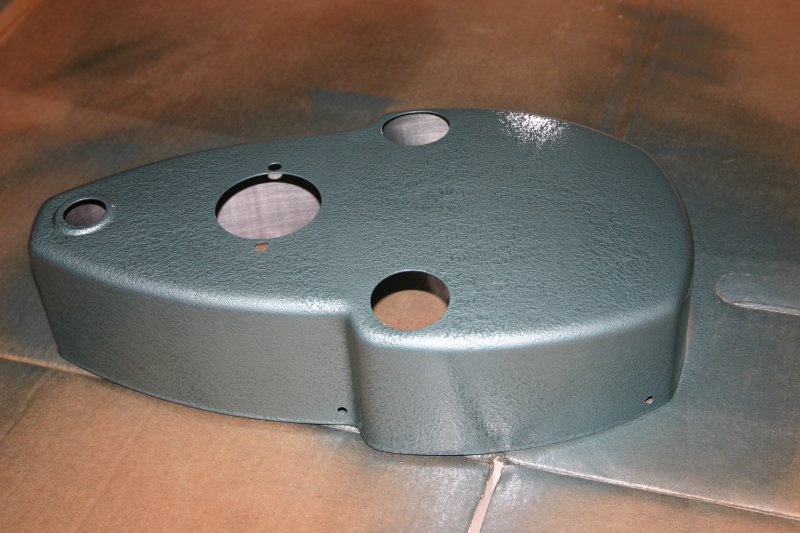

Got my belt cover painted tonight. Hammered Verde Green. Boy that paint is tricky to work with if your looking for the heavy texture appearance. There is a fine line between getting the texture right and the paint wanting to run. If it goes on too light, the hammered effect really doesn't show. Too heavy and it wants to run on the vertical surfaces. Right before I spray, I do a few practice passes on some scrap sheet metal to get the timing right.
