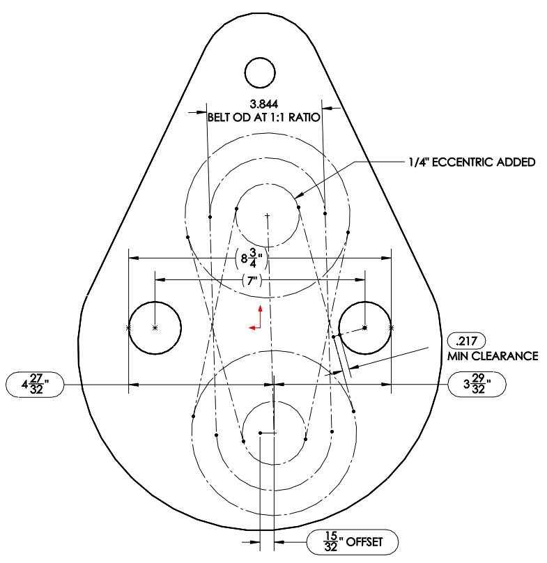

SteveMaryland wrote: Wed Jan 01, 2025 1:08 pm ...The above layout shows the Shopsmith at the midrange speed + we have added the eccentric effect. Still looks like we have at least half an inch of clearance...
Focusing on the differences(s) between Steve's model and my hardware... I'm surprised to find that the motor shaft axis is somewhat nearer to the front way tube (right way tube on Steve's 2D picture) than to the rear. More so than the Idler at the eccentric's max bias. I used a combination square placed over each way tube and measured to the center of the motor shaft, and the motor axis was about 3/4" closer to the front way tube. (Measured on the angle, which I didn't determine, so this is not an accurate measurement.) I used the same method to measure the Drive Sleeve spindle and found it to be exactly centered.
Somewhat tentatively, I conclude that the motor position as shown in the model is incorrect. Factoring in a front bias of both the Idler and the motor, the belt comes much closer to the front way tube than to the rear. And therefore much closer than the model would predict.

DLB, you have made an important discovery. Thank you. I had ass-umed that the motor axis was "centered " on the headstock plane of symmetry. I really had not noticed an offset. I previously modeled the physical headstock (using ruler, tape measure, etc.), but I sure missed that feature.
I don't often have the headstock dismantled, and whenever my headstock is dismantled, it's for repair and not measurement. I can't remember exactly how the motor is mounted.
Please advise the offset dimensions, and if the offset looks to be "fixed" in the mounting or if it can be varied by slotted holes or similar means. Let's find out if it answers the present mystery.
Also, what might be the design reason Shopsmith mounted the motor with an offset from the center plane? Has to be some reason.
Getting accurate dimensions from the physical headstock is tricky. What would be really good to get, are the original Shopsmith engineering drawings that were used to fab the headstock castings and other parts, because from such drawings, the "actual" dimensions could be exactly obtained. Has anyone on this forum seen those drawings, and are they viewable?

My results differ from Dusty's. My measurement was more complicated, but then I used a simple setup to confirm. I laid a combination square across the way tubes with the 90 degree head in contact with the outer edge of whichever I was measuring. Then but a Starrett right angle rule clamp on the combo square rule, with a 6 inch rule on the clamp and therefore at a right angle to the combo blade. I moved the clamp until the 6" rule crossed the center of the motor shaft, clamping it when it was properly located. The motor shaft was centered 3-29/32" from the outside of the front way tube and 4-27/32" from the outside of the rear way tube. A difference of 15/16", of a bias of half that, or 15/32". I'm not going to claim this is the exact value, but I'm reasonably confident it is within 1/16" at worst.
The headstock I measured has an Emerson motor IIRC. I don't think this actually matters, as far as I know all Mark 5/V motors use the same air plenum which also is the shaft end motor mount. My best guess at a reason for this offset is to make room for a startup capacitor that on some motors is mounted on the case.

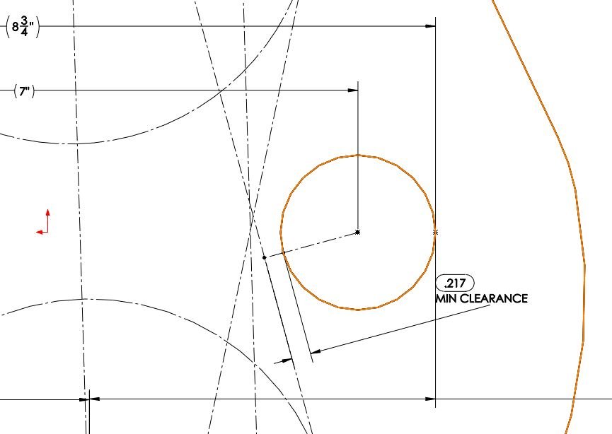

Latest layout showing DLB's data:
DRIVE SHEAVE AND BELT PROXIMITY TO COMPONENTS PER DLB DATA 1.JPG (66.84 KiB) Viewed 4759 times
DRIVE SHEAVE AND BELT PROXIMITY TO COMPONENTS PER DLB DATA 2.JPG (44.91 KiB) Viewed 4759 times
Capacitor sounds like the cause of this issue.
Did Shopsmith put this offset in only on units equipped with capacitor? Or on all units across the board?
Still showing some worst-case clearance, but Is this an operational concern for certain owners?
