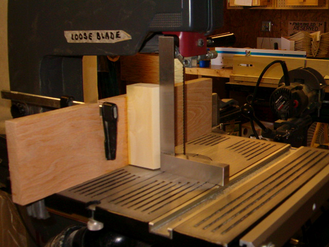

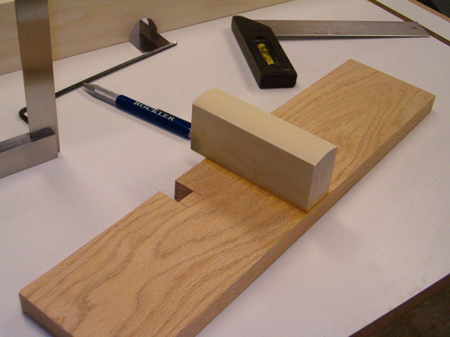

Resaw guides?
After reading about the Kreg resaw guide (http://www.amazon.com/gp/product/B0007VYL4S) and having issues with the adjustable fence, and not wanting to buy more "bandsaw improvements" I came up with this guide. It was made from cutoffs - cost about $1.00.
Realizing these photos have been posted several times, here they are again! Newer forum members probably haven't seen them.
With this simple jig I can resaw very thin strips without and fence fiddling.
[ATTACH]3416[/ATTACH]
[ATTACH]3417[/ATTACH]
- HPIM1777.jpg (134.56 KiB) Viewed 7219 times
- HPIM1778.jpg (121.06 KiB) Viewed 7175 times
