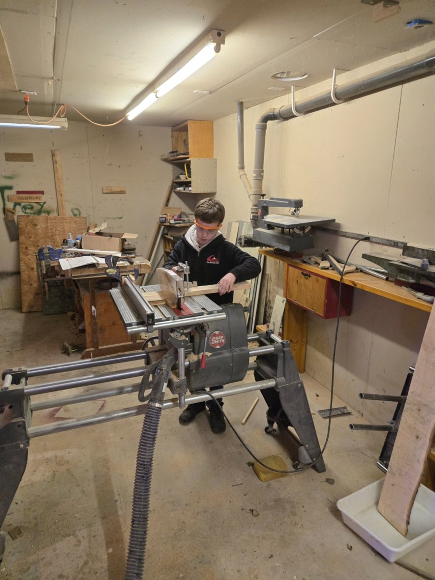

My 12 year old is completing assignment 4 of the self study course.
- 20250201_100746.jpg (165.68 KiB) Viewed 14967 times

Great -- YES but is that cutoff trapped between the blade and the fence. If yes - a kickback is likely.
- Posts: 35428
Re: Beginning SSer
Fear not, he is well positioned away from the path of the inadvertent missile.
Good catch!
I hope the pix is staged(saw blade motionless).
Re: Beginning SSer
If you look closely there is a stop block clamped to the fence at the input end. That is exactly how that operation should be done to prevent a kick back.
Re: Beginning SSer
Good eyes, John! Yes, he is following the instructions to a T, and they are very explicit. Interestingly enough, Trey actually questioned me on the need for the block, and I showed him a staged scenario of what would happen without the block.

Re: Beginning SSer
It is not the workpiece being cut that I was concerned about, but rather the two already cut pieces that appear to be sitting between the blade and the fence.
Re: Beginning SSer
That is a valid point, but in my defense, over the last 30 years as a carpenter, I have never seen a loose piece even start to kick back as long as there was adequate clearance between the blade and fence. Having said that, I still acknowledge that it's never a bad idea to take extra precaution.
