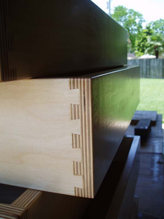

BuckeyeDennis wrote: Wed Feb 05, 2025 10:14 pmAs for using 12 mm BB for the drawer frames, I’ve been wondering the same thing. After cutting the drawer bottoms from full sheets of plywood, I could still make all the frame components from the cutoffs. Does anyone know of any reason not to do so?
Beautiful drawers! In my limited experience of making drawers, I used 19 mm (nominal 3/4") 13 ply BB for the basic box, and 12 mm (nominal 1/2") 9 ply BB for bottoms and applied drawer fronts. The exposed edges of the plywood are aestically the only drawback of which I am aware to using BB in lieu of solid stock.
In my working days, we specified hardwood drawer bodies on our projects, and casework suppliers would frequently try to substitue BB, so it was common practice back then.

BR549, you have erased any cosmetic reservations that I had about using BB for the drawer frames. Those drawers look fantastic, especially with the nice tight dovetails joints.
