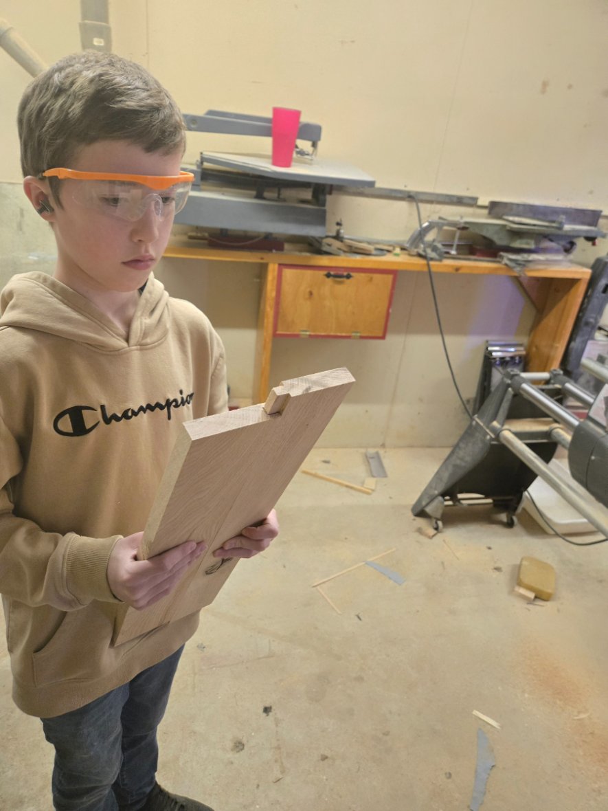

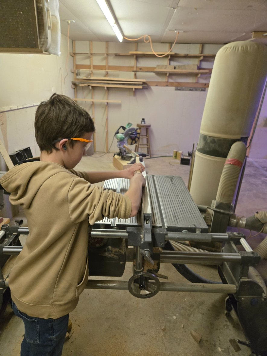

Here he is with his tongue and groove. Took him a couple of tries, but he got it!

Sorry, here's the finished product.
