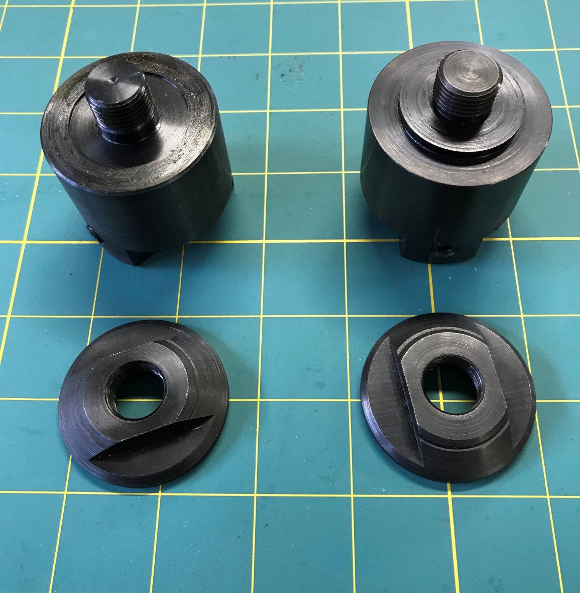

Something to be aware of is there is an 1-1/4" Saw Blade Arbor 555572 that looks like 555608 but instead of a recess it has a raised center inside as seen below. 555572 is the one on the right. It was also made for the SawSmith Table Saw and has been discontinued.
