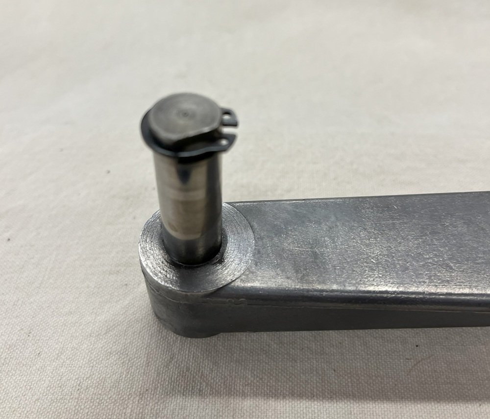

Re: Bandsaw eclip fails, wears out?
Below are examples of the types of clips and differences between older Bandsaws and newer ones.
The first picture is a 1956 Bandsaw using the original type of clip that holds the Upper Wheel in the Axle. The use of this type of Clip can easily be determined by the flat side on the end of the Axle.
_ .
Below is a later Bandsaw from 1998 using the E Clip and notice the Axle does not have a flat side.
_ .
A plus for having the E Clip is easier removal and installing. The E Clip provides a wider surface area over the end of the Fiber Washer and Wheel than the original Clip does.
Mine has the shaft with the flat spot on it. Do you know what type of clip should it have? Can I use an e-clip?
- Posts: 4184
Try finding the correct size E Clip to replace the original. I do not know of a source for the original Clip type that came on the earlier Bandsaws. One possible problem if using an E Clip on a Bandsaw that has the flat on the Axle is the E Clip rotating and one end or the center of the clip getting to the flat spot and popping off. An External Snap Ring may be the answer for the older Bandsaws.
I have only worked/restored one Bandsaw at a time and the Clip, in all cases, did not need replacing. I have not compared the two Axle grooves to see if they are the same size in width and depth. I have restored or refurbished 6 Bandsaws. All Bandsaws need to have the Upper Wheel off the Axle from time to time to grease the bearing.
When I have time, possibly next week, I may have to compare the two types of Axles to see if the E Clip can replace the original Clip type without the possibility of popping off. I'll check on the External Snap Ring as a possible replacement too. I have both the early and a later Bandsaws awaiting restoration to check it out on. I'll have to take some pictures at the same time to post for reference.
I got out to the shops today and checked to see if an External Snap Ring can replace the original retainer on the earlier Bandsaw's Upper Wheel. I used a 1/2" External Snap Ring as shown below and it fits in the Axle's groove. I haven't tried it in actual use on a running Bandsaw yet.
