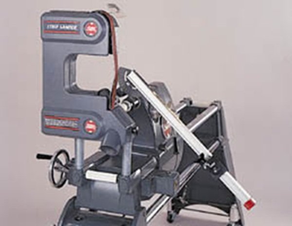

Your Strip Sander has the 1" Platen installed. The 1/2" and 1" curved are the other two that come with the Strip Sander. Below is a picture of a Strip Sander with the 1" Platen installed and the other two Platens on its Table.
_ .
There is a fourth Platen for use with the Lathe Chisel Sharpening Attachment that is 1" wide with a slight bend. The picture below is the Strip Sander with the Lathe Chisel Sharpening Attachment installed. The Chisel Sharpening Attachment replaces the Table for use. Note the slight bend in the Sanding Belt near the middle of the Platen.

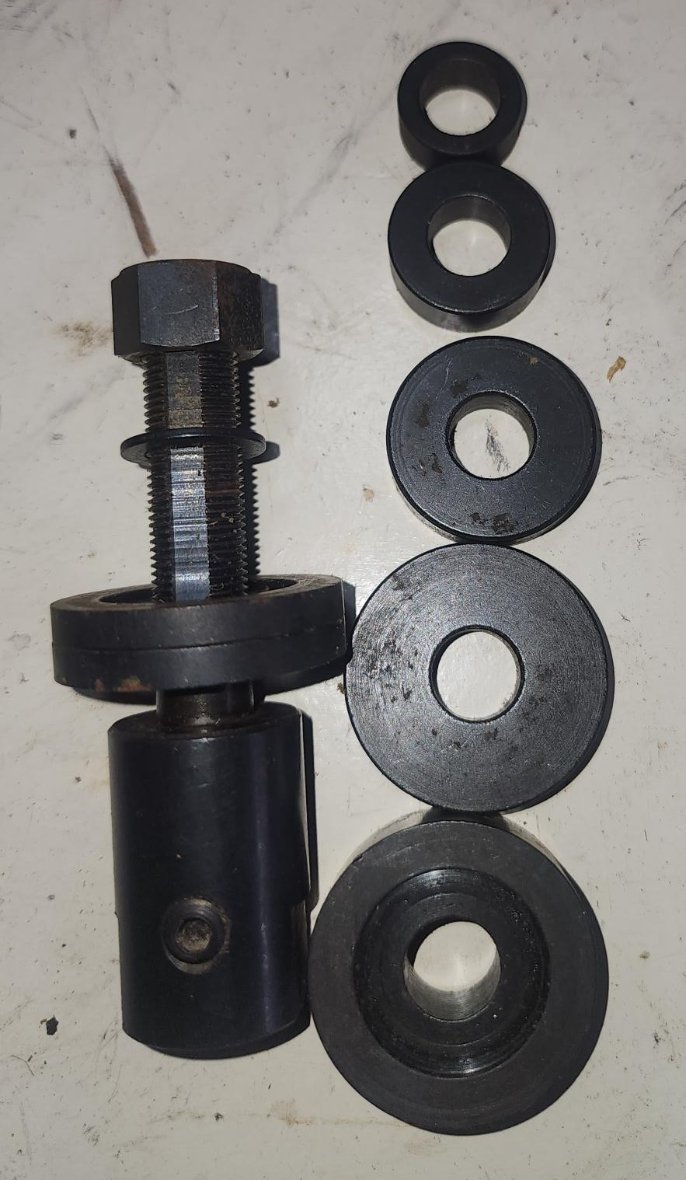

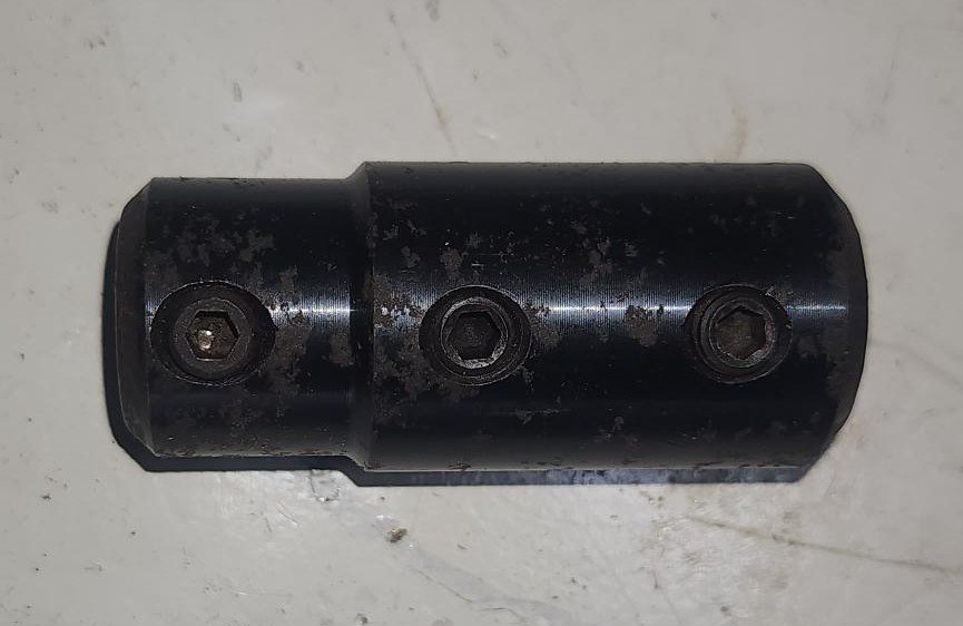

There are only a couple more pieces left in the pictures below.

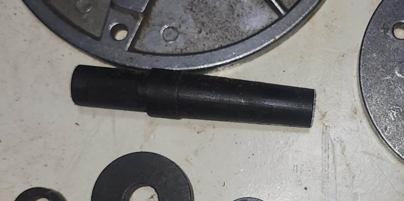

The first picture I think goes into the tailstock, I just cant figure out what purpose it has to do so or if it is not whole.

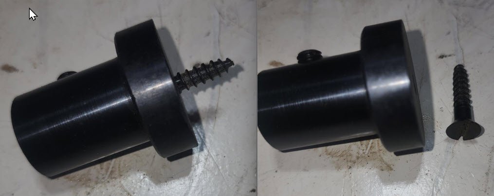

I believe I found the Screw for the lathe center it fits to nice not to belong.

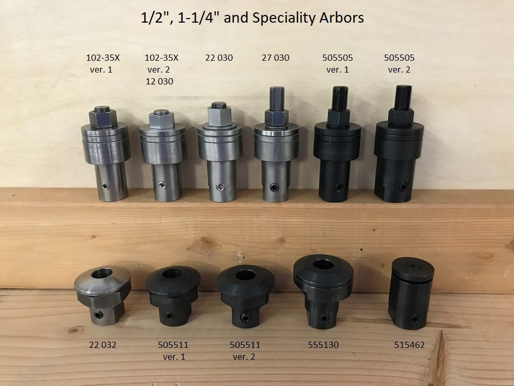

the third picture I believe is a router or shaping set, I don't know if it is complete I know there are no cutting heads, I have seen the similar shaft with a big round cutting head.
the fourth picture i have also seen reference as a part of a router head.

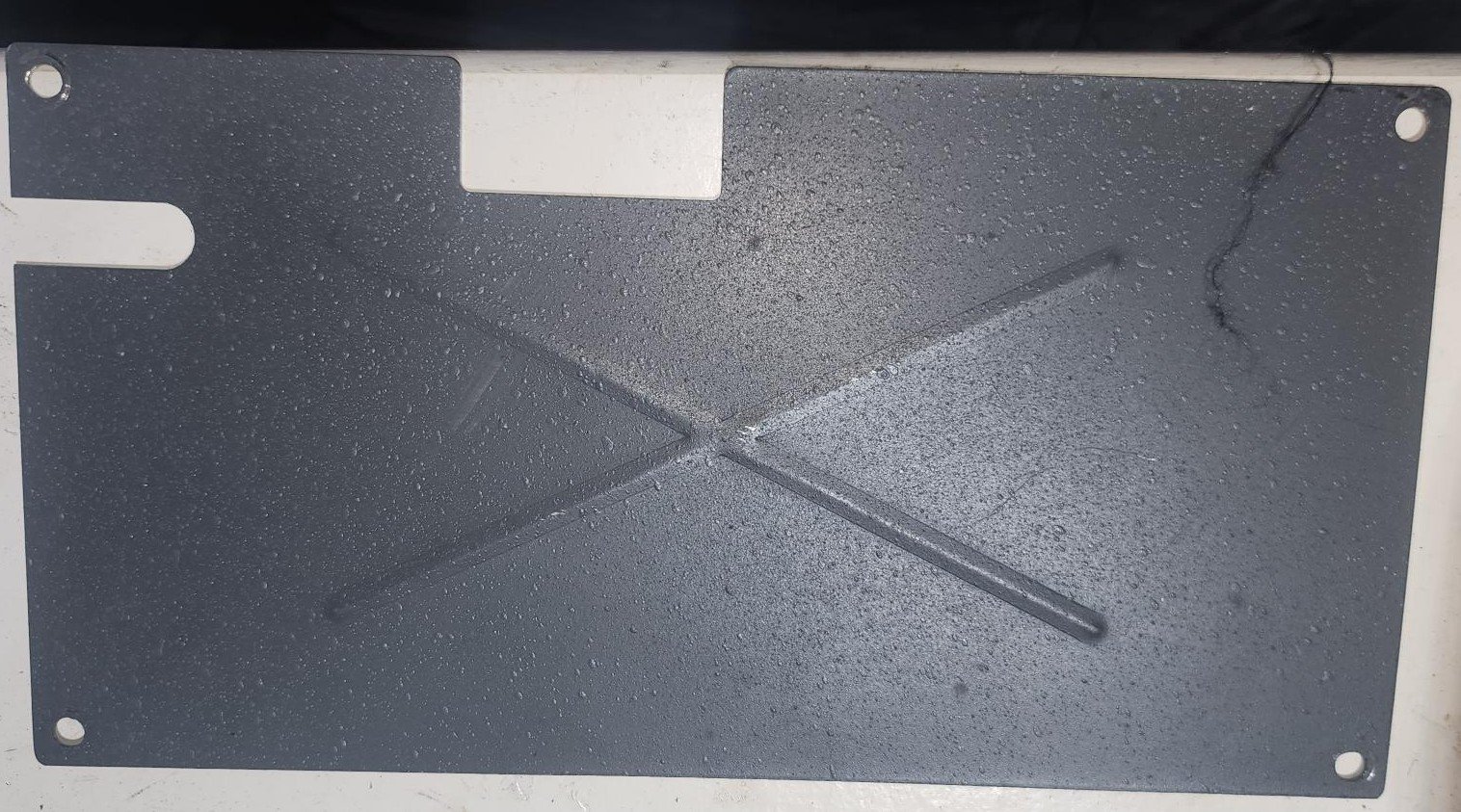

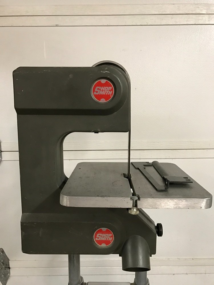

the fifth picture might not even be a part but it has the same paint scheme.

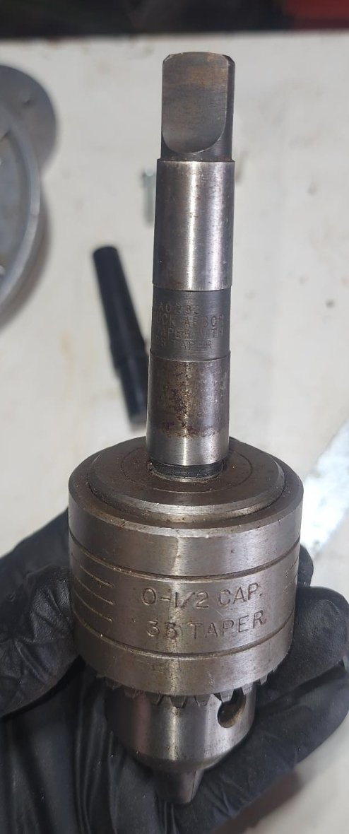

the 6th and 7th are the chucks, I don't know how to separate the tail from the chuck, i didn't want to force anything trying to unscrew it. the smaller one has a threaded shaft where i would expect there to be smooth to put on the power head. so i don't think it is the one that goes to the unit. or I'm missing whatever threads into it to go onto the powerhead.

The first picture I think goes into the tailstock, I just cant figure out what purpose it has to do so or if it is not whole. Tailstock adapter. The tapered end goes into the tailstock, the 5/8" end goes into the 5/8" bore unique to the SS chuck
I believe I found the Screw for the lathe center it fits to nice not to belong. Appears so!
the third picture I believe is a router or shaping set, I don't know if it is complete I know there are no cutting heads, I have seen the similar shaft with a big round cutting head. 1/2" shaper arbor - no cutter attached - appears complete.
the fourth picture i have also seen reference as a part of a router head. 1/2" router chuck.
the fifth picture might not even be a part but it has the same paint scheme.object unknown(by me)
the 6th and 7th are the chucks, I don't know how to separate the tail from the chuck, i didn't want to force anything trying to unscrew it. the smaller one has a threaded shaft where i would expect there to be smooth to put on the power head. so i don't think it is the one that goes to the unit. or I'm missing whatever threads into it to go onto the powerhead. Whoo wee. Sorry you are correct. They are not OEM SS. Now that is not all bad. The one with the MT2 taper will fit the tailstock. The chuck has a "33" taper which can be pressed out IF it is accessable from the depths of the bit end. The other chuck is the better of the two, but does not have the SS 5/8" bore. Likely 1 1/2" thread

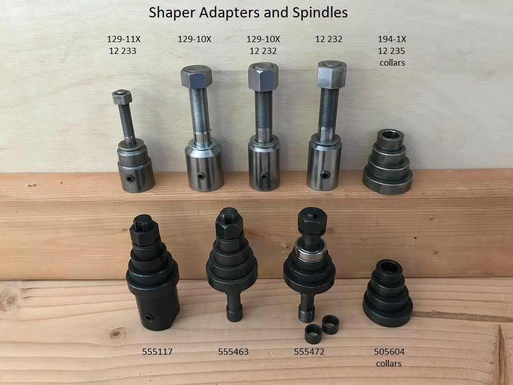

The third picture is actually two items. The 1/2" Universal Arbor part numbers 505505 and the set of 4 Shaper Rub Collars part number 505604. The Shaper Rub Collars are intended for use on the 1/2" Universal Arbor with Shaper Cutters. The 1/2" Universal Arbor has been discontinued. They are the 2 versions on the top right in the picture below. The Machined Spacer and the 2 Machined Washers are not used when using it for shaping with a rub collar. The rest of the top row are earlier versions of the 1/2" Arbor from the oldest beginning on the left.
_ .
The 1/2" Shaper Arbor with collars part number 555117 replaced the 1/2" Universal Arbor for the Shaper function. The Shaper Arbor can be seen in the lower left in the picture below. It is the same Arbor as version 2 of the 1/2" Universal Arbor without the Spacer or 2 Washers but includes the Rub Collar set. The Shaper Collar set 505604 is on the lower right. The rest of the Spindles below are the different ones made through the years for shaping.
_ .
The item in the fifth picture may be the Base Plate to the gray Shopsmith Scroll Saw.

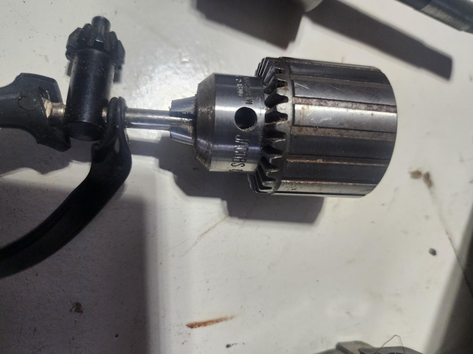

a question about the tapered drill chuck, if it slides into the tail stock, how does it spin, is there a bearing or something in the tailstock to allow it to spin.

It doesn't spin. The drill bit is stationary; the workpiece you're drilling spins
Mark V 510 51-014654
Re: help with my new-to-me shopsmith.
The tapered end does NOT spin(that is the job of the quill). The intended purpose is to allow the drill chuck/bit to be held stationary while the quill/workpiece revolves. A live center has a bearing which allows the center to revolve with the workpiece.
A bit different from "normal" lathe procedure(more ways than one).
BTW if that tapered chuck really goes all the way to "0" it is a keeper.
