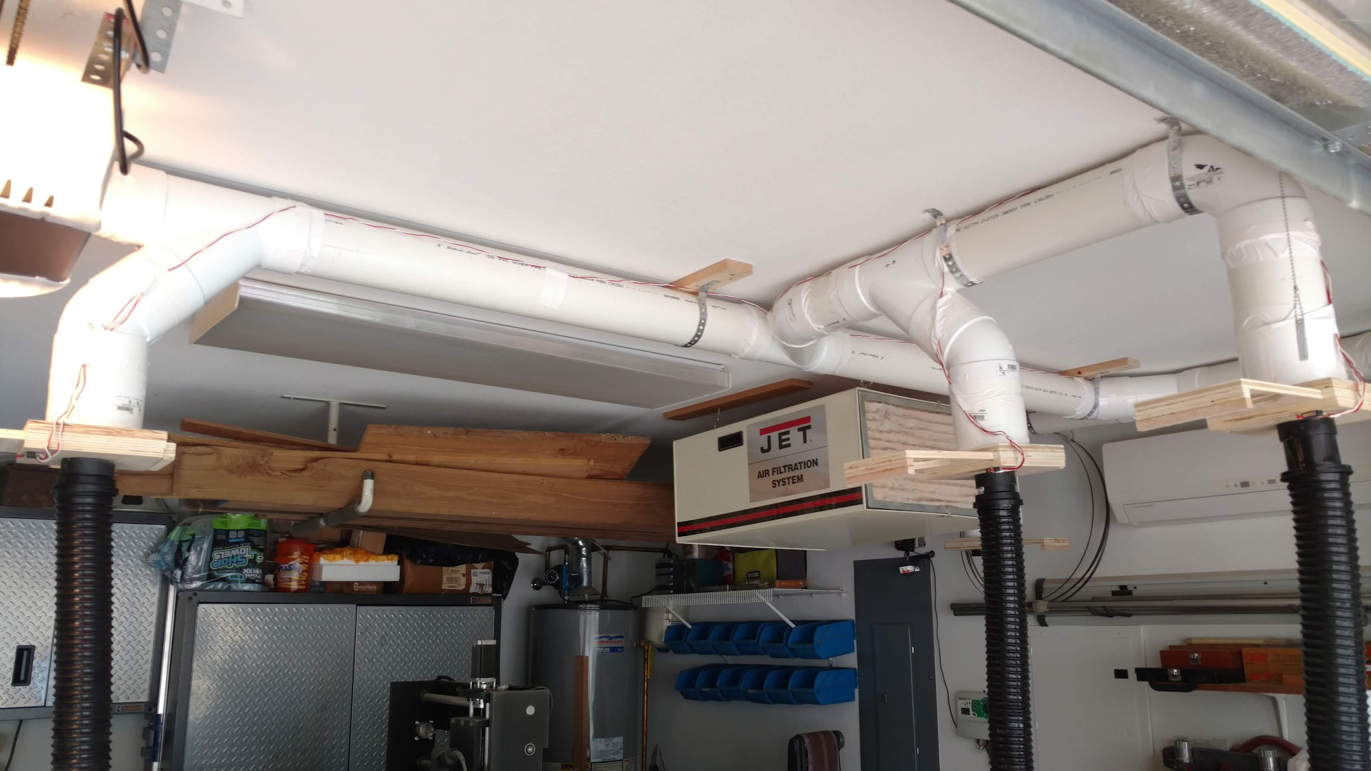

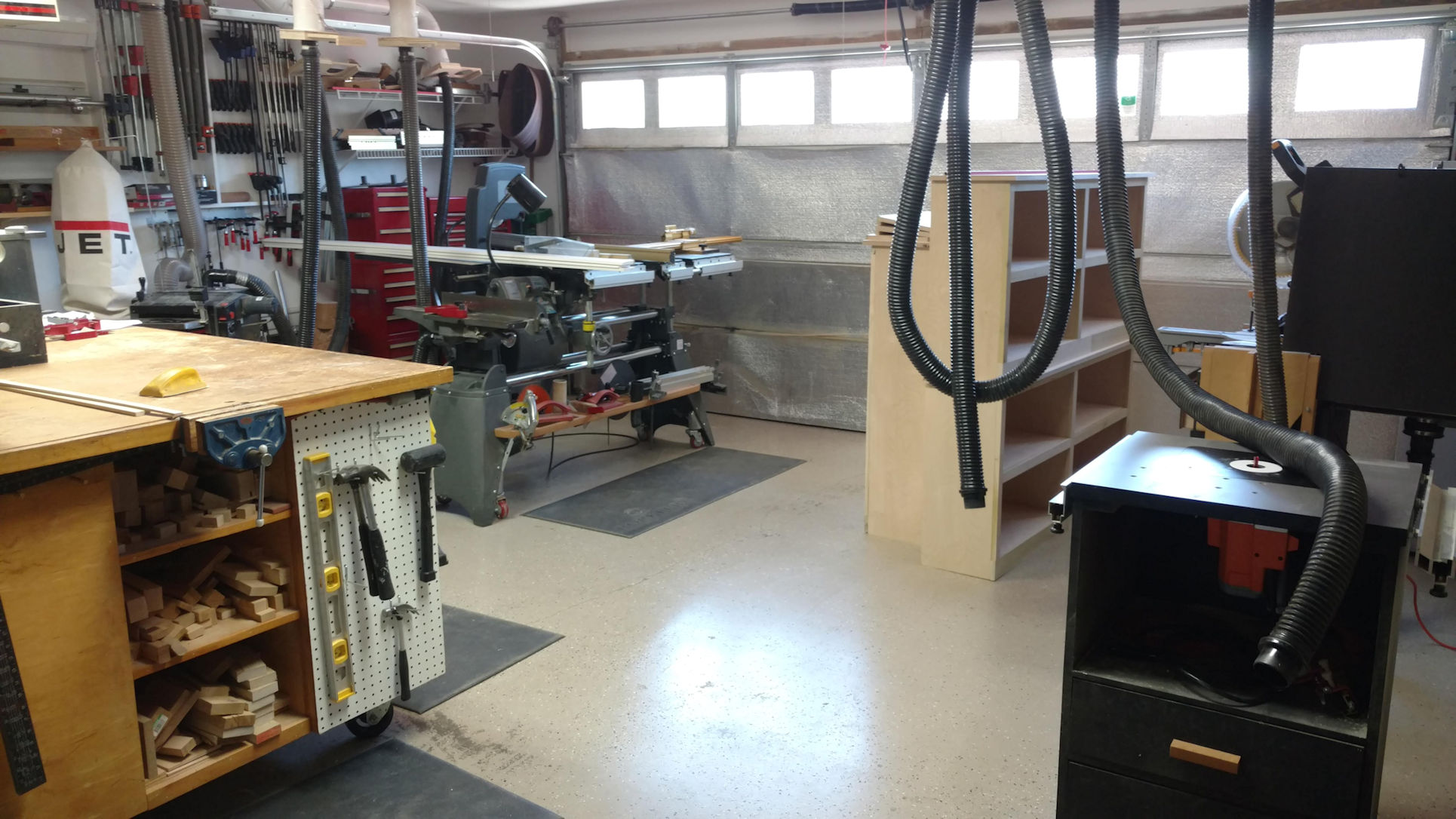

Good question about dust collection.
Yes, I use dust collection. In fact, because much of what I do, requires me to go between table saw, jointer and planer (on its own power stand), I have a system with blast gates at each tool. The blast gates are wired with micro switches that turn on the dust collector when that particular blast gate is opened.
I also run my jet air filtration system when I am sawing and creating dust.
I'll try to add a couple of pictures, so you get the idea. (I guess I can't figure out how to do that. Thanks for your help. I got it.)
I will continue to follow up with my friend about the DVR motor filters.
Thanks
Lyle
