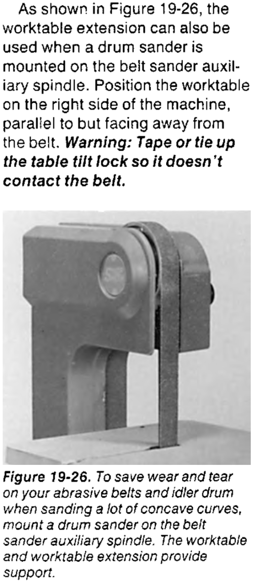

Hmm, was just looking at that version in the link. I think this might be a bit of an error
(And no surprise -- my print copy is the same)Greenie SN 362819 (upgraded to 520), Bandsaw 106878, Jointer SS16466
Re: Mark 7 self study guide vs vintage DecCristoforo book
Yeah, wrong sander. The belt sander can be mounted on either side of the headstock so it does have an auxiliary spindle. The standard strip sander doesn't but I modified mine to mount the other way so it does have an auxiliary spindle now. Described in this thread- Strip Sander wheel and bearing.HopefulSSer wrote: ↑Tue Jun 03, 2025 1:43 pm Hmm, was just looking at that version in the link. I think this might be a bit of an error

As for HopefulSSer's post above that is an oops made to the current version of the 4th edition of Power Tool Woodworking for Everyone and the original 4th edition has the correct picture in Figure 19-26.
It will take a lot of time comparing page by page the different copies I have of the Self-Study Guide to see what changes may have been made to it over the years. Based on the use of those cross-reference sheets little may have changed to the Self-Study Guide.
