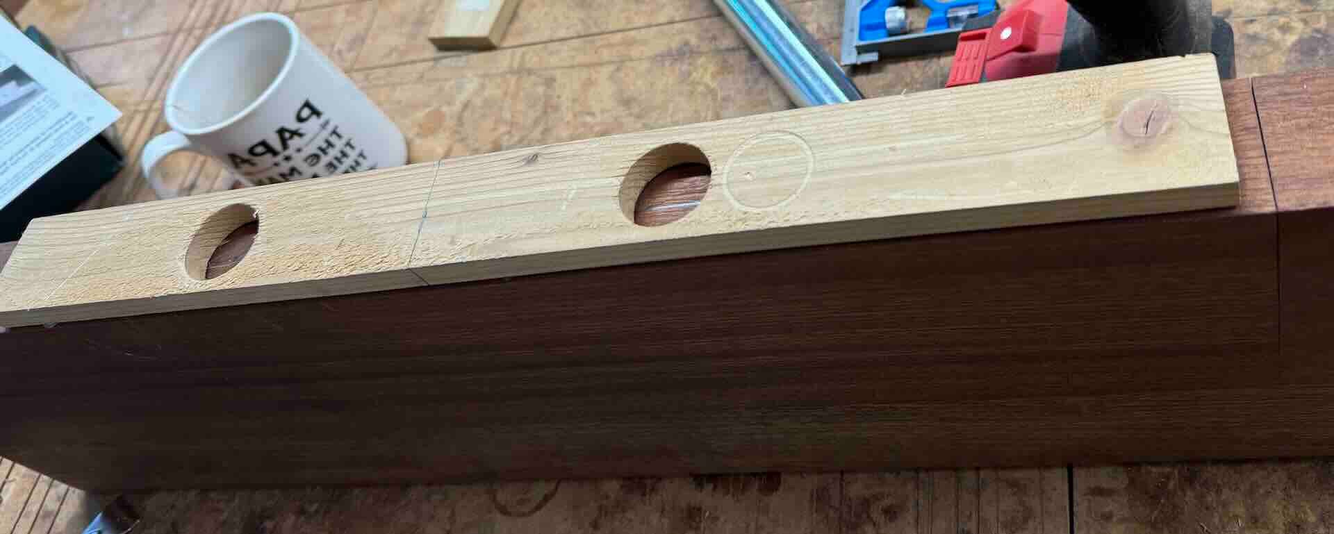

Instead, I used a template. I cut some scrap wood as wide as the thickness of the stationary jaw (2 inches wide by about 1/2 thick").
I cut off a section of that scrap piece as a spacer and placed it onto the SS castings, matching one edge to the outer rim of the recess in the casting and then trimming the opposite end to fit exactly in the distance between the casting recesses. IOWs, this is
a spacer that exactly represents the distance between the two tubes. Getting the spacer the exact length was just by feeling the edge as it rests on the casting recess. Small adjustments were made with the disc sander until an
exact fit.
Next, I drilled a 1 and 1/4" hole with Forstener bit in the longer template piece. This represents the position of the first extension tube. Then I hot glued the spacer to the template, aligning one edge to the previous cut hole, by feel. I rotated the template 180 degrees and butted the spacer up against the bit and drilled the second hole.
- MoxonTemplate1.jpg (101.96 KiB) Viewed 60286 times
Now the holes are the exact same distance apart that they would be on the SS casting.

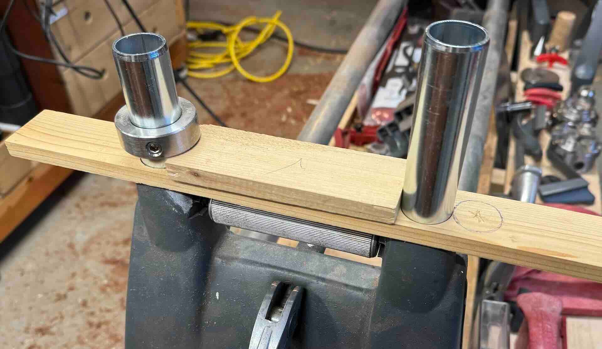

To confirm this, I put the template over the casting and dropped both extension tubes through the template and into the casting. I was gratified they both slid into the casting without resistance. A stop collar was very helpful to keep the tubes from falling down through the casting while I fumbled with the twist knob.

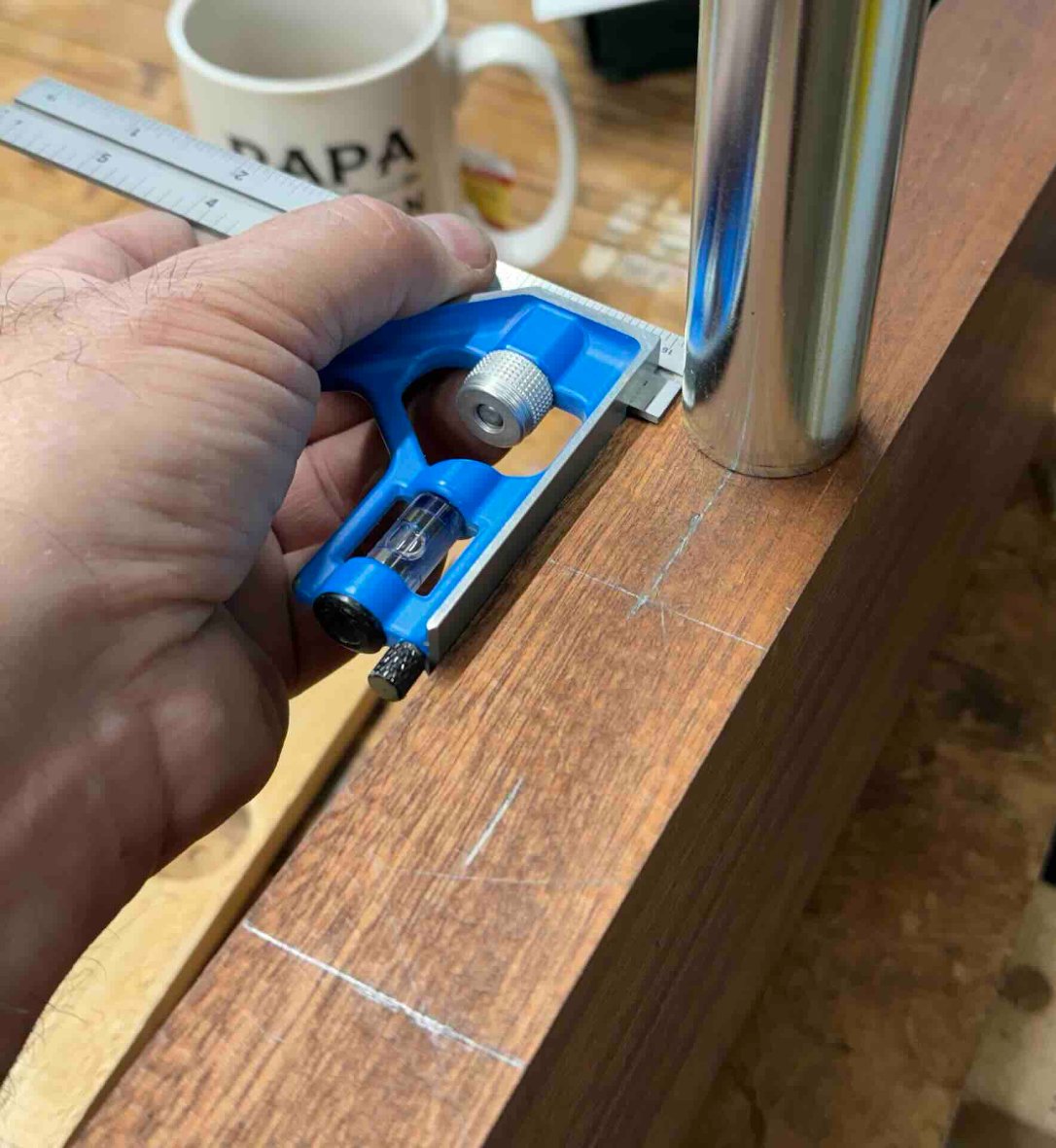

Now the goal is to use the template to transfer the same drill hole positions to the stationary jaw. To do this, I marked the dead center of the jaw blank, and
drew guides lines down the length of the blank to represent the OD of the extension tube, positioning the tube in the middle of the blank.
- MoxonTemplate3.jpg (177.31 KiB) Viewed 60286 times
Looking through the holes in the template, I adjusted its position until the outline of the holes were precisely over the guide lines and then held it down with hot glue.

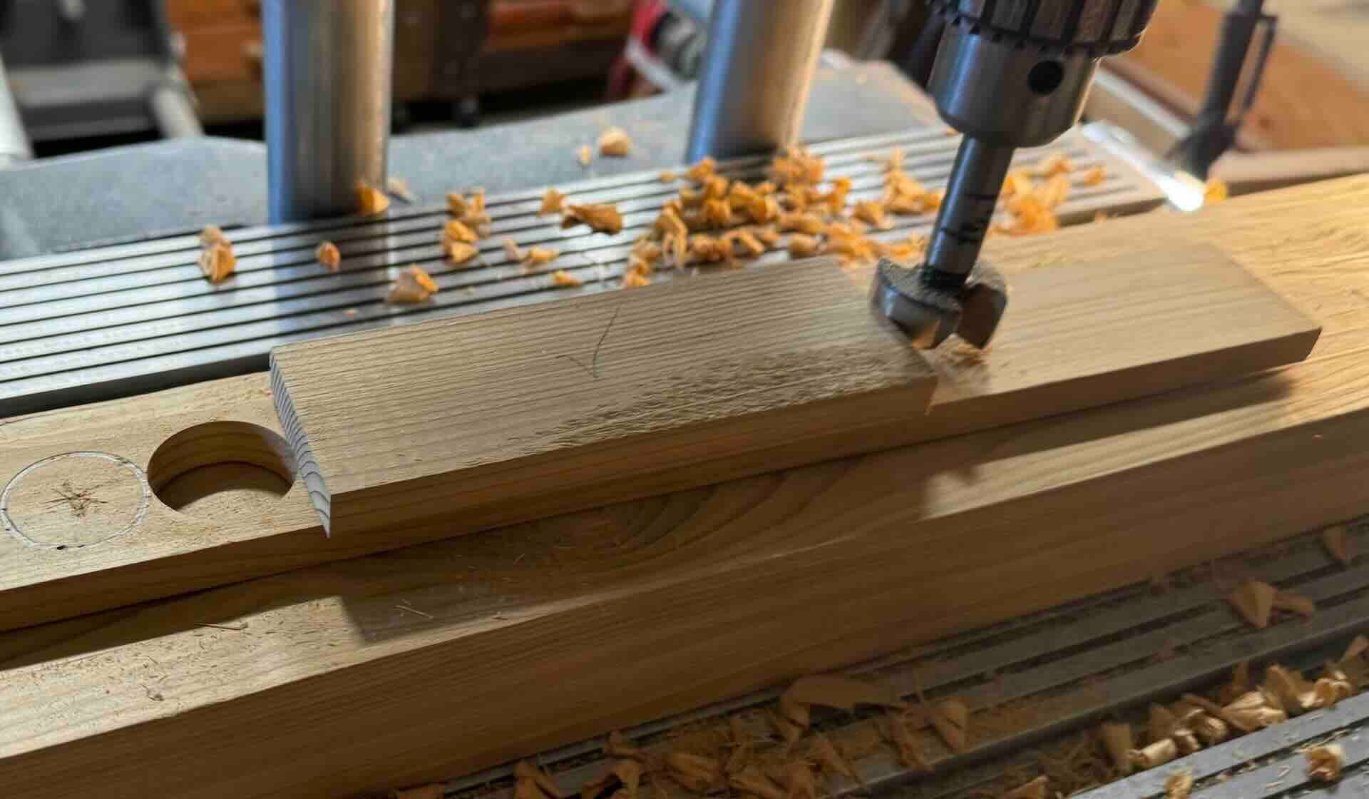

- MoxonTemplate5.jpg (68.86 KiB) Viewed 60286 times

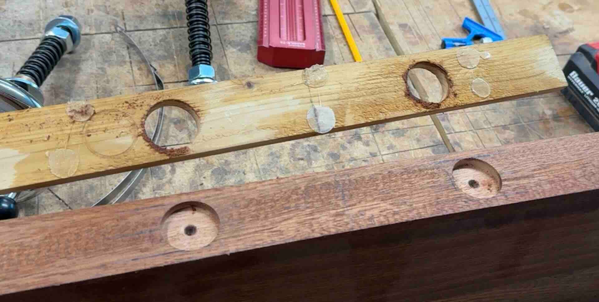

Then I started the 1 and 1/4 inch Forstener holes in the jaw blank with the template glued in place. After each hole was about 1/2" deep, I could remove the template and just deepen the holes to a final 2" depth.
BTW, if you haven't heard of this trick, you can just
spill denatured alcohol on hot glue and it quickly unbonds!!
