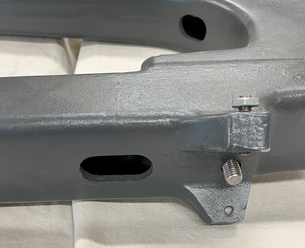

In my first post here I mentioned that the early version of the A-34 Jig Saw has an open Lower Frame Assembly. The picture below is my early A-34 Jig Saw showing the openings in the Lower Frame Assembly and the Upper Frame (arm) as indicated by the arrows. The area under the oval is where the Lower Frame Assembly is open to the Drive Housing area. Because it is open dust and debris can get into the Drive Housing area. I have restored three of these early A-34 Jig Saws (and one waiting) which had dust and debris in the Drive Housing area. For anyone who has the early A-34 Jig Saw I highly recommend sealing the area to the right of the oval in the picture to seal off the Drive Housing area. The Drive Housing area is sealed off from the rest of the Lower Frame Assembly in the later version of the A-34 Jig Saw

By chance does anyone have a source for the slotted-head oval-point leveling set screws? I’ve scoured the internet and can’t find anything close.

Why is slotted a requirement? Hex(allen) 'head' would be easier to find. BTW what is the thread size? I suggest fastenal if not at ace....

Although a slotted set screw is the OEM ones used for the A-34 Jig Saw to adjust it on the Model 10 Headstock a standard hex head set screw is a suitable replacement. Finding a replacement slotted pair would be difficult. I understand wanting to keep the Jig Saw having the original parts as much as possible.
The Jig Saw A-34 Leveling Screw (later part number P 1306) is an Oval End, Slotted Drive set screw 5/16"-18x1-5/16" and has a Jam Nut as seen below.
If being replaced by a Hex Cup End Set Screw, I would recommend "grinding" down the cup end to an oval shape to avoid "digging" into the Headstock.
A 1-5/16" long set screw may be harder to find but you could go with a longer set screw. Don't chose a shorter set screw.

McMaster Carr has cup end ones in 1 1/2" length. Or just use a 5/16-18 hex head bolt with a lock nut. Those should be available locally.
