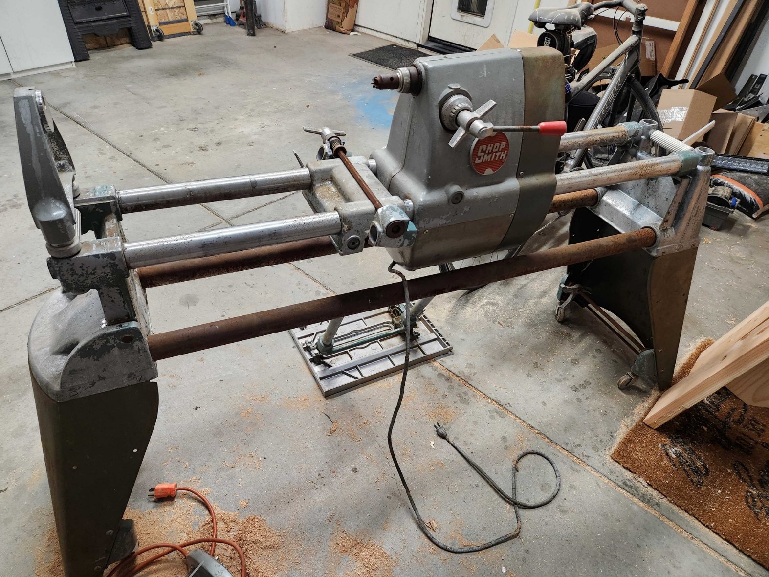

I was given a really rusty Greenie from a man who's father purchased it new in 1953. It was in really sad shape but it was his fathers pride and joy so I promised to restore it and use it. The really nice thing was that it came with a really cool homemade case and a lot of accessories from 1953. Attached are some pictures of what I received.
A little back story about me. My father was given a hand me down Greenie when I was in middle school. I learned to use it properly and by high school was making some pretty nice projects with it. I always wanted one and this was my opportunity.

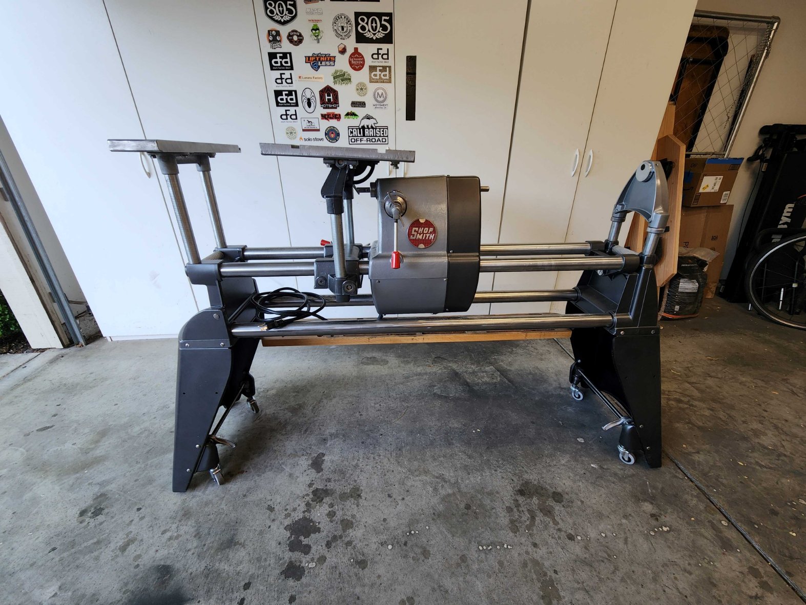

After removing every nut and bolt and replacing all of the bearings and belts, here is what I ended up with. Thank you to everyone here for their posts over the years as I could not have done this without them.

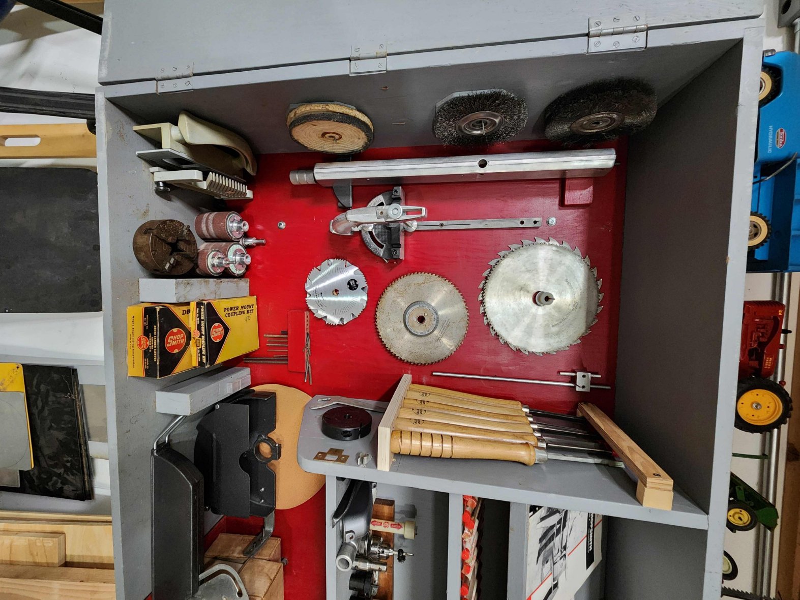

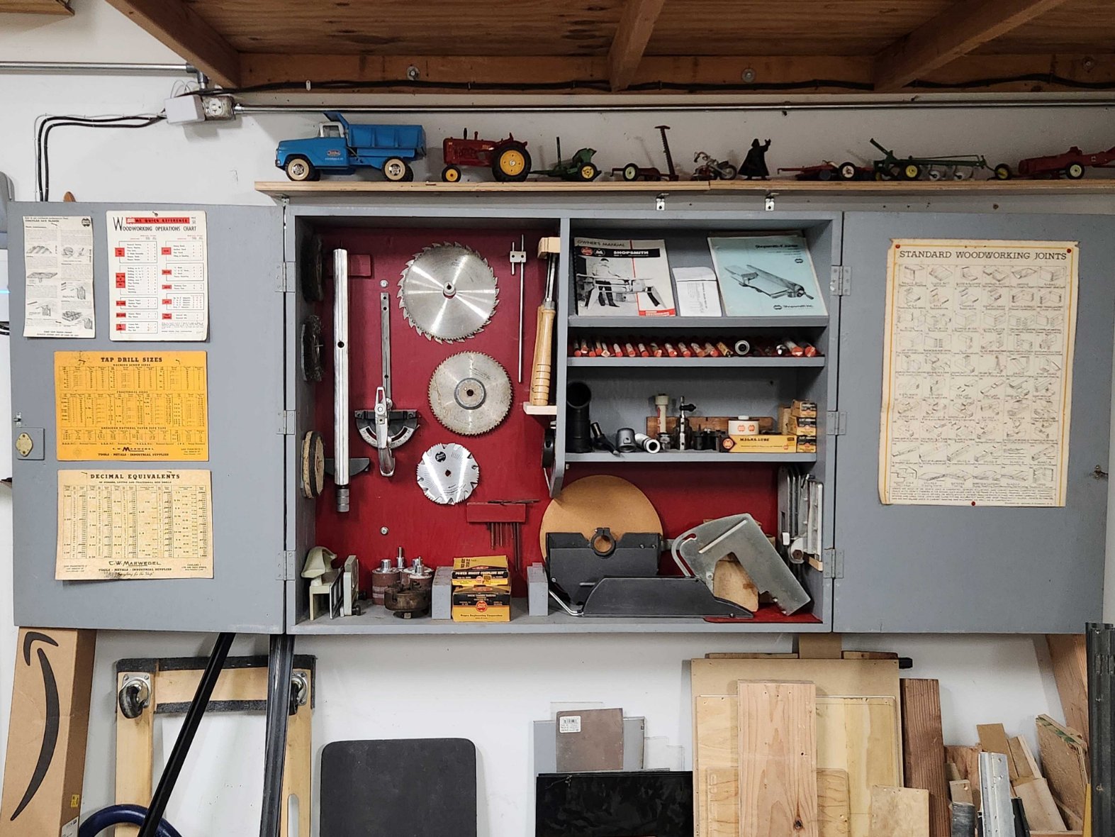

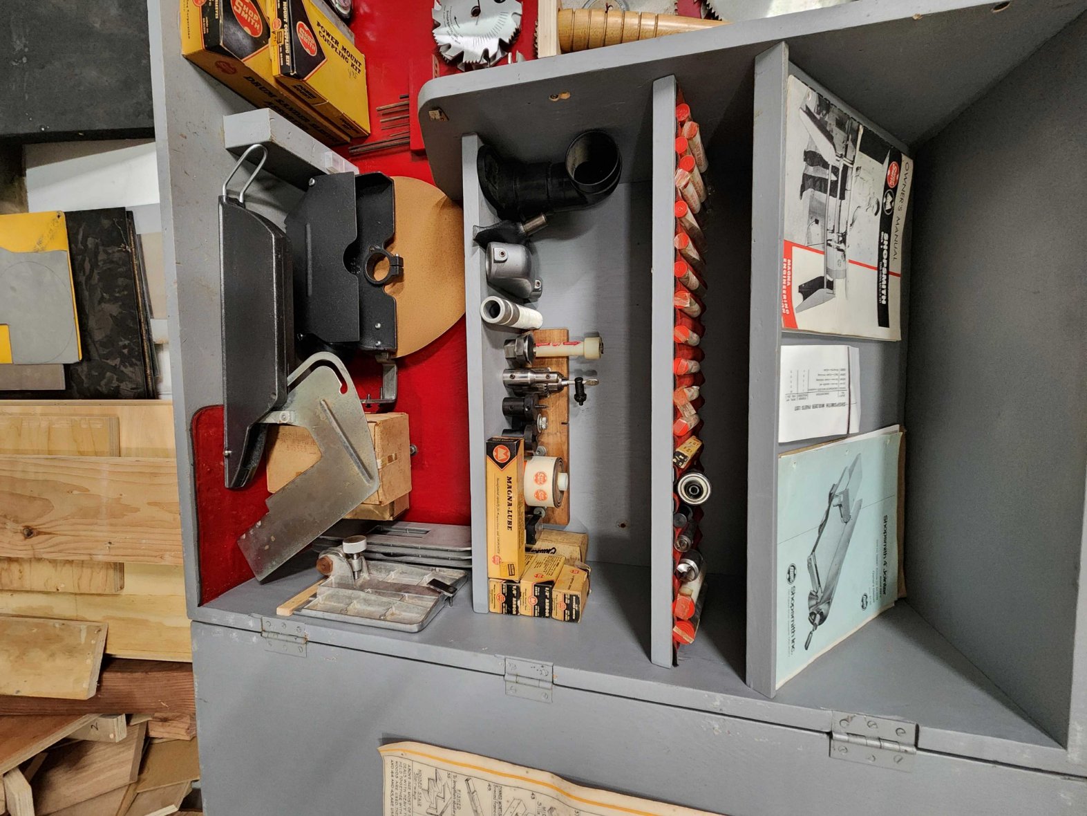

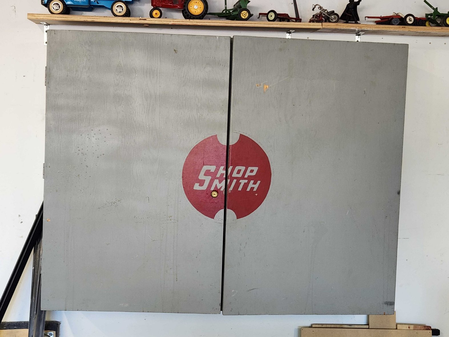

One of the nice things that came with my free Shopsmith was the original owners storage case. See the attached pics.

jpdalton
Posts: 552
Re: Gallery of Restorations
Post by jpdalton »
Kent50 wrote: Wed Jul 30, 2025 10:16 pm One of the nice things that came with my free Shopsmith was the original owners storage case. See the attached pics.
That’s pretty cool!

Kent50,
Your restoration is very well done. It looks great. It is too bad the Carriage was broken. Do save the usable parts from the Carriage as they could come in handy someday or someone else may need them. The Mark 5/V 500 Carriage for the original Table System is no longer made so replacement parts have to be found used.
The cabinet is a real plus to have a place to keep the accessories. I see a few newer accessories in there. The Blade Guard set, Fence Straddler and Power Coupler are some of them. It shows how later parts and accessories are usable on the older Mark 5's.

It is nice to know some history about it. Do you have the serial number for it? I am curious as to when it was made. Something I noticed is it has 6 screws to hold the Belt Cover on the Headstock Casting and Motor Pan. When the Mark 5 was introduced in March of 1954 the Belt Cover had 8 screws holding it on. The number of screws going from 8 to 6 changed in 1955. Shortly after that change the Headstock Casting went from the "A" Casting to the "B" Casting.
Kent50
Posts: 24
Joined: Wed Jun 11, 2025 6:09 pm
Post by Kent50 »
Hello Russ,
Thank you for the compliment. I am looking at the original documentation that came with it and it might very well be a 1955. The serial number is 265359.
