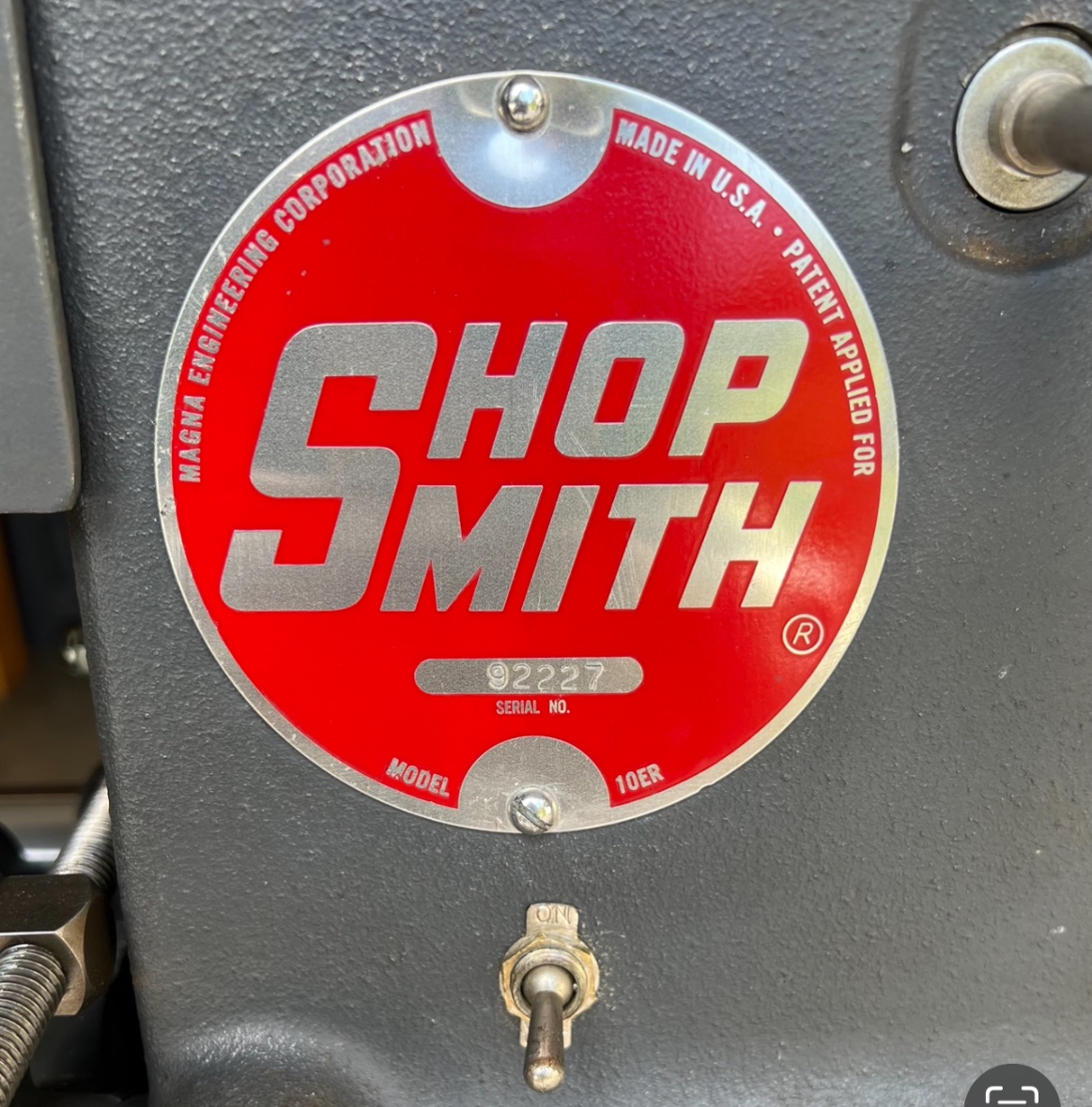

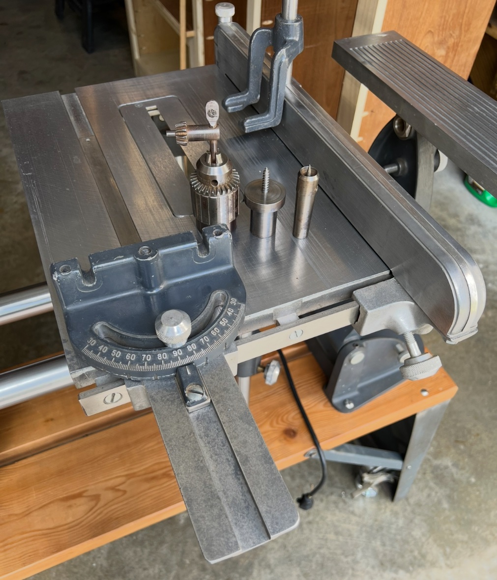

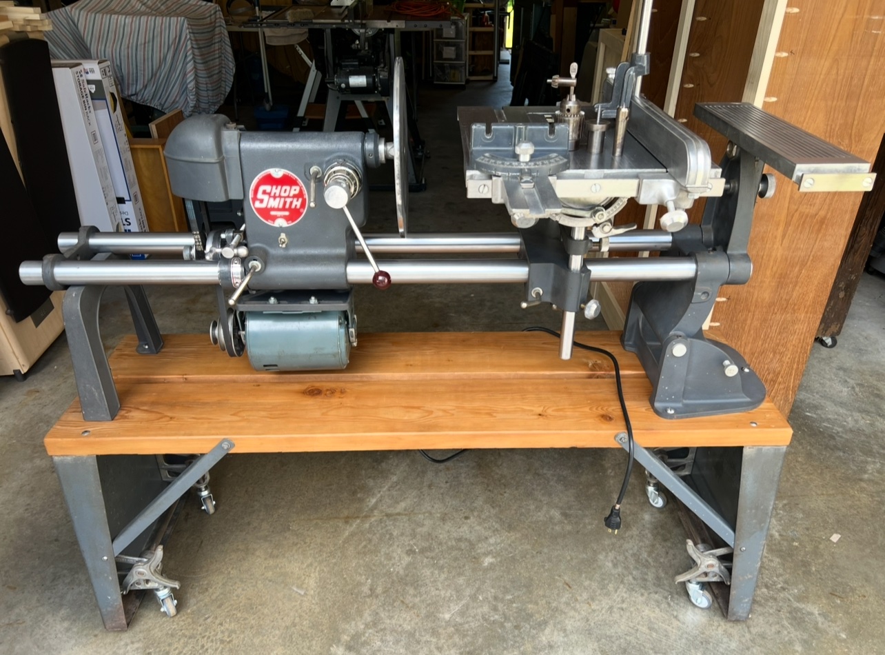

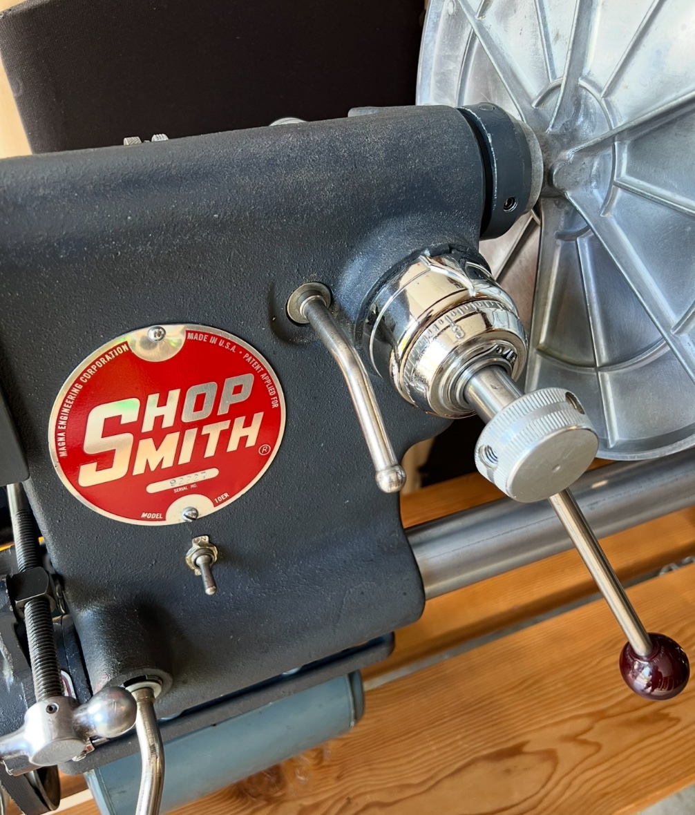

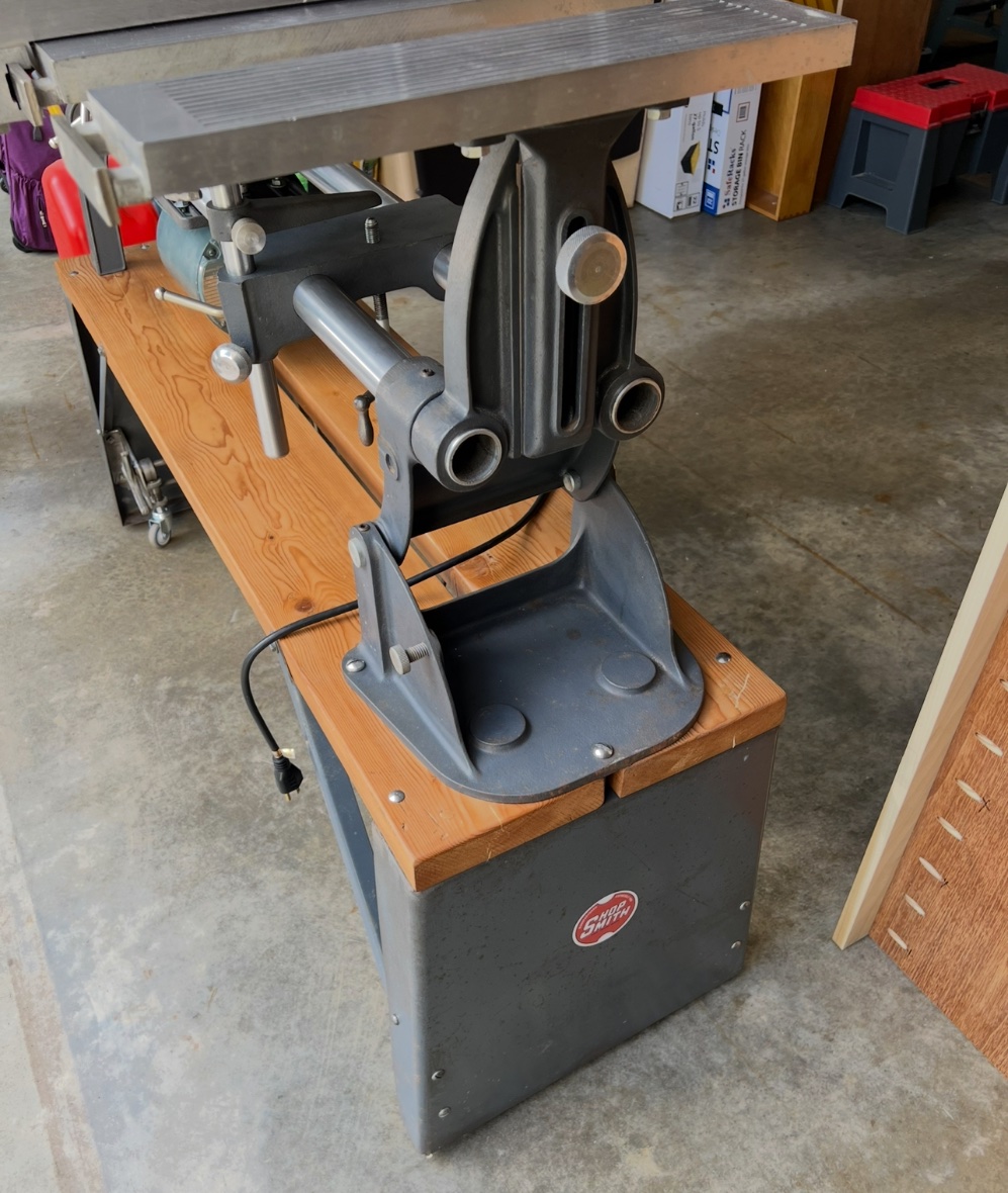

1953 Model 10ER Serial Number 92227
This was a very quick restoration project, due to the fact that the machine was in pretty good shape to start. It had some surface rust on the bench ends to deal with, but minor enough to avoid a paint job even there. Also the plating on the quill depth gauge and spring housing are still in great shape after polishing…

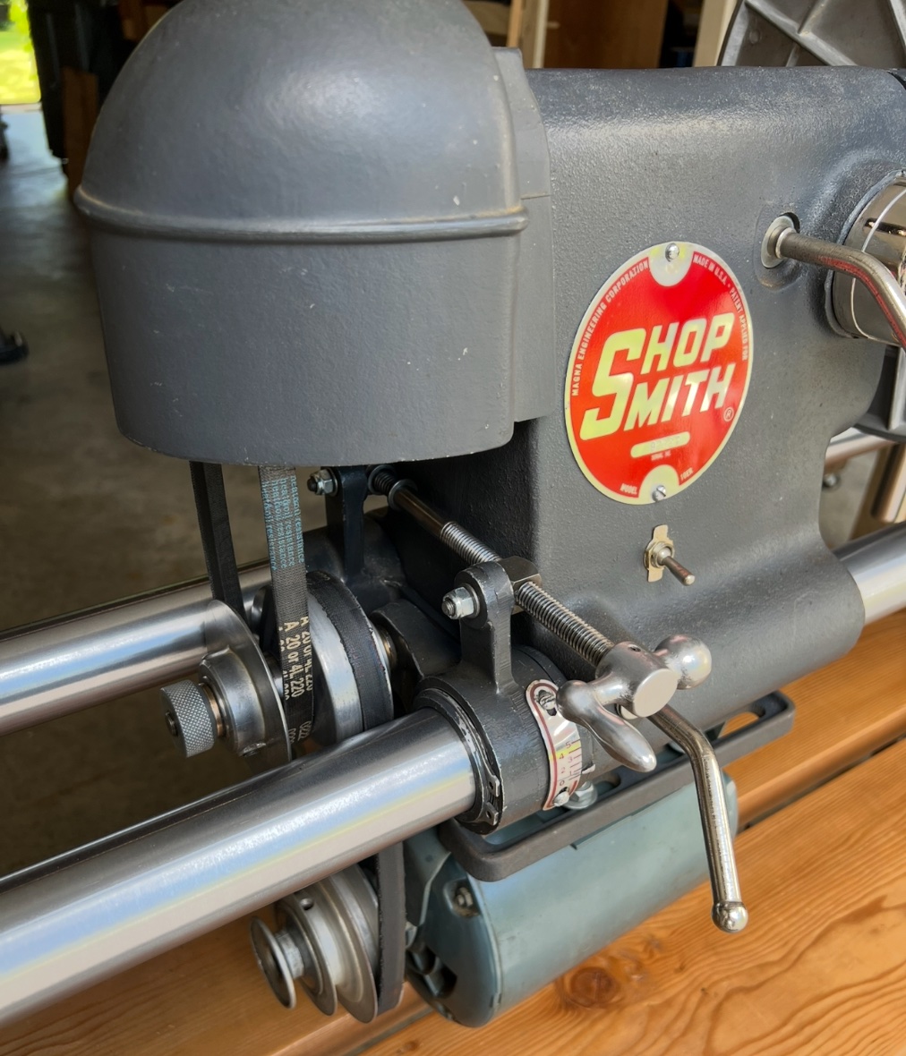

The big upgrade it received was the addition of a speed changer - this is one I picked up on a business trip to Orange County, CA last year. Got it for $75 from a gentleman who used to do a lot of Model 10 restorations, and this was about the last piece he had left. He had been dropping the price for months with no takers!
Anyway, the overall system cleaned up very nicely, and is now looking for a new home in Massachusetts…

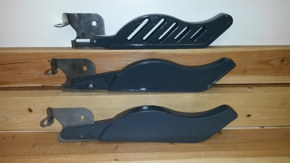

Do I see the thin-walled Way Tubes? Does it have the hollow Table Posts?
I don't see the Upper Saw Blade Guard and was wondering if it has the later plain one seen on the bottom in the picture below.
_
Saw Guards with Splitters r.jpg (79.14 KiB) Viewed 28 times
