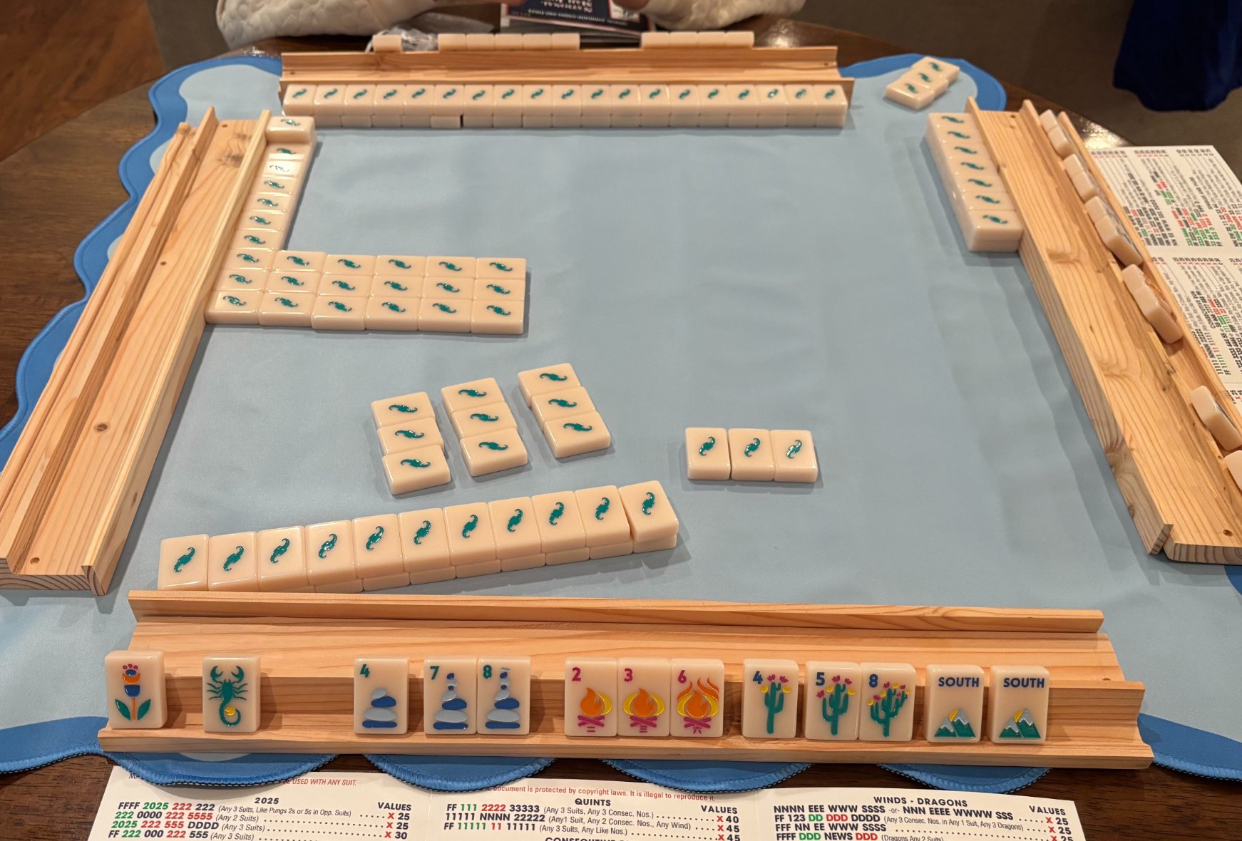

kas20amc02 wrote: Sun Jun 22, 2025 10:56 pm My next idea requires making a 1/4 inch deep dado about 3x1.5 inches square. I want to leave 1/4 inch protruding on each side, like a U shape.
StoneyD wrote: Wed Jun 25, 2025 5:49 pm If it is determined that the original post is regarding a "stop dado", (aka: blind dado) perhaps he could refer to SS self-study guide. In the current edition from the mother ship, in my copy the stop dado is Lesson 4, assignment 21.
StoneyD wrote: Wed Jun 25, 2025 9:55 pm As an owner of a new to me preparing to learn the MK-5 what is impossible about the stop dado as instructed in the self-study guide?
All we have to go on is the OP described "making a 1/4 inch deep dado about 3x1.5 inches square. I want to leave 1/4 inch protruding on each side, like a U shape." Presumably he wanted to do this in the middle of a board. It was suggested by Dwayne on this thread that perhaps the OP meant making a stopped dado cut, which I don't agree with from the OP's (Karl's) description. I don't like stop dado cuts, particularly in a world where routers exist. Too dangerous a cut on a tablesaw IMHO. By the way, the Shopsmith Self Study Guide talks about doing a stop dado in lesson 4 assignment 21, but they actually show how to do this in assignment 20 and then repeat it in assignment 21. They make a stop dado without a dado blade and use the quill to hog out the width of the dado. Stop dado cuts require doing an incomplete crosscut and then shutting the motor off with the workpiece still in position, i.e. straddling the sawblade. It is NOT safe IMHO because with one hand you hold the workpiece and hope for no kickback, you pray that the workpiece doesn't move while you reach down to shut off the motor. Also should point out that the Shopsmith Self Study Guide shows a very dangerous operation that in woodworking in 2025 is widely understood to be a no-no. They are doing a crosscut using the miter gauge with the fence still in place to use as a reference.:eek: To safely do something like this, one would need to use a spacer block of some type attached to the fence before the front edge of the sawblade so that the crosscut position can be set, but then no fence contact to workpiece while the workpiece is engaged with the sawblade. This is near impossible on Shopsmith equipment because the main table depth is so short (compared to a cabinet tablesaw) that a wide crosscut like in the stop dado assignment would be impossible, i.e. the wokrpiece would simultaneously touch the fence spacer block while the cut is being made making a kickback even more likely. Bottomline is there are all kinds of advanced tablesaw operations that one can do if one chooses to do so, but remember the OP is a self described newbie. Also, keep in mind that woodworking tools have advanced in 2025 compared to the 1950's. The OP has a router, so why guide him to a more dangerous tablesaw operation when a router is probably the best choice for what he described? We are just speculating until he chimes back in here on this thread. Remember there are all kinds of nuts on YouTube who do crazy things with a tablesaw just to say/show that they can do it. Someone even cut/shaped a baseball bat with a special jig on a tablesaw to give but one example. Also keep in mind, NOT everything shown by Shopsmith documentation from decades ago is safe, but at that time was perceived safe by those who wrote it. JMO.
I just would prefer that the OP keep all of his fingers and NOT have a dangerous kickback.

kas20amc02
Posts: 36
Joined: Tue Jan 21, 2025 7:58 pm
Re: Dado blade
Post by kas20amc02 »
Hi guys. This seems to have been a lot of confusion from my poor description. I ended up making a U-shape rack with rip cuts, including angled cuts at the ends. This was a mistake as it was MUCH harder than making a V-shape with only two slightly angled cuts. I needed to rout through the middle of the U shape, which ended up making the racks unequal (in all dimensions) to each other with a burr here and there. There was not enough material to rest the router on at this point, even with my double 2x4 jig holding it still and allowing most of the router base something to rest on. I cleaned it up with a LOT of sanding and gave it to my carpenter friend to clean up the last few edges with a chisel (currently, I have no chisels but hope to remedy that soon). Even with all that, I was still happy with the result for a first effort. I learned a lot (including what not to do) and the racks are functional, having already been used.
I certainly think a dado stack would still be very useful. I made a 1.5 inch rip groove cut today with a standard 1/8 inch blade. Took forever but the result was fine.
Many thanks for your help,
Karl

Thanks. So you were trying to describe the recess you wanted to cut in the Mahjong holders? I can see everything from your description now, EXCEPT the "3". The grove looks like about 1.5" across and 1/4" deep but those holders are much longer than 3". Just curious, but glad you got the end result that you wanted.
