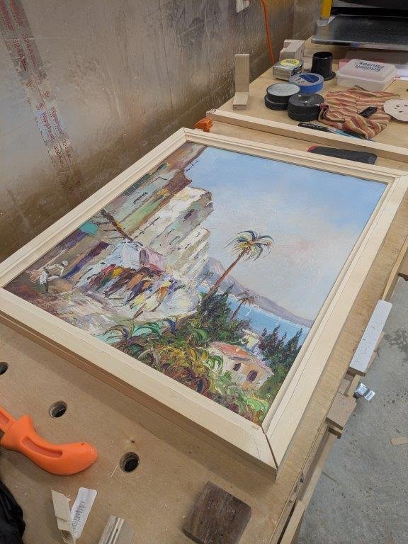

Re: Simple project advice
I've done a few picture frames over the years using just the miter gauge which came with my SS.
As others have said, pay particular attention to getting the very closest to a 45deg as you can. For me, this is done in a few steps.
1) Bandsaw alignment (tilt and fence alignment). I use the bandsaw because its fast and i can get the miter gauge close to 45 alignment before transitioning over to the table saw. Call it coarse alignment.
2) Tablesaw alignment (tilt , straightness etc) following SS prescriptions.
3) Make sure you have a trustable 90 degree standard around.
4) Joint/Plane your pieces, including a bunch of "test" pieces
5) Make a pair of test cuts. Put them together, compare to your known 90 standard.
6) Fine adjust miter gauge until happy.
This alone can take a day in the shop-so be patient.
Here's the frame I'm working on currently.
Heres a closeup of the routed edge .
As the picture is very thick (1" iir) I am stacking a near 1" thick base frame with simple 45 degree miters. On top of this will be attached my routed "pretty edge" which extends and overlaps the painting itself a little. The pretty piece needs a minor recess to accommodate the painting thickness.
b
b

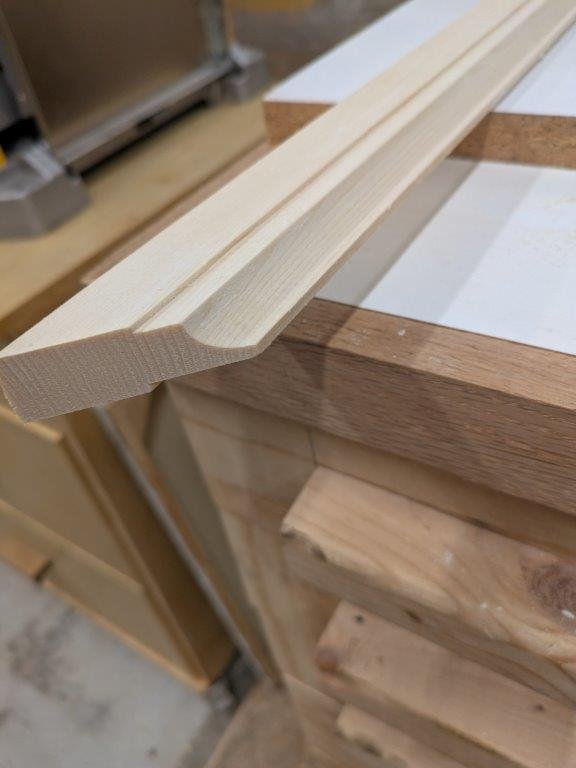

That is a nicely shaped piece of molding. Is it white pine or sugar pine? I would be interested in hearing what the sequence of operations was that you went through to get that shape. Hope you will also post some photos of the end result so we can see how the molding is finished.
Idaho Panhandle
Idaho Panhandle
Thanks for being interested Ed !
I don't know what type of wood, it was a 2x4 I had in my attic for 2 years. Some kind of pine from HomeDepot.
To make the decorative edge is pretty easy.
I made 2 passes on the tablesaw at the blade width and 3/4 depth (non thru cut). This skimmed the 2 edges creating a tongue.
Then I used a 1/2 Whiteside Cove Bit #1804 on the narrowed edge with an offset to produce a 1/8" step.
I probably should sketch this.
