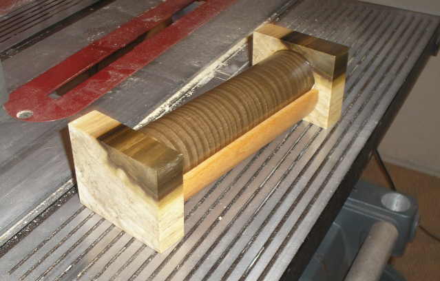

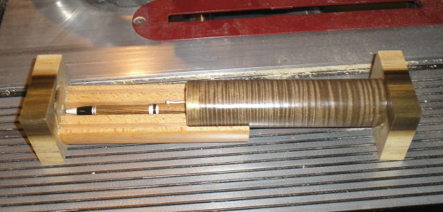

I did an experiment on making my own curved laminate. That's 4 layers of figured maple veneer, which were wrapped around an old Mark V Quill! Being forced around a curve seemed to make the veneers avoid their typical "bubbly" behaviors.
Only problem was despite wax & waxpaper, I got an iron stain during the gluing, so I deliberately stained the maple very dark to disguise it.
Then... the base of the pen holder is a bandsawn & kerfed old Oak Rolling Pin. The two sides of the contraption are some spalted poplar which I found on a store trash bin nearby here.
You can just look at a Mark V, and these projects come flying off it....
Closed position.jpg (33.27 KiB) Viewed 2878 times
Open Position.jpg (41.19 KiB) Viewed 2945 times

The more that I thought about this project of yours, the more that I tried to figure how you clamped the laminated parts to glue-up around the quill. Care to share?:confused:

Really not much to my "clamping"... I had enough veneer to wrap the 4 layers & white-glue about 3/4-way around the old quill's circumference. Basically on the floor I laid them out, inside a final wrap of wax-paper, and rolled it all up as tight as I could. Then I wrapped the bundle with velcro-tape and set it aside 36 hours (resisting the temptation to open it up and look at the progress!).
Once it came out, I bandsawed to about a half-round section, getting rid of mismatched veneer-layer edges, and "jointed" the edges square with a few manual passes across a stationary 12" sanding disk. After all that, I chose the correct corresponding circle-cuts for my end-pieces.
Today I further put a pair of rare-earth magnets to hold the thing shut tight.

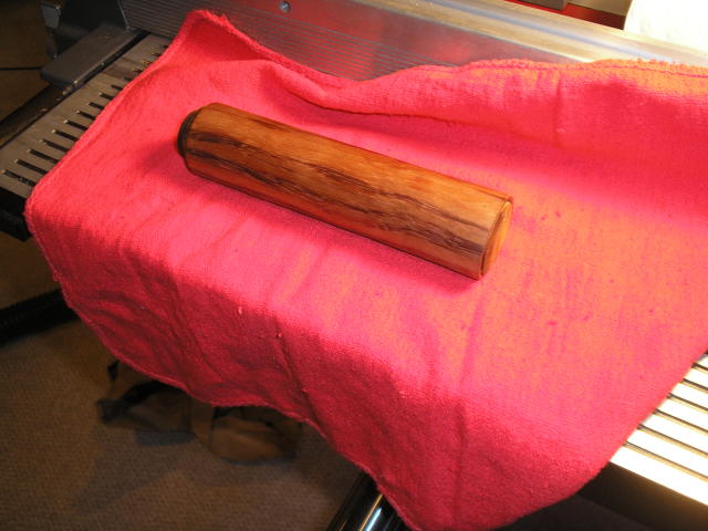

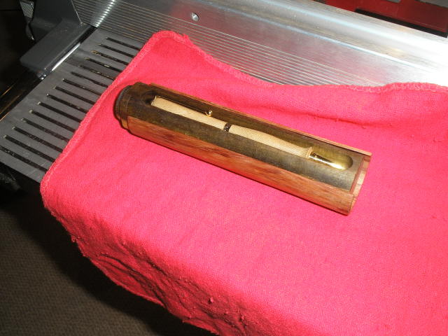

I tried my hand at another pen-holder, this time wrapping 5 layers of thin Bubinga veneer around a PVC-tube for for my curved-shell glue-up. Then I used the OPR to make a stopped groove in a piece of poplar, which I subsequently turned on the lathe. Here you see them working together to make a pen holder.... I had a disaster when bandsawing the thin veneer shell, so I had to epoxy it back together before finishing. Hey, it's better than sitting on the couch!
Closed Bubinga Tube.jpg (47.85 KiB) Viewed 2803 times
Open Bubinga Tube.jpg (54.95 KiB) Viewed 2802 times
