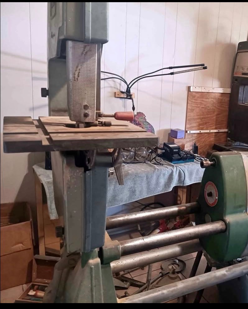

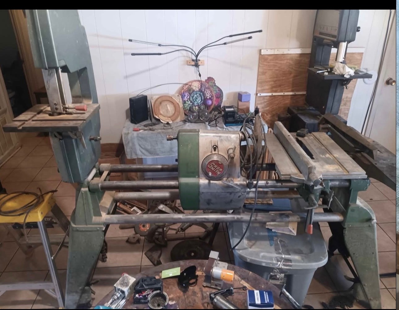

Hi everyone. I would like to add a bandsaw to my Shopsmith. I can’t find any newer models for sale in my area but I did find this really old one. Is it worth buying?

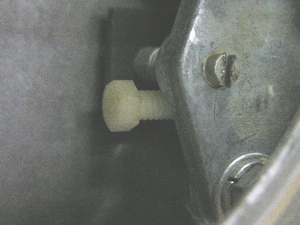

As for the Greenie Bandsaw in the pictures, it is a good Bandsaw like all years the Bandsaw has been made beginning in 1955. That said, it has the Cast Iron Table as opposed to the newer Aluminum Table. Both have their pluses and minuses. Unless upgraded it would have the old Roller Guides in the upper and lower Guide assemblies and the auto tracking roller. These are in need of very regular attention to cleaning and lubrication. It can be upgraded to the new guide bearings. Age may require replacing the tires on the upper and lower wheels. There have been other changes to the Bandsaw over the years. One was the addition of a nylon screw added to the Guide Column Bracket as show below. It helps with stabilizing the Upper Guide Assembly.

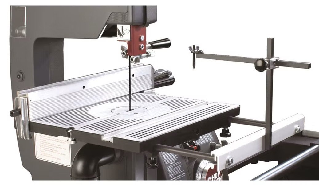

There have been several changes/improvements to the cover over the years which include a dust collection port and the addition of a window and slot for adjusting the blade tension without removing the cover. The Aluminum Table has a Fence option along with a Table Extension option and a circle cutter guide. For the Cast Iron Table the Mark V 500 Miter can be used as a Fence.
You did not say the asking price and it is a bit hard to tell from just a couple pictures its true condition. Both the upper and lower Wheels should turn freely and smoothly. If not the bearing in the lower Wheel may need replacing. The upper Wheel has needle bearings that need periodic lubricating (grease) and if worn or damaged the upper Wheel may need replacing. You could spend more money bringing it to a better condition than getting one already to use in good operating condition. As an example, I have a 1998 Bandsaw which has the Aluminum Table ready to sell. I would sell it for $200 which is comparable to ones found at times here in the Northwest.

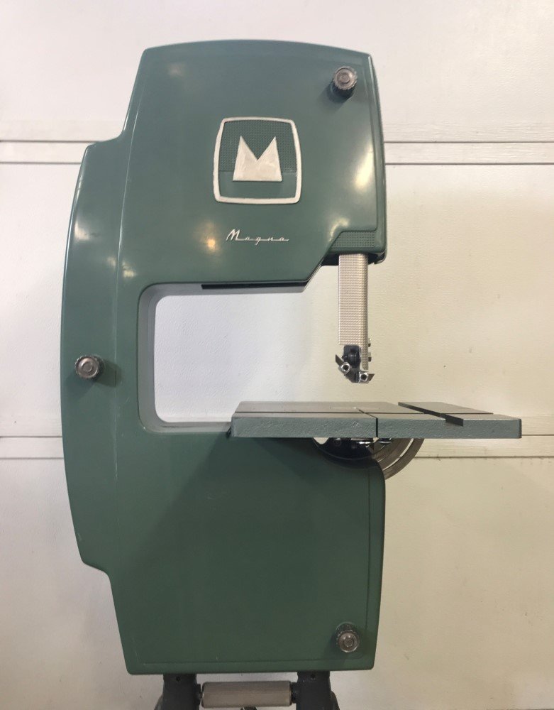

One of my Magna/Shopsmith Bandsaws is a 1956 Greenie I restored to original condition. It runs as well as my main Bandsaw with the Aluminum Table and the current upgrades.

The Aluminum Table is larger than the Cast Iron Table. Being so it can interfere with raising to the Drill Press position when mounted on standard Eccentric Mounting Posts. Without the Fence Bar on an Aluminum Table, you may be able to raise into Drill Press position, I have done it. With the Fence rail you cannot. An older Bandsaw with Straight Mounting Posts and an upgraded Aluminum table would interfere with raising the mark V into Drill Press position. There is a set of Mounting Tubes (shown below) that have a wider offset to allow the Mark V to be raised into Drill Press position without removing the Bandsaw.

As for you question about the Circle Cutter it works alright. It attaches to the Table Extension so that is needed also.
