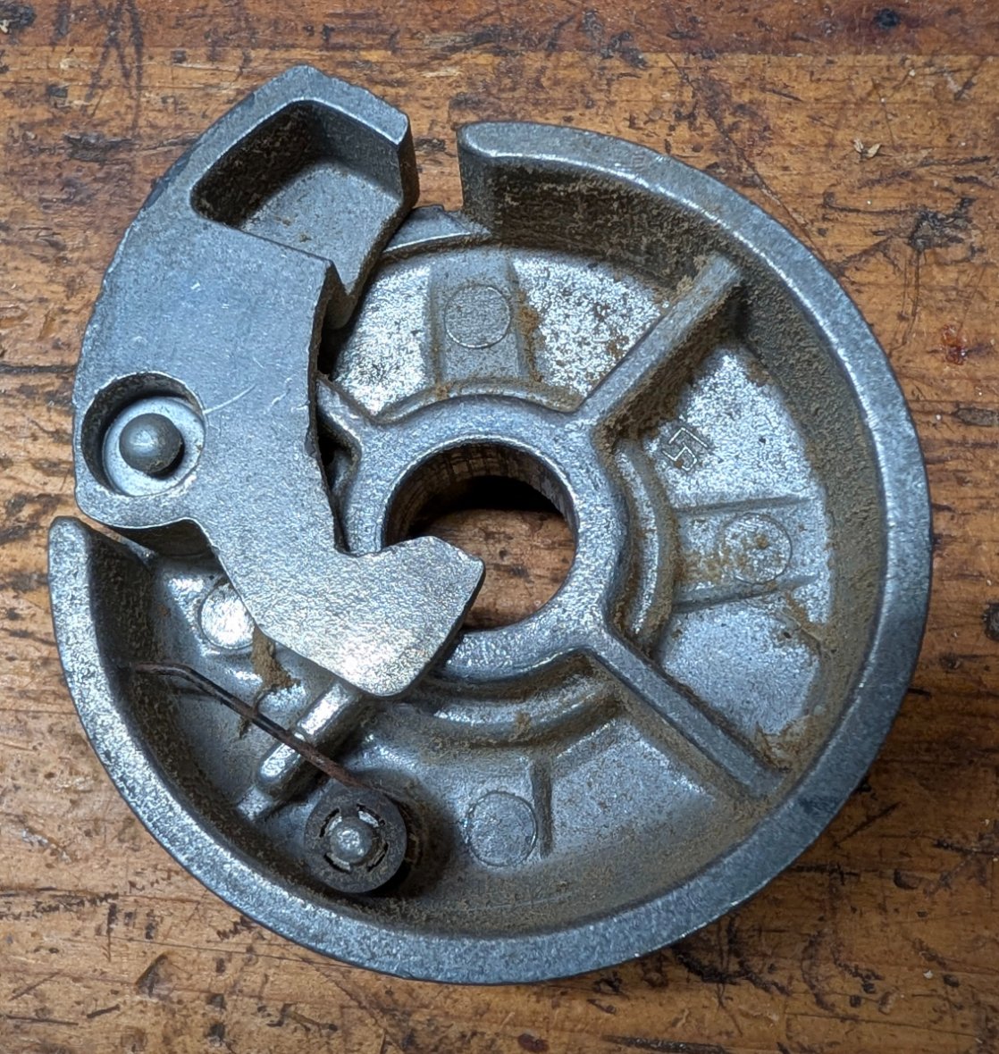

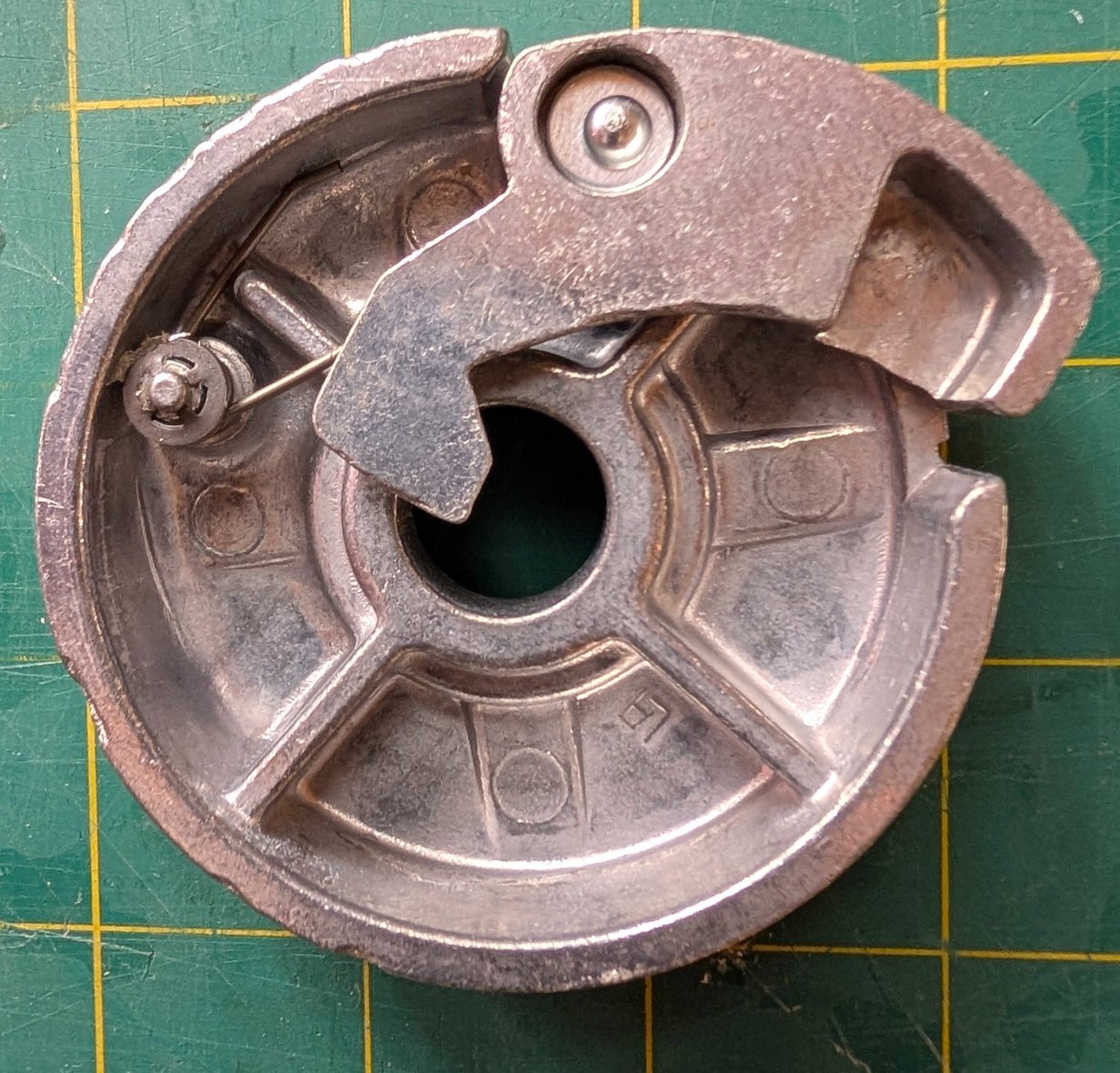

Arrived today. The only problem was the spring. Mine was rusted an broken. Photos of both attached. Now I have to install and see if that is the only problem.

The picture shows why the individual parts are not sold separately.
Thanks for posting it. The upper picture clearly shows the broken spring and the second picture shows how the spring should look.
