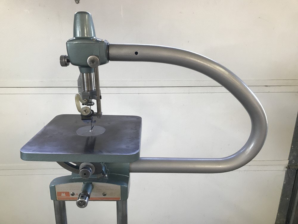

You can see the mounting hole near the top of the Arm on the Greenie Jig Saw below.

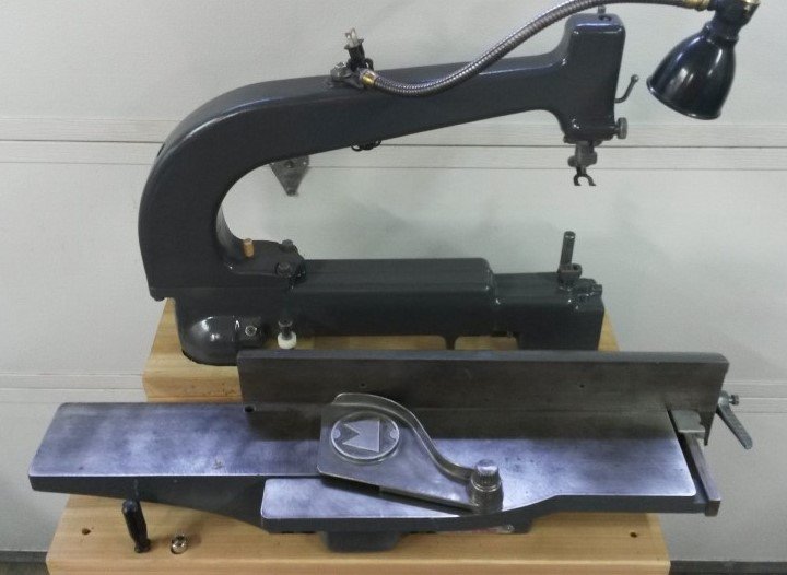

I have seen other lamps mounted on Shopsmith/Magna tools that were not made by Shopsmith/Magna. Below is a rather famous one.
