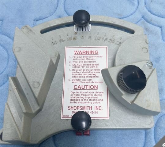

Does anyone have the instruction sheet for the Shopsmith sharpening guide? I purchased one on Ebay but it didn't come with the instruction sheet.
Thanks in advance!

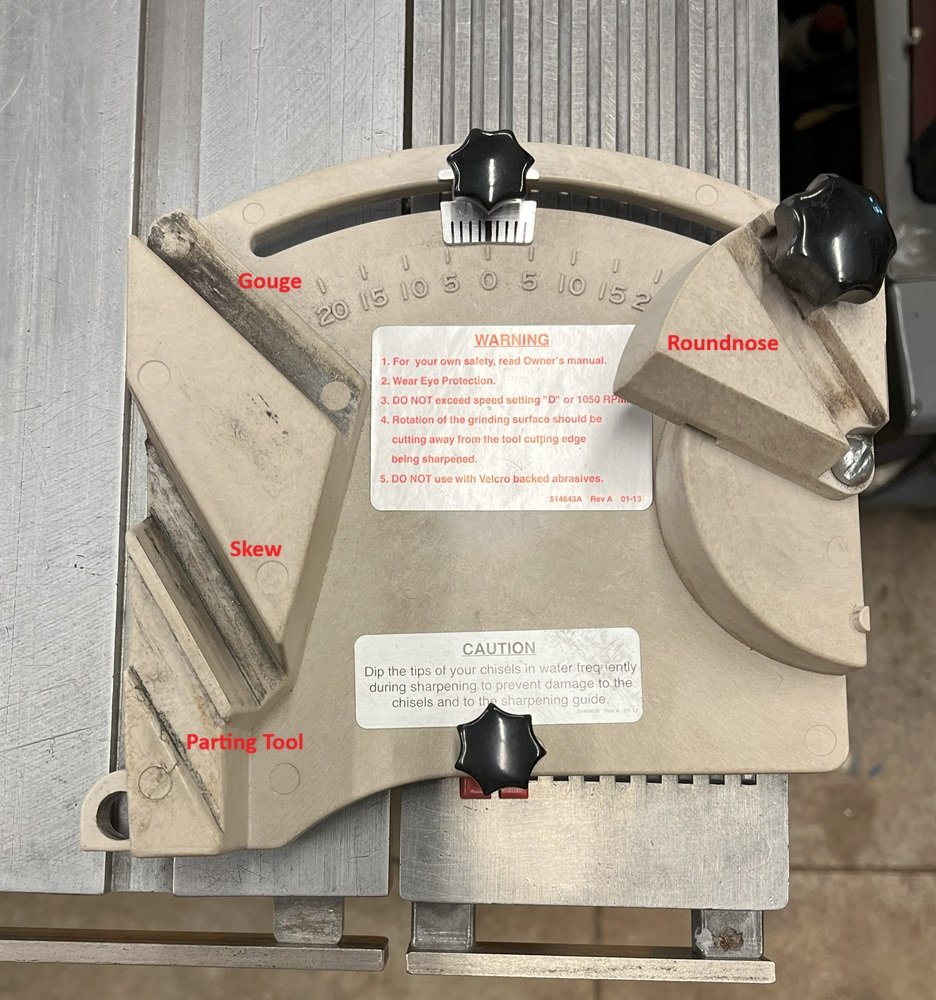

The Angle Adjustment on the Sharpening Guide is to change the Chisels to do more of a shearing going to the left or more of a scraping going to the right. If I remember it correctly Chisels come at 0 from the factory. Use caution not to overheat the Chisels during sharpening.
The picture of the Guide below is labeled for the different spots to sharpen the different Chisels. The Gouges are "rolled" back and forth against the Sanding paper to get it sharp edge to edge. The Skew is set into the slot against each of the sides to sharpen both surfaces. Sharpen both surfaces evenly. The Parting Tool is sharpened by laying it in the slot to do one face then turning it over to do the other face. Again, sharpen both surfaces evenly. The Roundnose is clamped into the holder and moved back and forth to sharpen. Sharpening the Roundnose Chisel does change the factory angle but the new angle is preferred.
