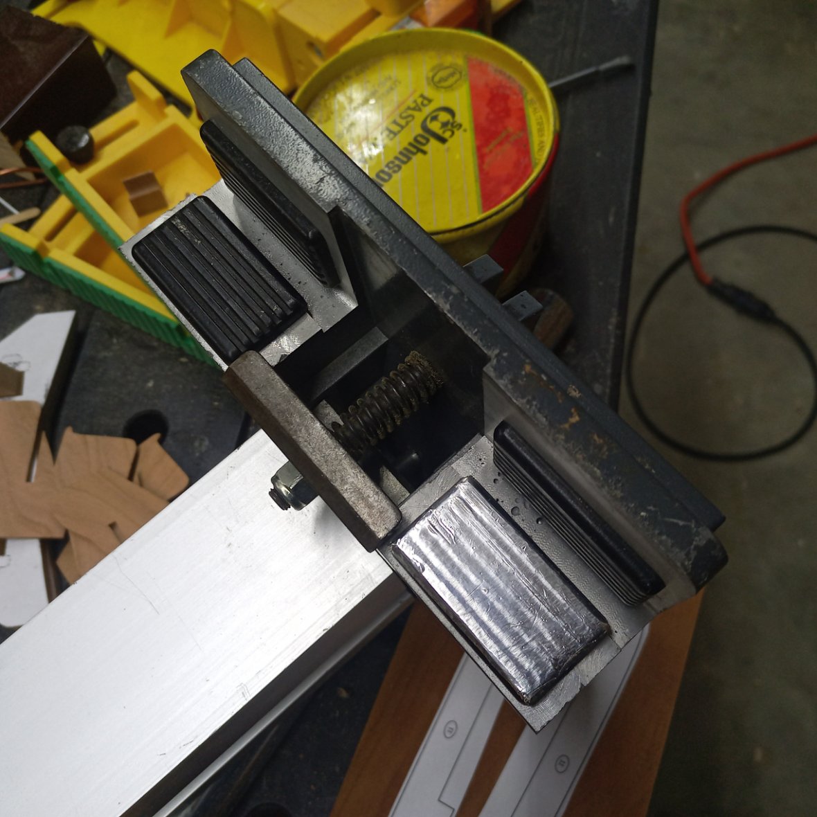

I was able to get the fence square by applying several layers of blue tape to the right pad. It is not a permanent fix, but it is a proof of concept. I have some aluminum tape coming that I am going to try for a more permanent fix.
While applying the tape and testing for square, I discovered that my fence sides are bowed in slightly in the center on both sides of the t-slot. Is this normal?

The pads are on the main casting. They are not shown in the parts breakdown; they are not shown, so I assume they are part of 518419 (217). There are photos of the other fence with the pad extended on my growth rings.
My fence is straight along the bottom edge. All I had ever done with it was rip it until now; otherwise, I would never have noticed it. My jig was made to ride on the fence and was not square to the table. While troubleshooting this, I found the problem was not with my jig; it was with my fence.

I squared my fence to the table by using layers of aluminum tape on the low pad. This makes it usable for 99.9% of my needs. If I locate a fence in excellent condition, I may buy a new fence. So far, I have not found one I like. I'm not going to buy one that is dinged up, and for sure not one that has been hit with the saw blade. I emailed Shopsmith support a few days ago about parts availability for the fence and received an email asking which parts I needed. I sent them the extrusion part number, but I haven't heard back.
Shopsmith 520 Rip Fence Shimmed With Aluminum Tape

None of this has any noticeable effect on ripping. I discovered the problem when I made a jig that straddled the fence and had two problems. The jig slid perfectly down the first few inches of the fence, but became progressively tighter as I pushed it toward the back of the fence. While I was troubleshooting this issue, I discovered that the jig was square to the table when sitting on the table, but not square when on the fence. I checked the fence, and it was not square to the table. When I checked the pads on the fence, one was higher than the other. Both pads are tightly seated. It took several layers of aluminum tape to get the fence square to the table, but this does not fix the dent.
My conclusion is that the previous owner either dropped the fence or damaged it in some other way I can't imagine. There is a very slight dent in the fence along with a tiny twist. I checked the fence again using my Starrett straight edge because, while writing this, it occurred to me that I had not checked for the dent on both sides. The dent is on both sides and a bit more on one side than the other. It is as if the previous owner clamped something tight on the fence to bend it like that.
So what do? Forget fence-straddling jigs for now. Keep an eye out for a used fence in excellent condition, and hope Shopsmith comes through with parts.
