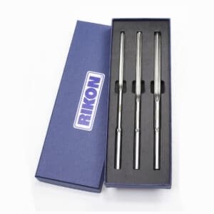

Thanks for the info Jim. After posting I went shopping and bought these from Rikon. Buy once, cry once. The second photo are the bowl gouges.
